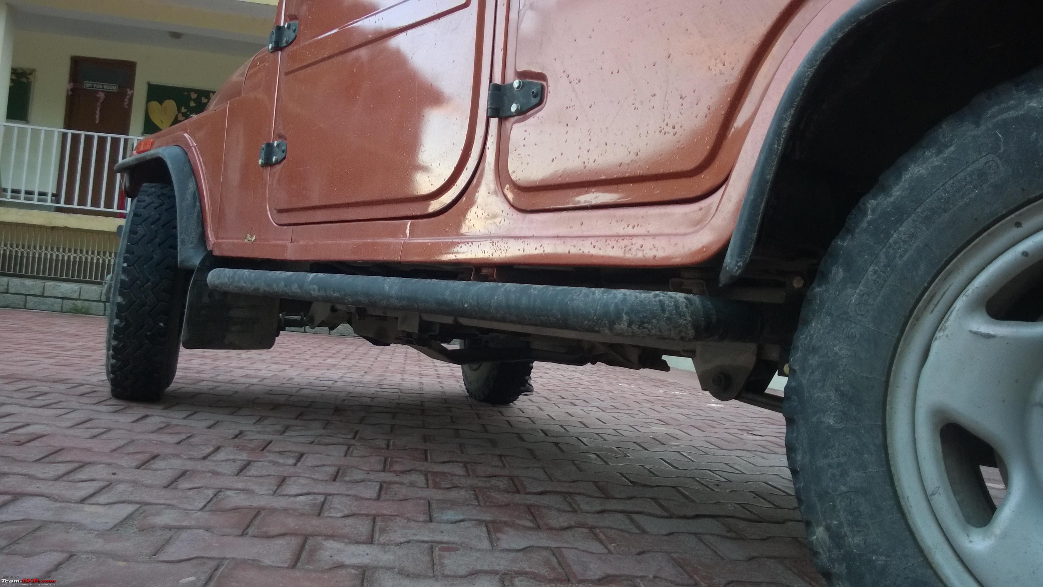

Having fitted the fender flares / side marker lamps and finally gotten around to fabricating the front bumper and rock guards (side steps, as far as a pleased wife is concerned), the basic exterior renovations are just about finished up.
Will note that I was shocked to see the new Maruti & Chevrolet colors this year of almost identical color (perhaps bit more appealingly glowing, even) - that would've saved me a whole lot of time / trouble vs. the custom mix I resorted to.
I purchased the steel pipe and bends, then cut/ welded/ painted/ mounted these up myself, the basic idea being (as with the rest of the car) to keep it simple, strong, and functional, with a minimal number of components comprising the assemblies.
Bumper tubing measures 1-3/4" dia., the top & bottom connected with two beefy pieces of C-channel welded between. Not likely as stout as a Prad unit, but pretty substantial vs. the extremely flimsy original. Side steps are 2-1/4" and clamped directly to the frame. All fasteners are 12mm fine-thread machine-grade bolts.
Total cost incl. what I paid for the use of shop & equipment worked out to something under Rs2,500, which I think is reasonable considering our location and available alternatives.

Originally Posted by Timson View Post
Looks like your gearbox cross-member has taken a bad bearing and deformed!
Assuming you meant "beating" and in that case, it's more likely been a great number them!
Though it wasn't mentioned on my to-do list, I'm planning to redesign it to gain an inch or two of ground clearance - perhaps complete removal in favor of a piece of inverted heavy-gauge 4" c-channel and/or the newer-style low-profile rubber trans mount would do the trick. Have thought of a few other ideas, too. I don't do hard-core offroad, but these low hanging bits are what get me hung up when the snow gets deeper.
Other thing hanging lower than I'd like mid-chassis is the transfer case - the photo shows that it's mounted more diagonally than horizontally - not sure the reason for this (floorpan clearance?), since the front driveshaft hardly runs at any angle - but am thinking to re-do the mounting holes in the adapter to allow me to rotate it clockwise (from the front) several degrees and get the low-hanging and vulnerable part of it up a couple inches.
Newer Bolero 4x4's using this Borg-Warner TC have a skid plate on the bottom, which would help with rocks, but it's no advantage in snow and I'm thinking it doesn't really need to hang that low in the first place.
Any comments appreciated, if any of the Jeep guys out there have fooled with crossmember mods.
-Eric
