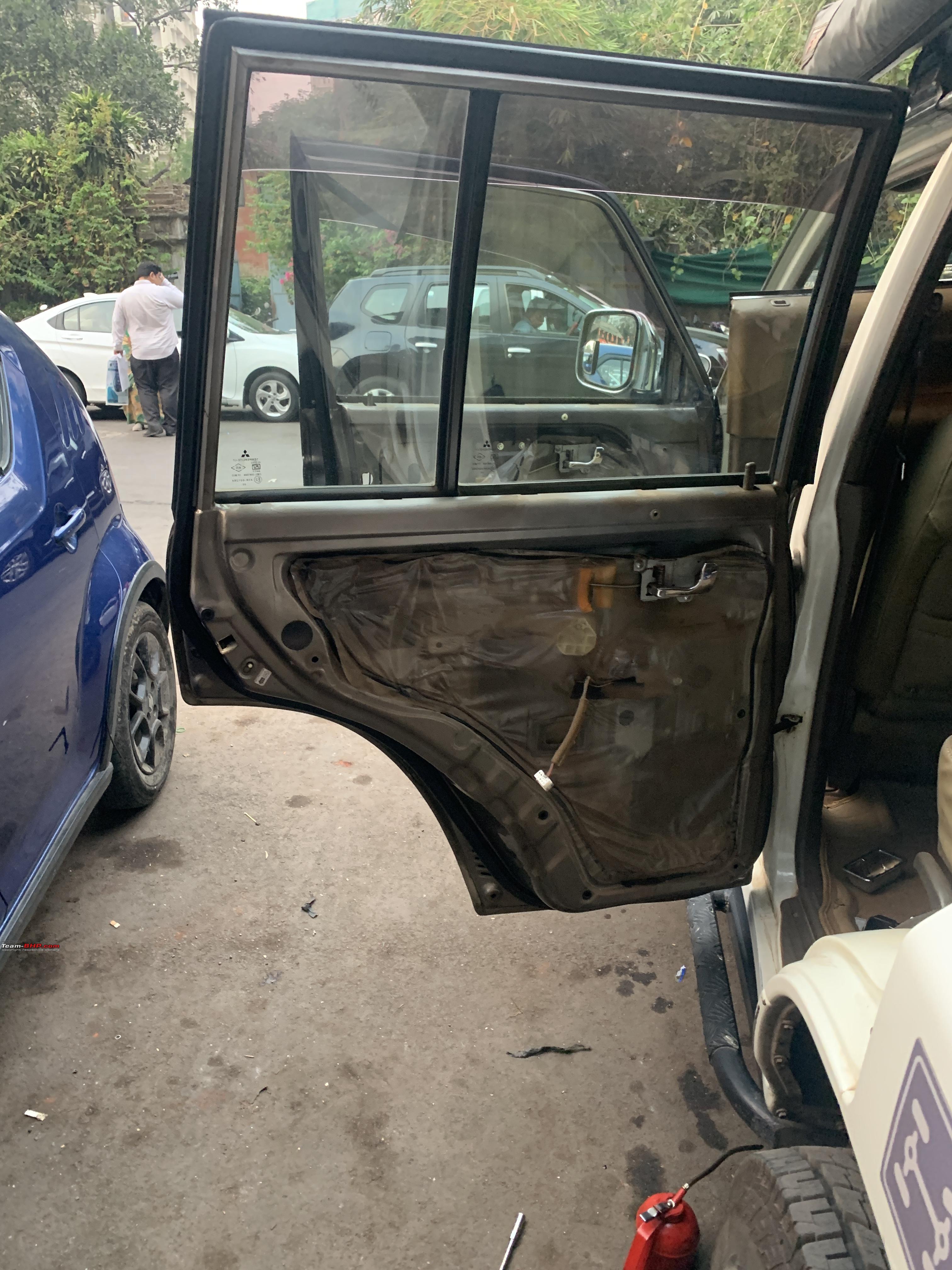

The problem with the SFX are it's handles.
Made of plastic. The car auto locks a few seconds after starting (even if standstill) and if some one pulls the handle hard, it breaks.
I was lucky that few years ago when aliexpress was shipping to India, I had ordered a set of 4 handles because I had same issue in past.
The local mechanic modified the handles mechanism a bit to fit the same side (twice the left side ones broke).
Now wondering, what I'll do next time it breaks since Aliexpress doesn't ship.
The cost of 4 handles shipped form AE is cheaper than one handle available here. Both are same quality.
