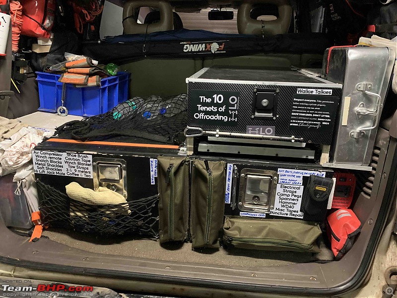

Stowed away inside. The slight lip of the L section prevents the table from sliding in the front.
Remember I had made this, well it was eating away too much space (for larger bags to fit) and I needed a smaller solution. Optimized storage and amount of stuff I carried and managed to fit everything in the lower drawers and discarded the top unit.
As most are aware, I run a training school called Learn Offroad. For that I need to carry other stuff like magnetic signs for vehicles, walkie talkies, exam boards for indemnity, etc and needed a custom storage for that. So fabricated a small box for it.

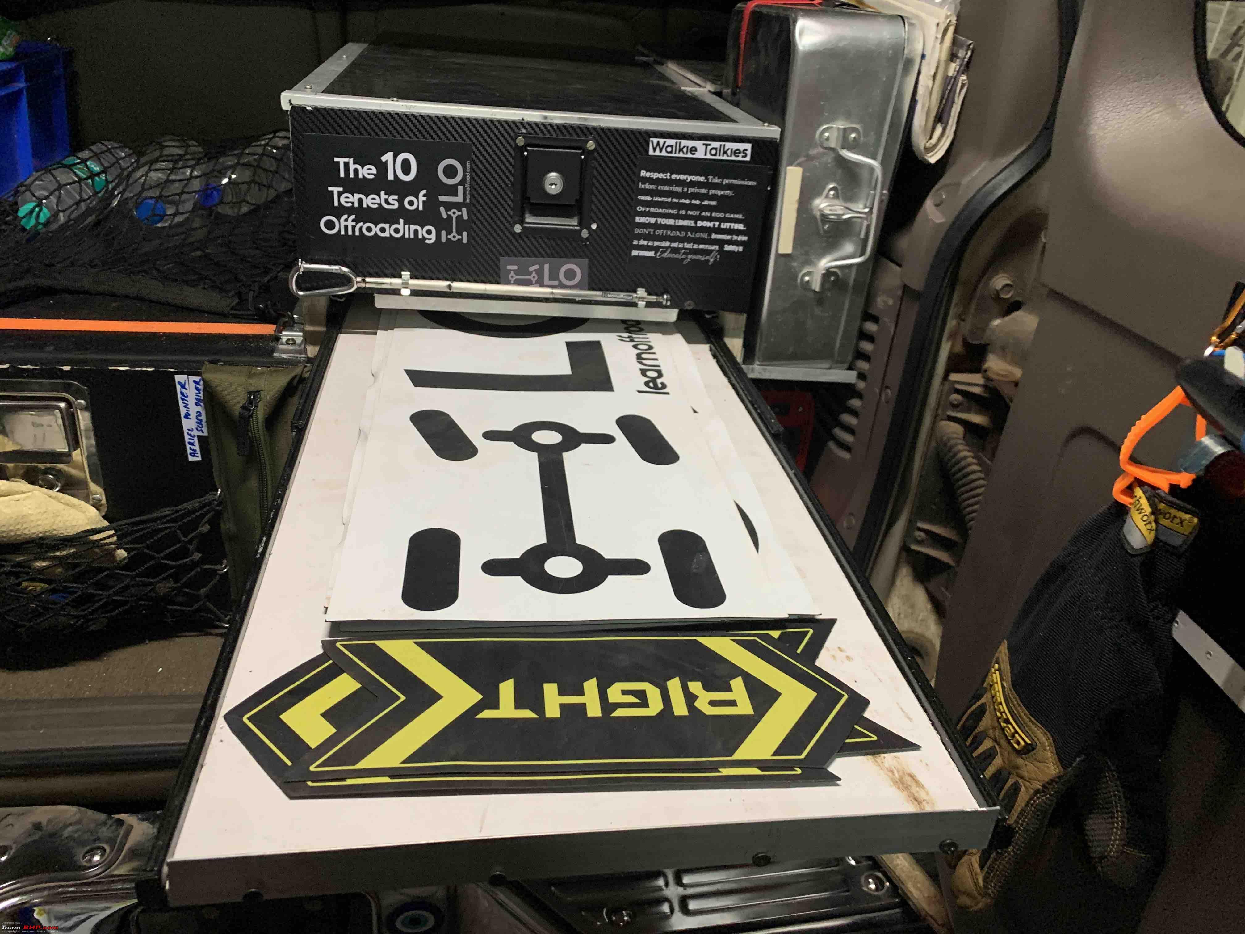

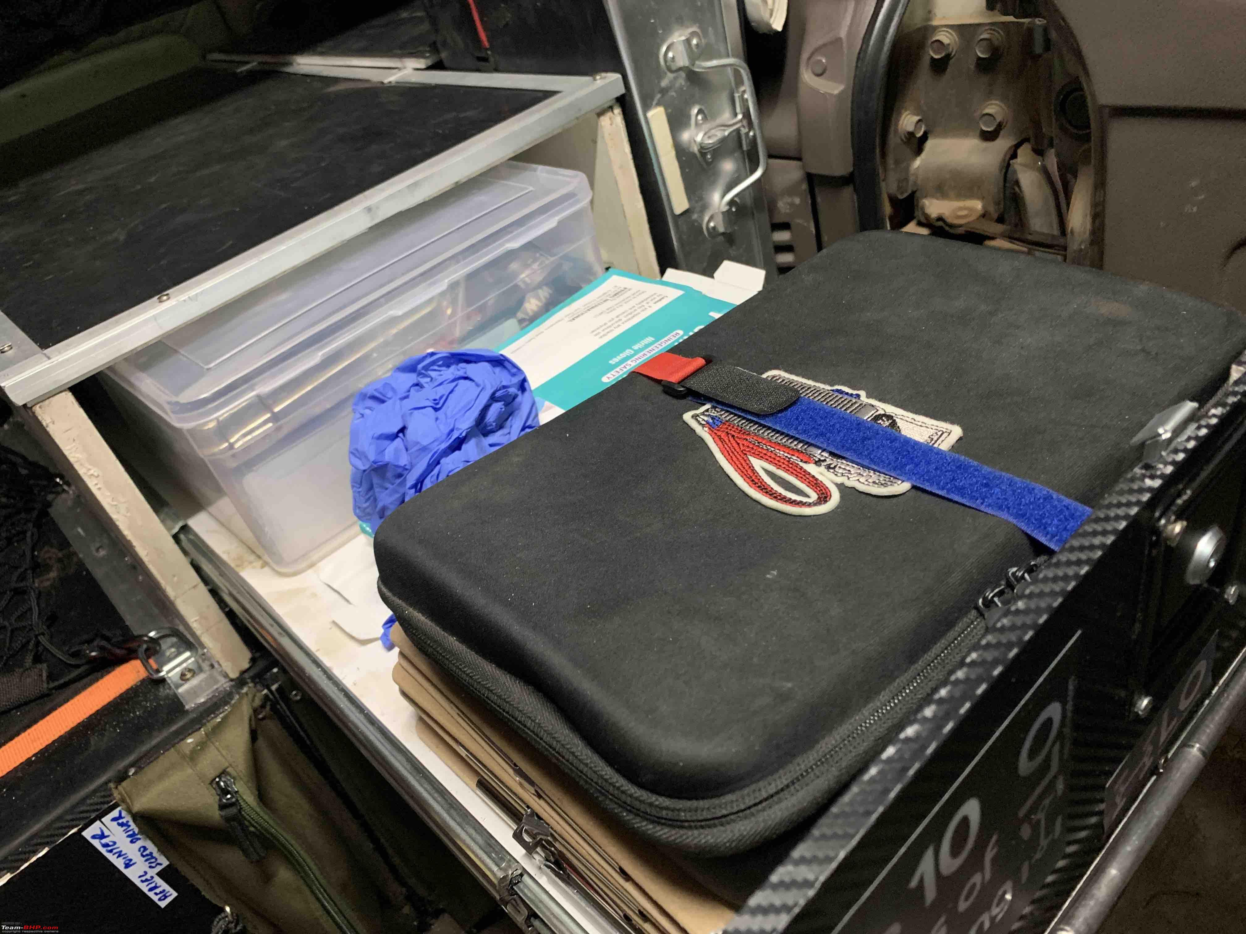

The top drawer is for the stuff for training:
The bottom one is for the magnetic signs. It also doubles up for the tea coffee stand.
Therefore I removed the tea-coffee door table I had fabricated and changed that to a custom mount for tools.

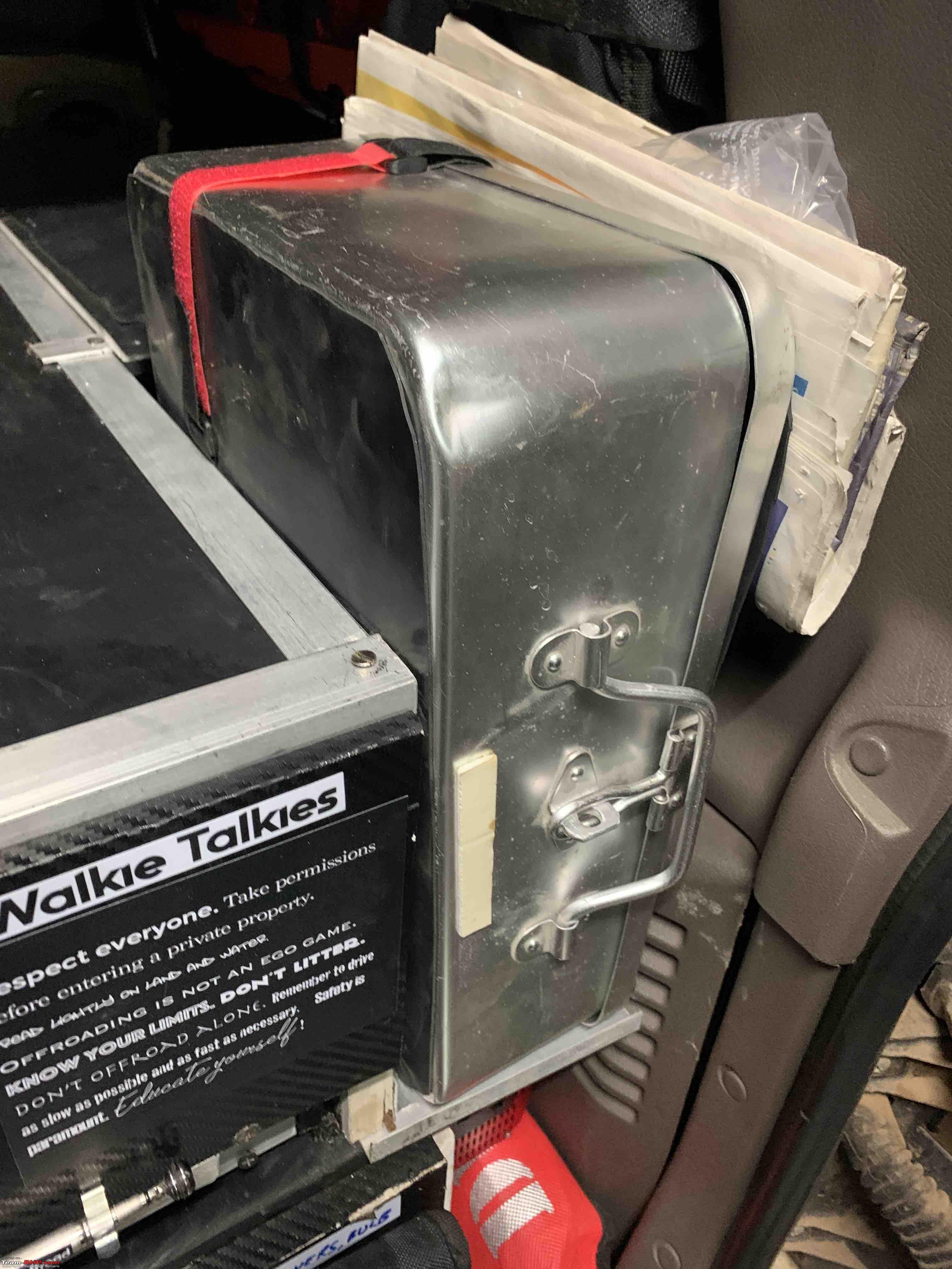

Made an extension towards the right window:
This little box is accessible from the front passenger side by opening the arm rest:
Once open I can access stuff there like folded tripod stools, wheel chocks, winch extension rope, etc.
The other side I have a net to keep objects from flying around.
Have a small box with tea/coffee/mugs and the hot water kettle:

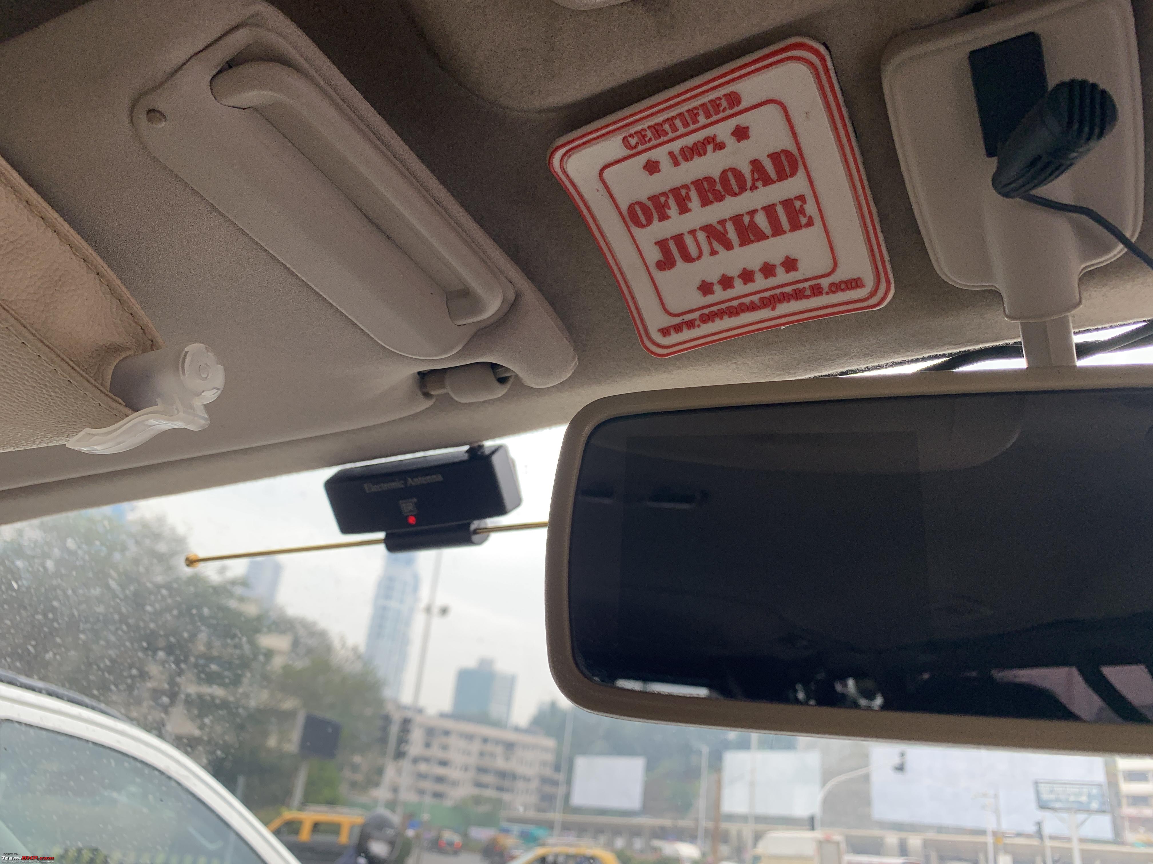

Originally Posted by Tejas@perioimpl View Post
The automatic antenna in the PAJERO is a hindrance during offroad.
Can’t keep music on or if a call comes with music off, it auto extends.
Have broken it once and had to replace the antenna. Last week nearly snagged it again.
So disconnected the antenna and motor and fitted an internal antenna instead.
Attachment 2092166

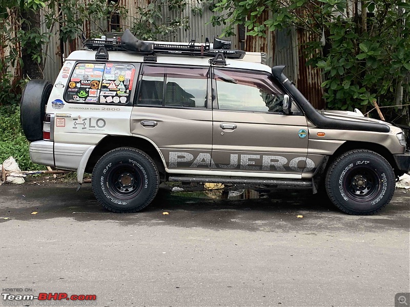

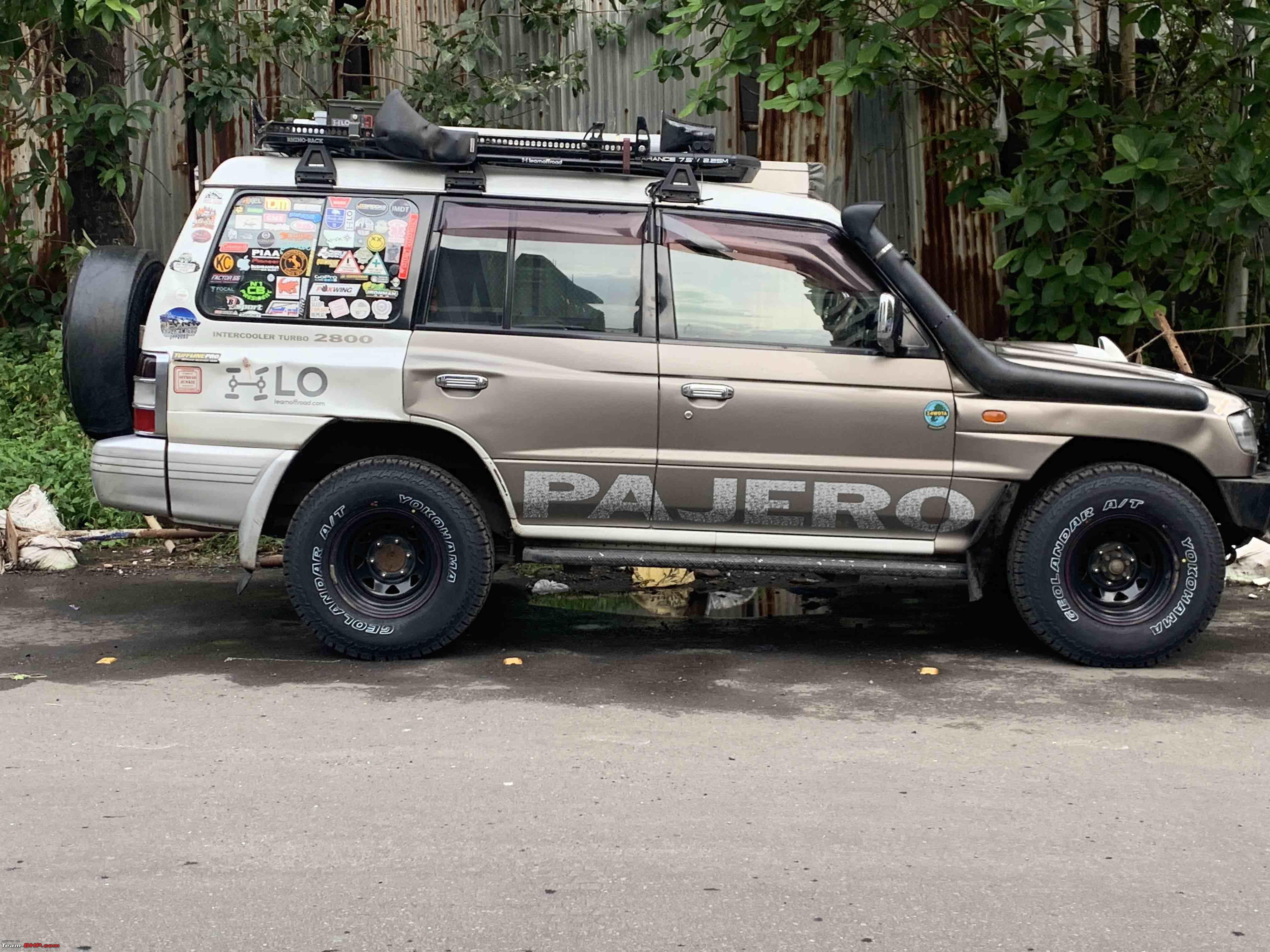

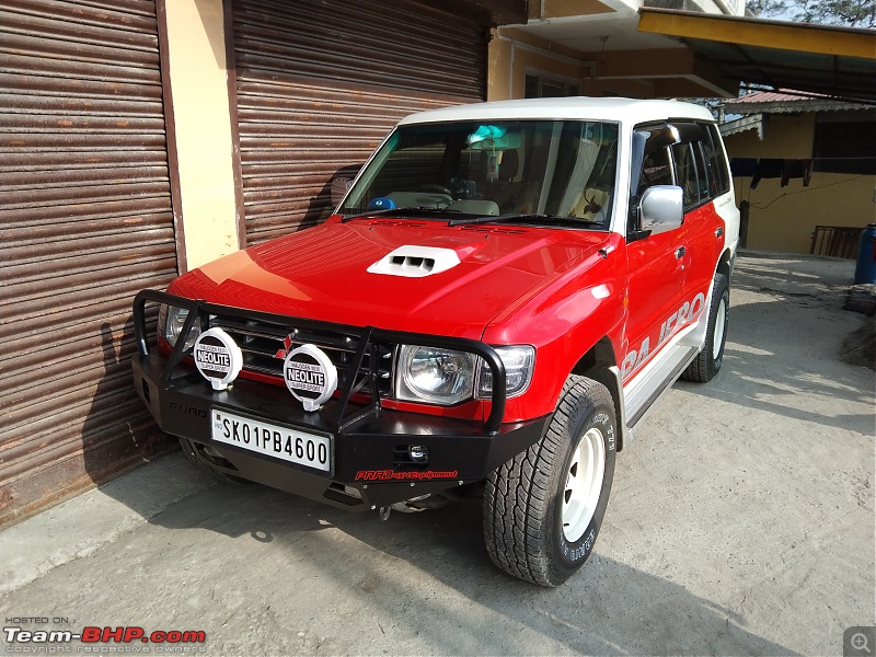

Attaching some latest pics of the Pajero with new shoes and a new off-road bumper. Next up will be snorkels and then a roof rack...that should make up the basics for long trips, the overland way

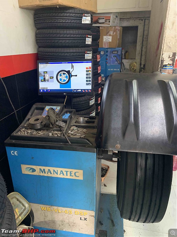

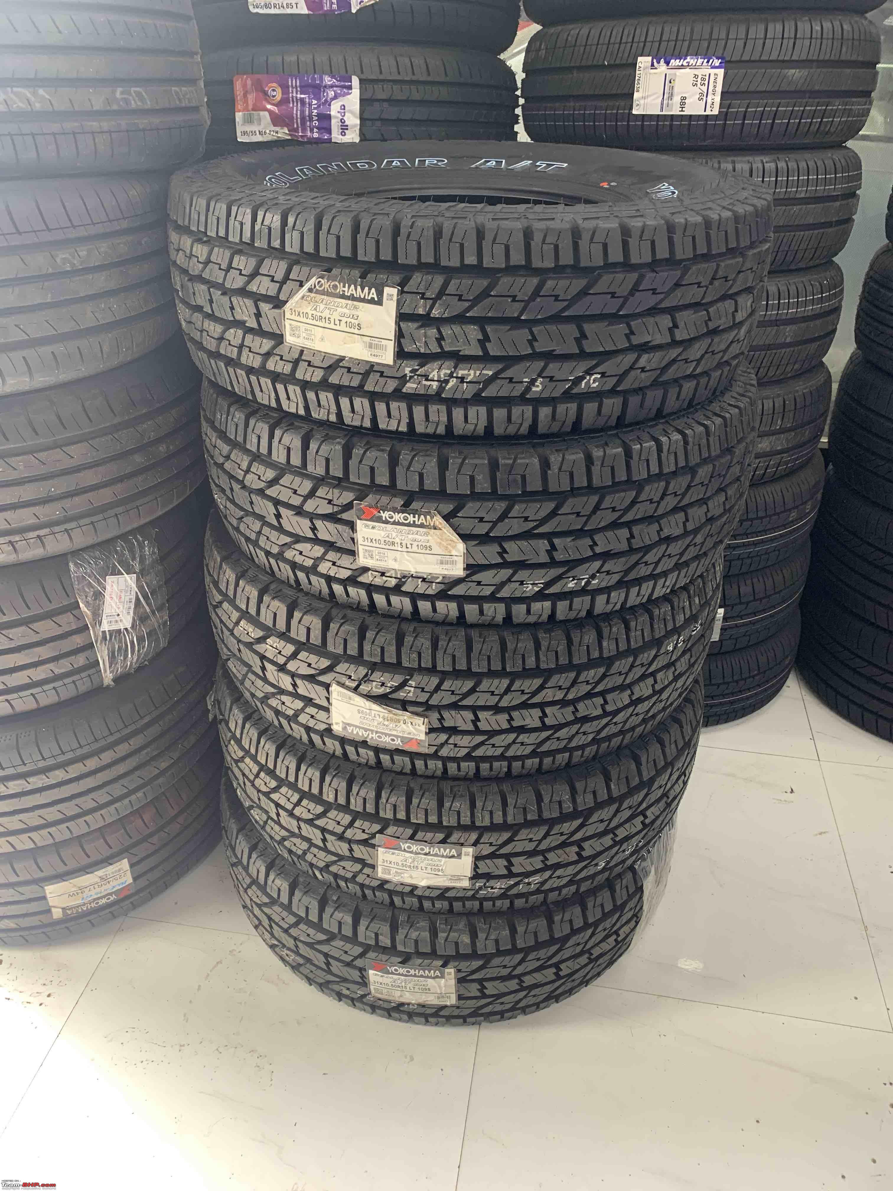

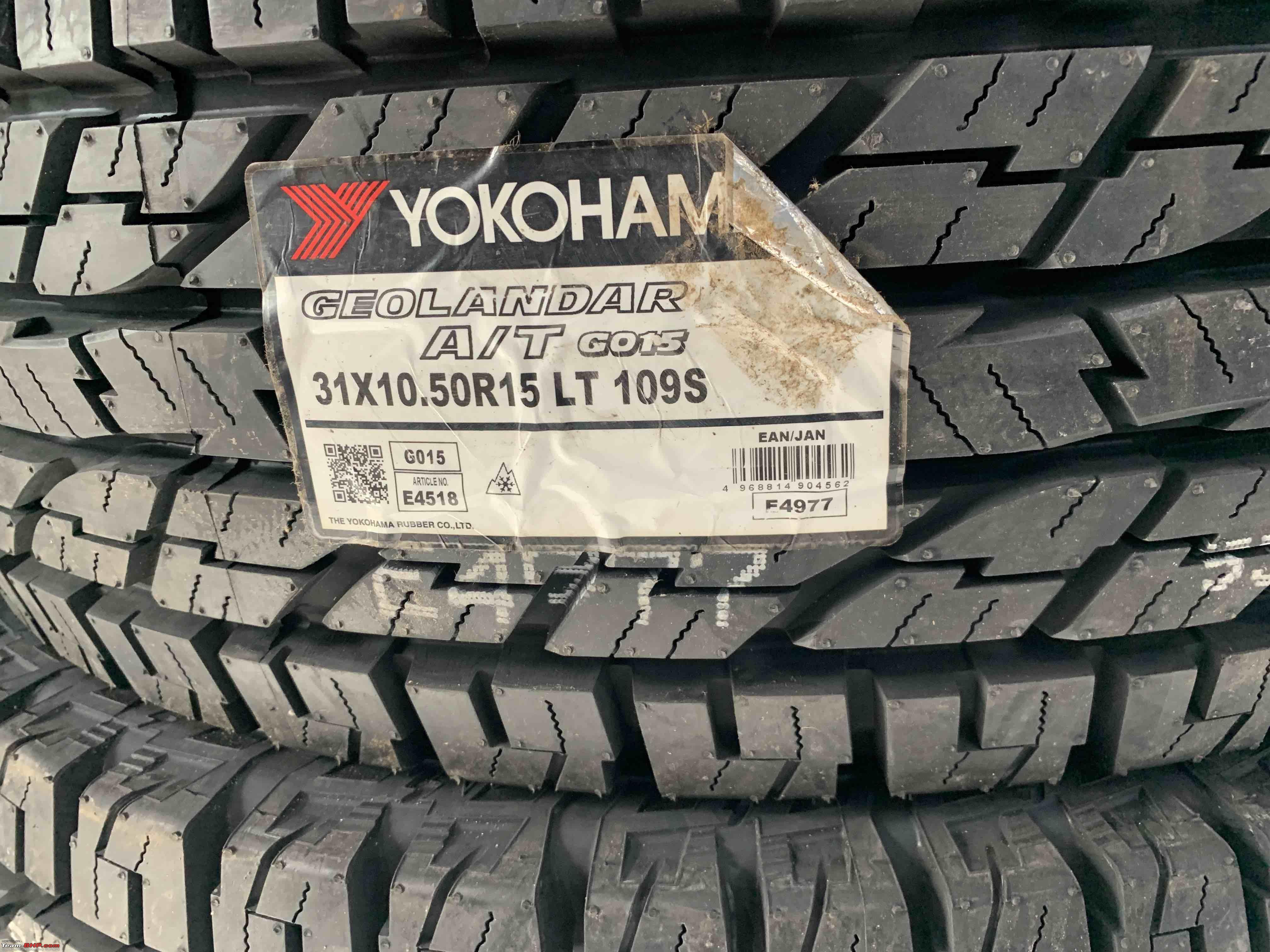

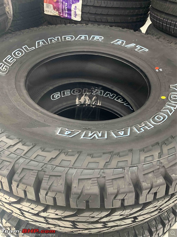

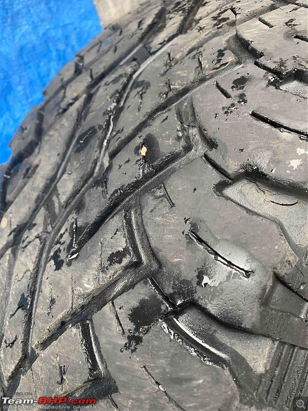

Finally in December 2015, after nearly a year, i decided to change the tyres and rims.
Nearly 5 years later and approx 50,000 kms, the tyres needed changing. Current ODO at approx 131,500kms.
Out of the 50k kms, atleast 15,000kms must have been offroad and the tyres held up good enough and needed immediate changing:
Unfortunately with the ISI mark being necessary and the imports being infrequent, sourcing 31x10.5x15 AT tyres was a pain.
The other issue being that now 15" is not a running size with most of the market moving to Thar tyre size which is 16 and above.
Continental has stopped this tyre size in India and I needed other options.
Most of the tyre dealers I spoke to had Chinese brands and I wasn't sure I wanted to invest in those unproven tyres for my heavy and recurrent offroad needs.
Some calls to contacts and I found out that a shipment of Yokohama Geolanders G015 at left Thailand and had a stock of this size.
Immediately called the dealer and blocked the size.
This is the dealer:
The tyres at the showroom:
Made an appointment and reached:
Checked the manufacturing date and was happy. June 2021.

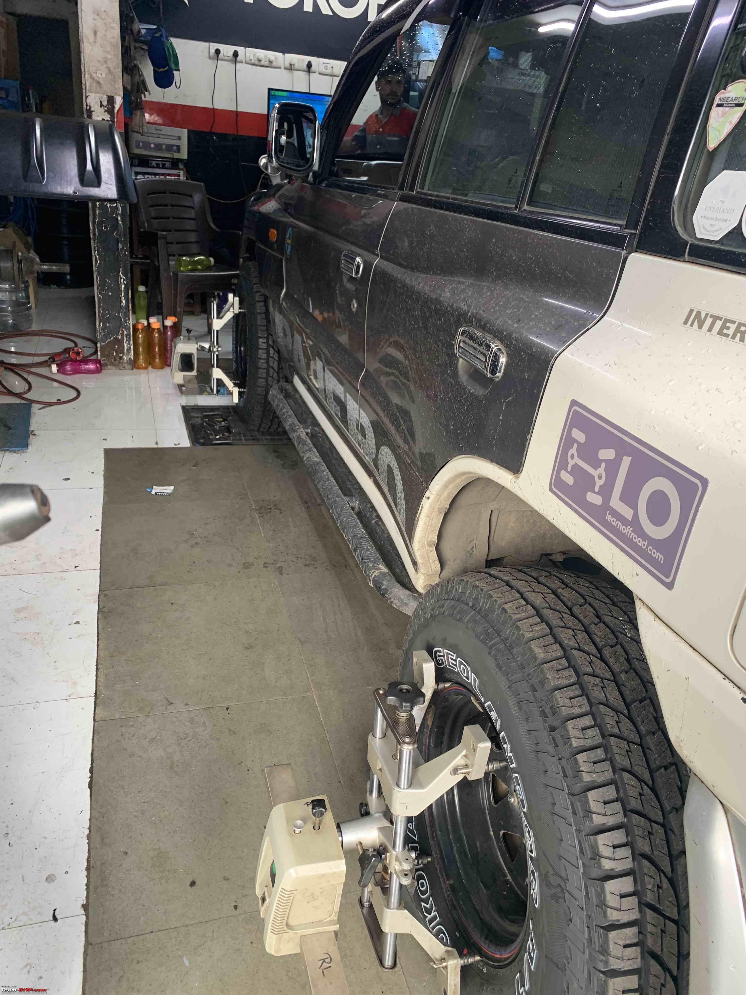

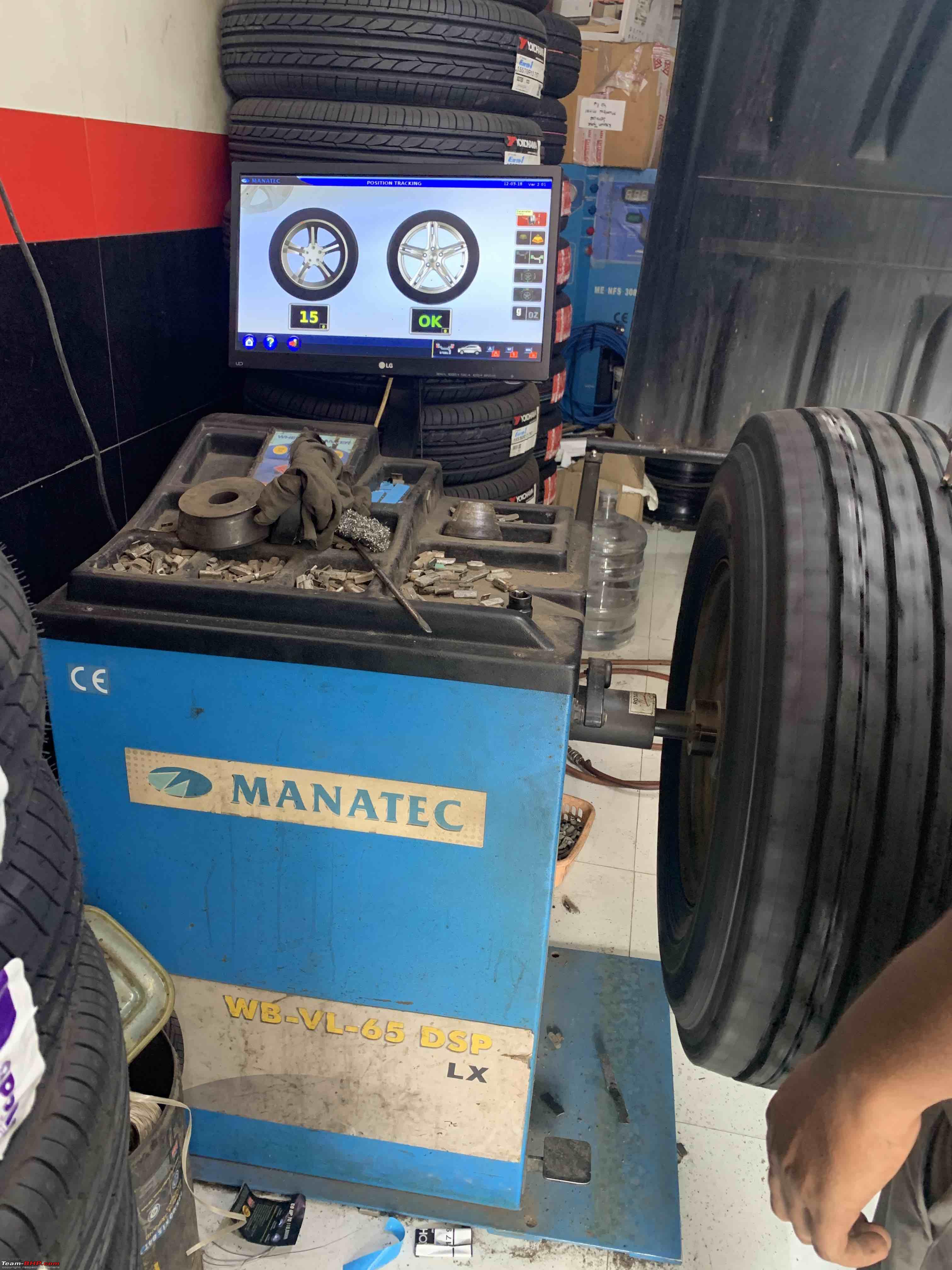

Got them balanced:
And aligned:

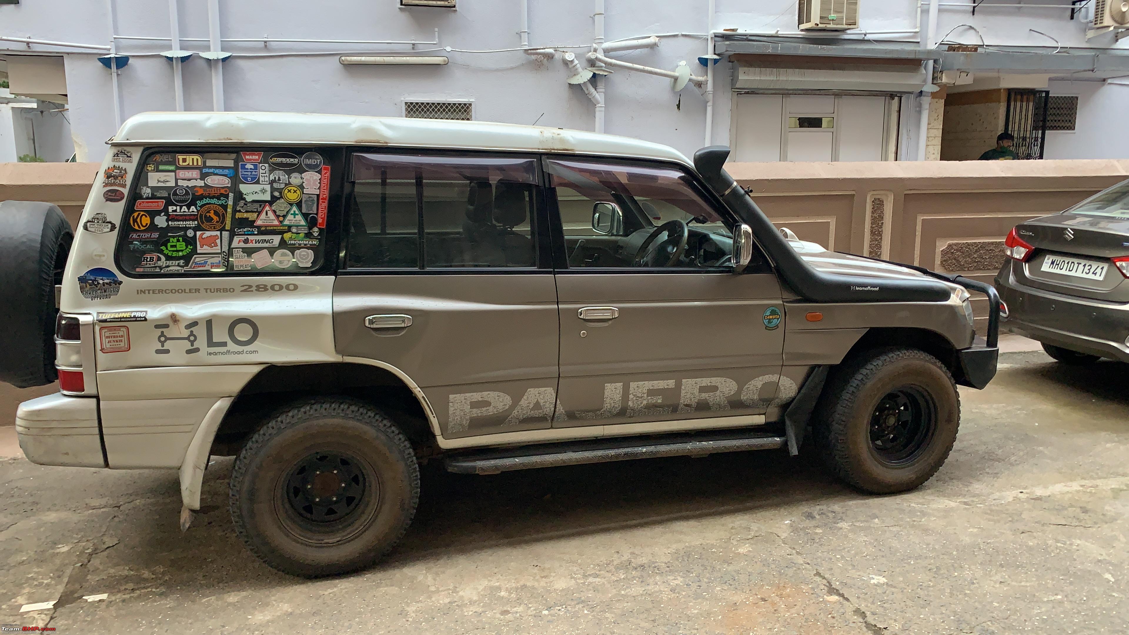

And she's ready:
These are not OWL and the colour will fade away after a few washes.
There has been some concern with weak side walls on the earlier G012 generation of Geolanders and apparently it was solved in the G015. So hoping for the best, though honestly I had no choice.
So what made me really go for this was the 1.5 year years unconditional replacement warrantee including cuts and damages and 5years manufacturing warrantee (of course the latter isn't a deal breaker).
What I love is the first ride on any new tyres. Feels so different and comfortable after using the old ones.
I changed all 5 tyres and have kept one good Conti tyre in case of emergency and will mount on original stock Rim and keep.
