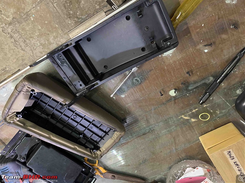

A few minor mods/repairs/DIYs during the lockdown days.
The centre arm rest of the Pajero is in two parts. Top smaller compartment and a bigger bottom compartment.
The top compartment engaging mechanism is plastic and was broken so decided to use a magnet to repair it and make it engaging again.
1. Removed the armrest:
2. Dismantled. You can see the broken stubs in the rear part:

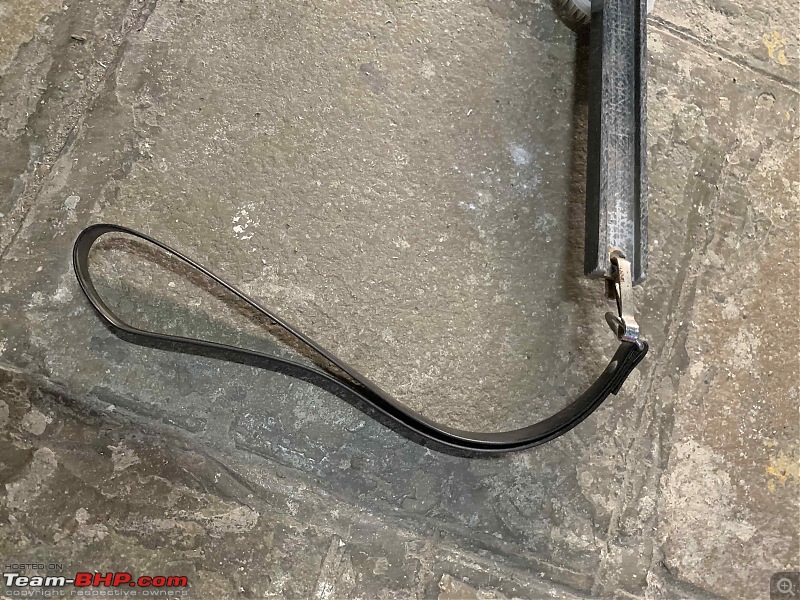

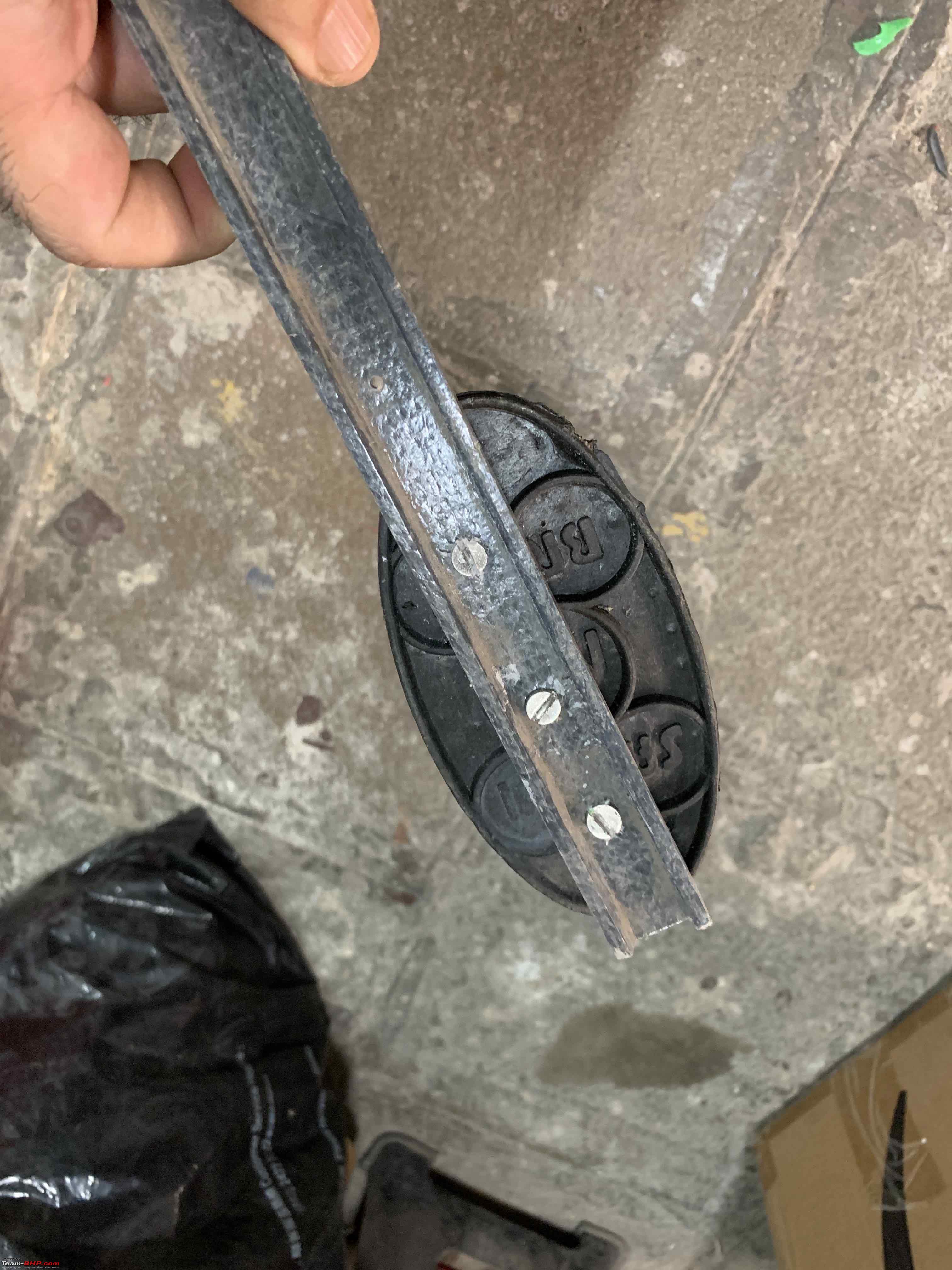

Technically not a Pajero mod but a shoe cleaning instrument.
Maharashtra mud is very sticky, bordering on clay type consistency and this results in a lot of mud being brought into the vehicle with the shoes/boots.
Not only does that cause the vehicle to get dirty, but also is a risk of the foot slipping of the brakes.
So a cleaning brush!
Items needed:
A hard brush for the soles
A semi hard brush for the top part of the boots
A handle
Something to hang the brush
Nut bolts, drilling machine.

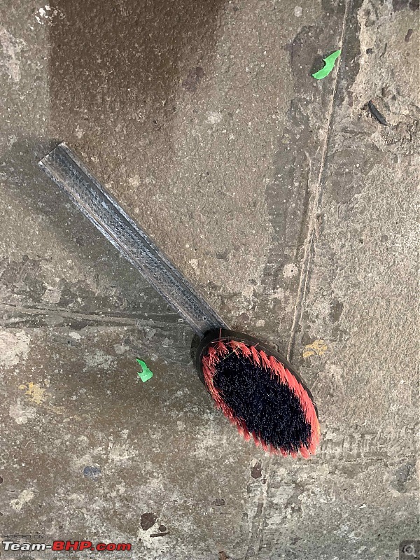

1. I had some fibre glass rods with me. Best because light weight, strong and not affected by water.
Screwed on the semi hard brush:

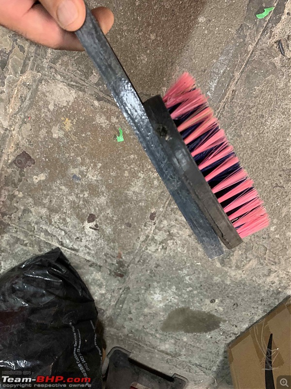

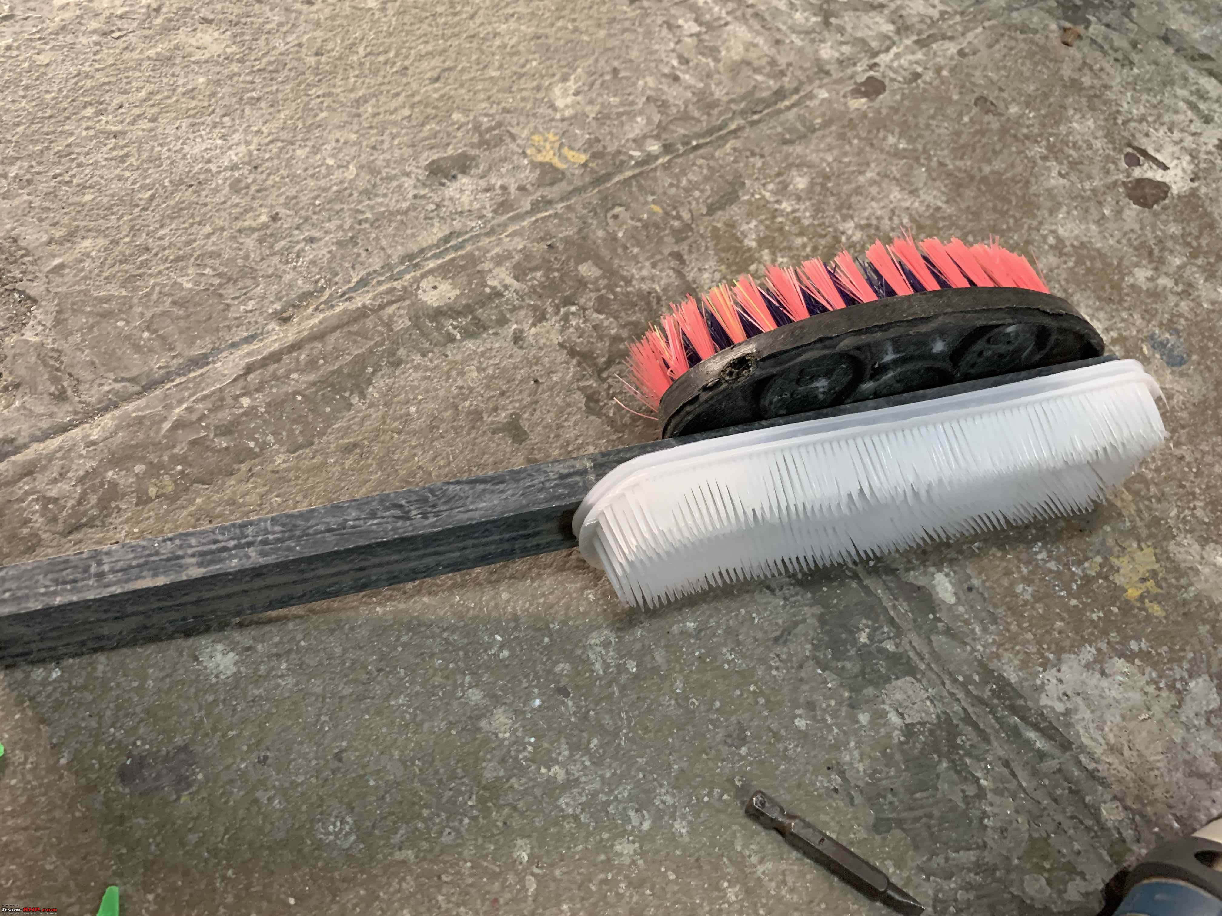

2. The harder clothes brush at the back of it:
3. A little hanging option. Great to hang after washing at home.

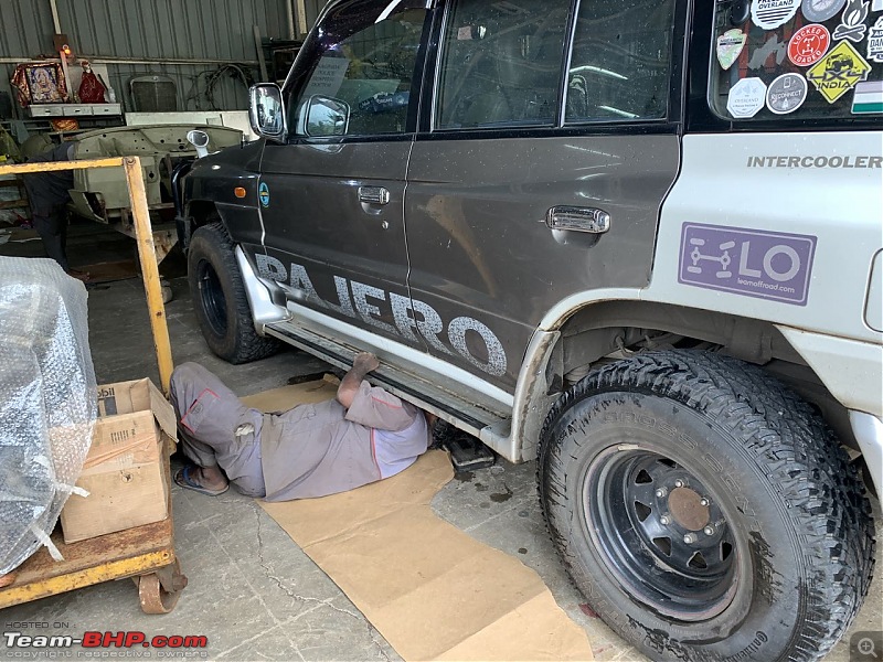

The next mod I did was finally fitting the rock sliders after buying them nearly two years ago.
Heavy duty stuff to be used with a hi lift jack if required.
Removing the old Footsteps:
Removed:
Fitting the new sliders:
These are bolt on and all you need to do is to remove one single bolt of a clamp holding the fuel line and slide it between the line and the chassis and bolt the clamp back.
Fit:
Tejas@perioimpl is offline   (13) Thanks
