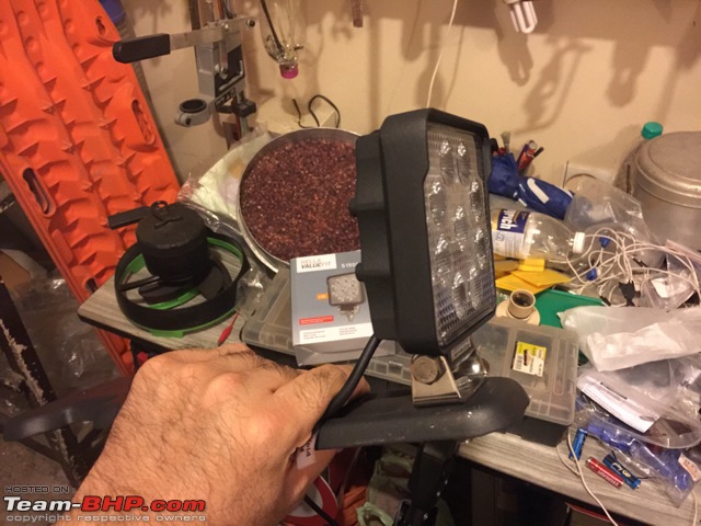

On recent trip to ahmedabad for a lecture I dropped into XS Overland store. Wonderful place and I got chatting with the owner, Vishal Joshi and was impressed by his future plans and the products he will soon be importing.
I picked up a pair of Hella Value LED lights as reverse lights to be mounted on the roof rack.
These are slim and the throw is "spread"
Mitsubishi Pajero SFX - Project Overland Conversion-imageuploadedbyteambhp1514563391.765654.jpg
Mitsubishi Pajero SFX - Project Overland Conversion-imageuploadedbyteambhp1514563410.397921.jpg
Fitted them on the spot light mounts of the Rhino Rack
Mitsubishi Pajero SFX - Project Overland Conversion-imageuploadedbyteambhp1514563434.156693.jpg
Mitsubishi Pajero SFX - Project Overland Conversion-imageuploadedbyteambhp1514563575.308340.jpg
Mitsubishi Pajero SFX - Project Overland Conversion-imageuploadedbyteambhp1514563617.361203.jpg
Mounted on the vehicle:
Mitsubishi Pajero SFX - Project Overland Conversion-imageuploadedbyteambhp1514563689.820196.jpg
Going to get the wiring for this and the front HID fogs done by a professional.
