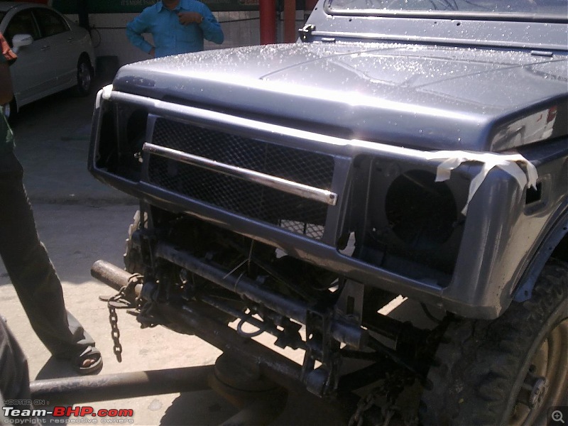

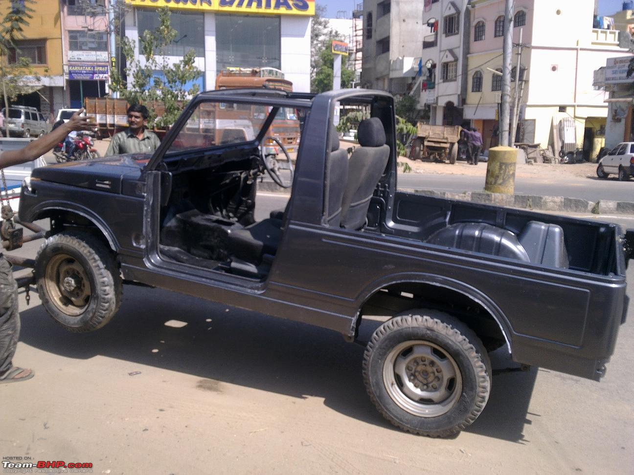

Painting is complete . Gypsy is towed to the garage from the paint shop . Jonga inspired front grill design(bro's idea).

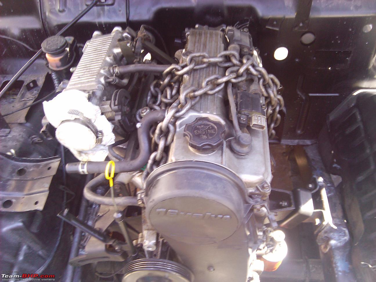

Hey guys , finally after a long wait the engine has been mounted into engine bay . Some pics of the same

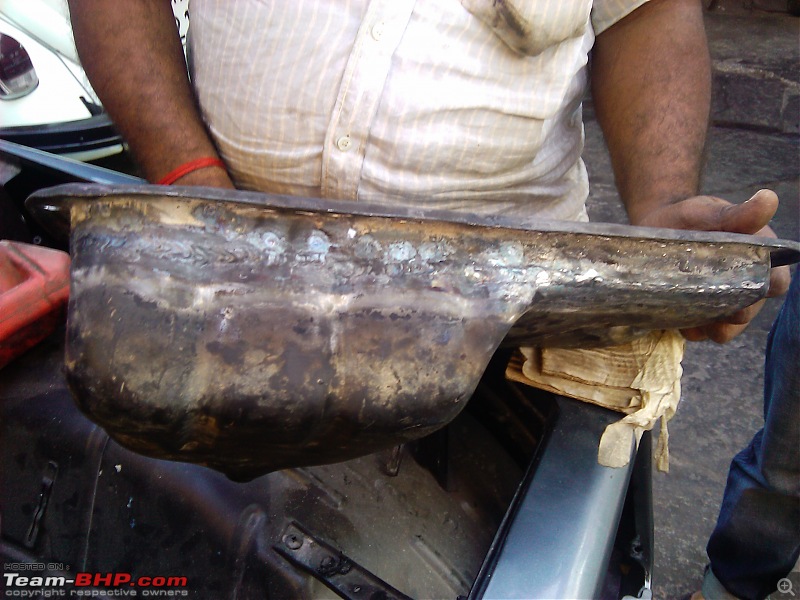

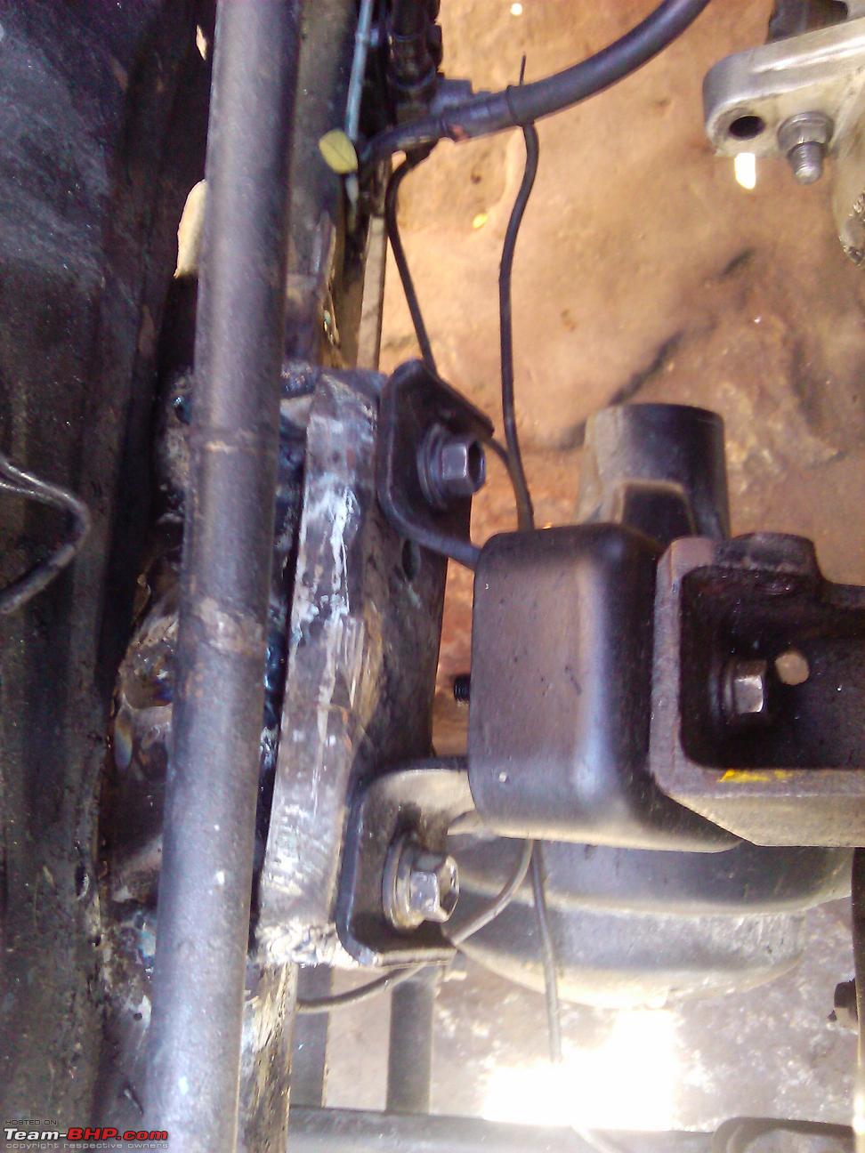

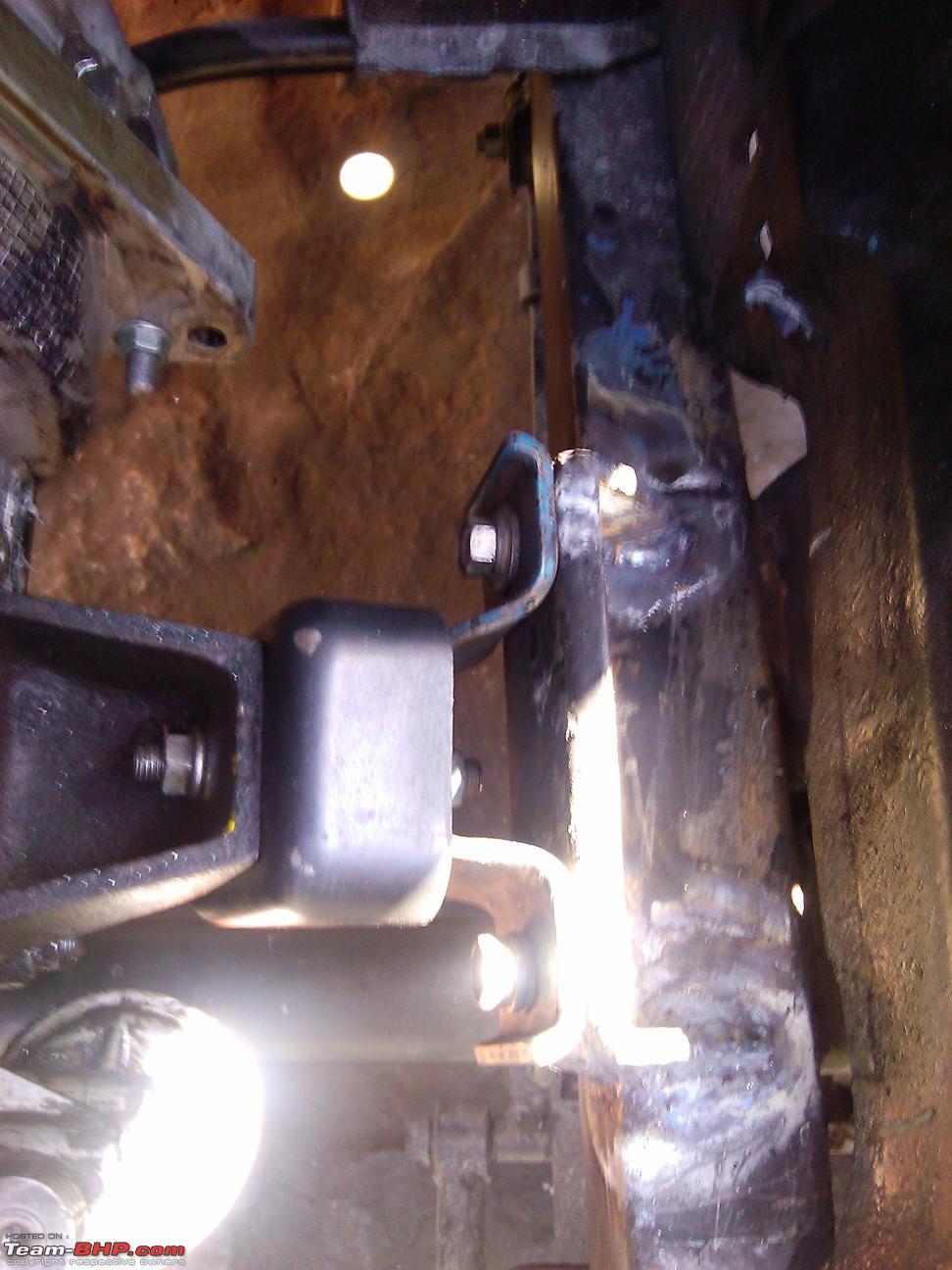

Its been a really long time i updated this thread as i have not been visiting the garage from 2 months due to work constarints . Went there yesterday and the following work was done .
1. Engine wiring complete
2. Gypsy king MPFI's fuel tank , fuel pump & fuel gauge was fitted (new) (Viji sir got these for me)
3. ECM properly located .
4. Shackles fitted (thanks to Viji sir for the shackles)
5. Radiator & piping done (both inlet & outlet)
6. oil pan alteration
Pending works
1. Fuel pump & gauge wiring
2. The igniters are broken so ordered new ones to crank the engine
3. Radiator fan yet to be done ( would electric fan be a good choice)
4. Exhaust
5. Air filter ( which vehicle's filter will suit , it should be snorkel friendly)
6. Added brake booster
There are few other works which i cant remember . Now some pics
