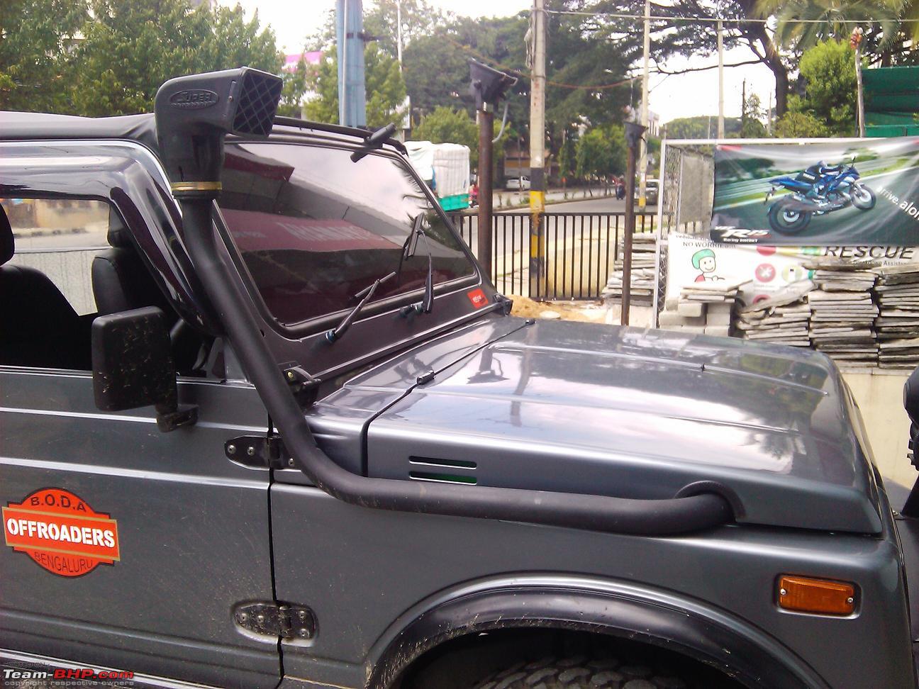

UPDATES : Added 2 more accessories from "SWASTIK FABS" range of 4X4 products .
1. Snorkel
2. Rock sliders
Now the gypsy looks even meaner
