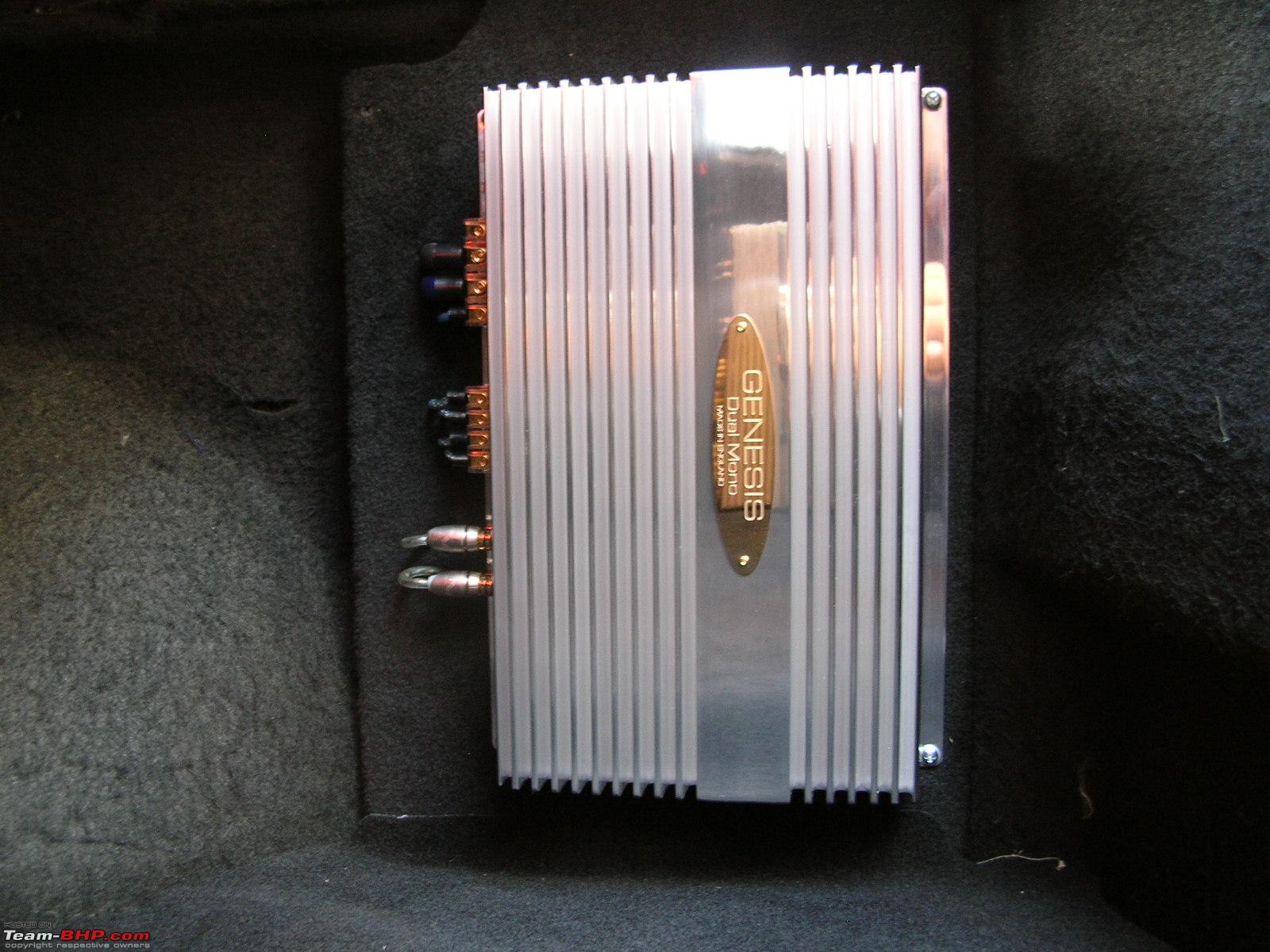

Midbass and midbass amp
Dynaudio MW162GT running off a Genesis Dual Mono...the HLCDs run off 2 channels from the Genesis 4-channel that I already have, remaining 2 are bridged to the sub.

Just awesome! Welcome to the Mitsubishi + P80RS + HLCD club!
"Something you can live with" is incorrect. Very soon you will realize that it is "something you can't live without".
Active from the head unit or the Genny? What's the XO frequency/ slope in the mid-high band?
Active from HU, 1.25khz from midbass to HLCD.
