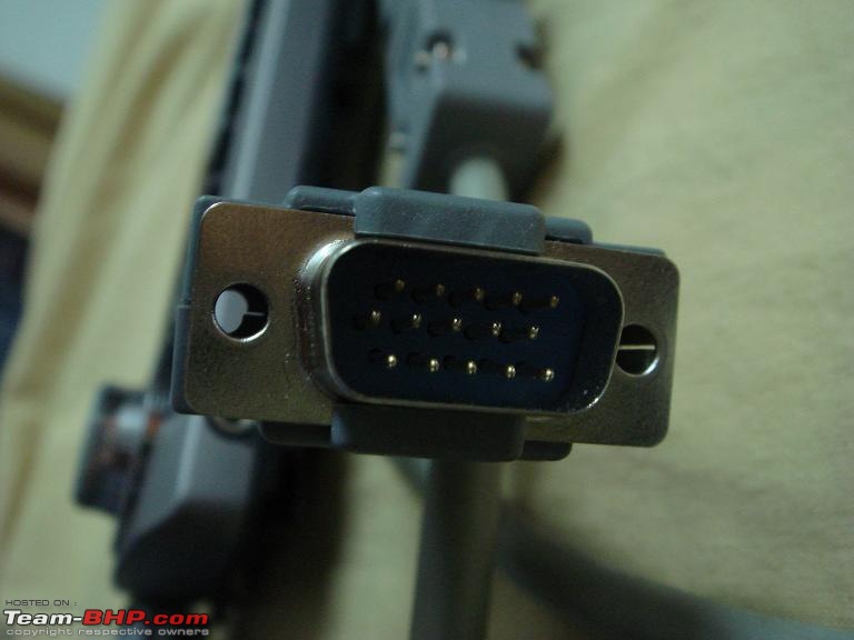

hi,
here is an update. i got the HU splited.
it is splited with about 1.5m wire with both side connectors.
it is split in a way that it can be fixed together again when ever i want.

Old 26th March 2010, 17:09   #10
shreyasma's Avatar
Join Date: Jan 2007
Location: Bang!
Posts: 652
Thanked: 6 Times
You have done a professional job. Very clean and easy to disconnect.

Originally Posted by Bass&Trouble View Post
Why are you using a Car PC AND a head unit since I suppose you can't use the head unit transport anyway?
well, i was using my HU before also with my carPC and wanted to retain the beauties of my HU as i like it display. And more over my carPC cannot give me 4.1 channel output unlike my DEH-P8650 unless i spend about Rs.5k to 8k on the sound card.

how did you manage to divert the wires of the speakers from the dash to under the seat? hasn't it become too messy under the seat?
