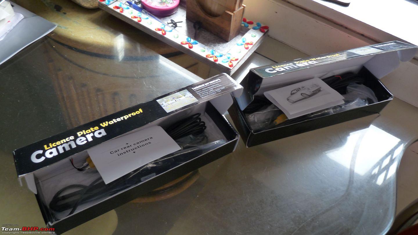

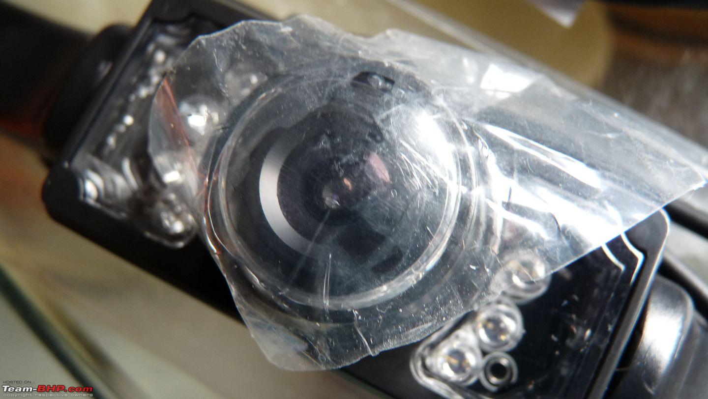

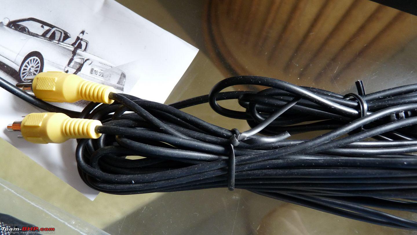

And we have the final few packages flying in this weekend. ALL overseas purchases are complete. NOW for the Processor, MOBO, RAM and Cabinet. After which we start the process of assembling it.
For now, the reversing camera was here 2 days back from Global Easy buy, which had their FREE shipping from USA scheme last week, again.
