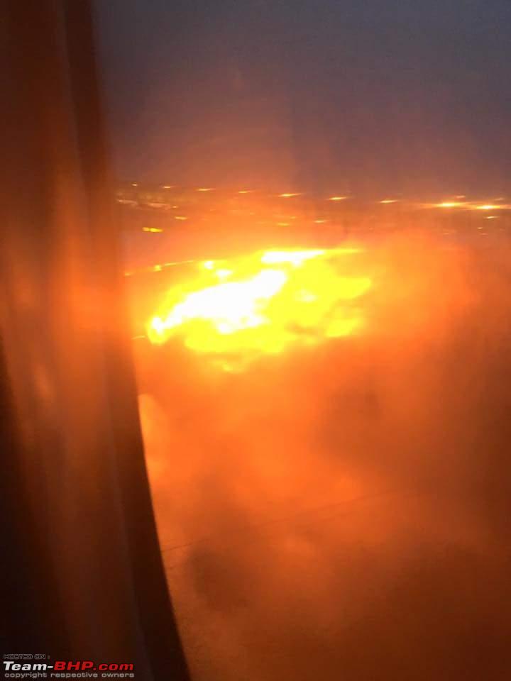

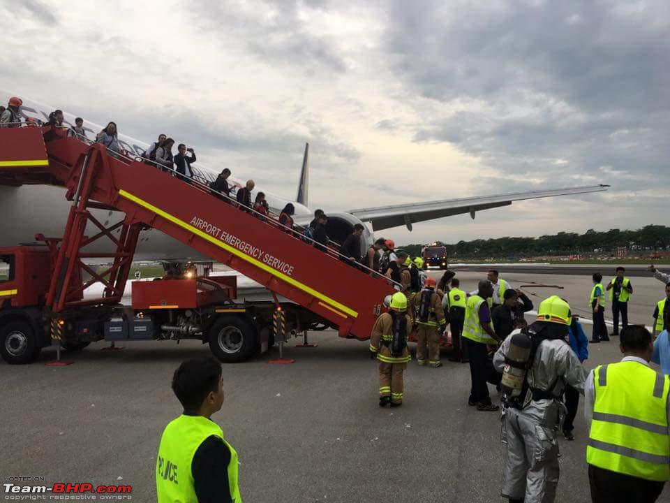

Pilots, If you have any sort of information about the root cause of the right wing fire of the singapore airlines 777, request to please share here and help us understand how it was detected on time and how it was averted just in time with seconds to spare.
The reason mentioned was oil leak, but the reason looks very vague and was the engine shutdown entirely and was the air craft returning with just one engine powering ? if the engine was shutdown how come the fire still managed to engulf ?
I am still in awe of the heroic efforts shown by the firefighters who put off the flames in minutes just like that, they are the real hero's who need ovation in every possible way to appreciate their efforts in saving lives.
http://www.smh.com.au/business/aviat...27-gpsl5n.html

That's a tail pipe fire. It occurs only on the ground during engine start or stop.
There are 2 types of fires in plane engines - internal (in the fuel chamber) and external (in the outer chamber)
Imagine the engine as 2 cones one inside the other. The gap between the cones has no fuel at normal times. Sometimes fuel gets in there due to leakages, pipe rupture or aging component failure.
There are 3 inflammable fluids in planes. Fuel (auto ignition at 230 degrees centigrade), general oil (260) hydraulic oil (450). Any of these could have spilt on to the outside of the super hot internal cone and caught fire.
You shut down engine. Isolate it by closing electrics, hydraulics and Pneumatic. Spray fire extinguisher chemical.
Internal fire is what you asked about. Only reason is an excess surge of fuel. This is not dangerous.
Why? The internal cone is anyway designed for high temp. operation.
The fire fighters did the wrong thing. I guarantee the airline manager and airport fire chiefs are fighting now.
You need to shut down the engine fuel supply.
And dry crank the engine. This removes the unwanted fuel.
No point releasing the internal fire extinguisher. It does not go into the inner cone.
You can release the internal extinguisher if you like. It will ruin the engine. Like what the fire fighters did anyway.
A bird hit can cause a fire. Actually not one bird. 5.
Engines are built to provide 75% power even if a 3.5 kg bird is followed by 4 more 1 kg birds. I swear.
Engine flame out is the opposite of engine fire. Literally the bulb is off. Or no flame in the candle. The auto ignition gets triggered. It will continuously try to relight the engine. Like the automatic gas stove at home.
The most spectacular fire is a tail fire. Fuel and oils sometimes accumulate on it. Sometimes it catches fire. You'll be seen blazing a trail of fire across the sky.
Adults Panic. Kids won't be surprised. That's exactly how space ships work in cartoons.
Again not a worry. When the inflammable stuff burns out the fire will stop. Usually.
When I'm a trillionnaire all my planes will have a fire-tail system.
When the fire is detected pilots don't do anything to the engine.
They let it burn.
Because first thing is they regain control of the plane.
Then point in the right direction.
Then they try to identify if it's a genuine fire alarm.
Then identify which engine.
Then isolate it.
Then do the steps mentioned above.
Some pilots abort take off or turn back. Sometimes fresh pilots apply the wrong procedure for tail pipe fires. Like NOT dry cranking.
If the fire is out and the plane is flying you try to keep the engine in idle if possible. This still provides electric and hydraulic power.
Can you please elaborate this ? You mean that with 220 + passengers on plane they should have waited to let fire cease on it's own and there was no chance of this fire getting spread to fuel tanks or am I missing something ?
The passengers were reportedly calm and composed. It means the air crew communicated well. 10/10 points.
Sure it looks scary. It would have been controllable. But it's still not dangerous.
The fuel tank is/was not going to explode as the pilots would have closed the supply immediately.
Too many people would have sued the airline if they were asked to wait inside the plane. So evacuating it was the legal safe method.
I don't know any military pilots. If you do, ask them what they do. I'm 99% sure they stay and battle this type of fire.
The only technical matter here is there are no sensors for tail pipe fire. There is no specific warning. It has to be a visual alert.
It's always on the ground so someone or other will notice it.
There are 3 parameters continuously monitored on the engine.
1. Outer fan speed
2. engine pressure difference between entry and exit
3. exhaust gas temperature (egt).
The EGT may have increased. That can be overlooked/missed at times. Because the EGT will always rise to peak and maximum values.
Maximum EGT means max. safe value. That's not breaking point. It will always go higher to a peak EGT. This is on full load take off.
The difference between max. and peak is a measure of engine life left. Older engines have a lower peak.

I really didn’t want to reply to your posts, but seeing the extent of your misinformation, I had to. You are absolutely and unequivocally wrong. Let me elaborate.
Originally Posted by hangover View Post
That's a tail pipe fire. It occurs only on the ground during engine start or stop. The most spectacular fire is a tail fire. Fuel and oils sometimes accumulate on it. Sometimes it catches fire. You'll be seen blazing a trail of fire across the sky. Adults Panic. Kids won't be surprised. That's exactly how space ships work in cartoons.
A tailpipe fire is one which occurs within the normal gas flow path of the engine. This wasn’t just a tailpipe fire. This might have originated in the tailpipe, but it spread to the wing as well on landing. But the important point to note is that tailpipe fires are indicated by a warning on the EICAS on the 777. This might have been the reason for the crew requesting firefighting equipment. In all probability, they had an oil leak in the right engine and then have used reverse thrust on landing which blew the hot oil all over the wing. But this theory assumes that the right engine wasn’t shutdown, something we don’t know for sure yet.
The fire fighters did the wrong thing. I guarantee the airline manager and airport fire chiefs are fighting now. You can release the internal extinguisher if you like. It will ruin the engine. Like what the fire fighters did anyway. -----------
Sure it looks scary. It would have been controllable. But it's still not dangerous. -------------
For once, tell me you’re joking. The occurrence of smoke or fire on board commercial aeroplanes during flight is an extremely dangerous situation. If not dealt with effectively by the aircraft’s crew, it can result in disaster. I've seen what a fire can do in a confined space such as an aircraft, and believe me, it ain't pretty. In a matter of seconds, it can from just some smoke to an all out inferno.
The only reason you're reading about this as an incident is because those fire fighters extinguished the fire. The aircraft fuselage is designed to withstand approx. 3 minutes of direct fire impact. In general you can say that after 2-3 minutes of a fire that intense, the aluminum gets burned through. The B777 wings can withstand longer as the composite material doesn't melt as fast, but still, they had no more than 5 mins of time before this fire turned the 777 into an aluminum coffin.
No, no and no. Evacuation was delayed by 1 mins and 10 secs because there was a strong crosswind from the right at the time of fire and there was a chance of the fire extending to ENG 1. Also remember that emergency services were in stand by for this landing already, we can safely assume that fire fighters observed the aircraft and gave their recommendations to the crew of how to proceed, and this recommendation may well have been to not evacuate.
The only technical matter here is there are no sensors for tail pipe fire. There is no specific warning. It has to be a visual alert. It's always on the ground so someone or other will notice it.
Wrong. There is a EICAS warning and caution for a Tailpipe Fire. The exact text is : FIRE ENG TAILPIPE L, R. We do not depend on visual alerts for tail pipe fire. If you want, I can post photos from my QRH.

It is very immature to speculate about the flight or the airline crew's training and judge their action based on a video, which does NOT provide you with the information required to analyse the situation in its whole. If you are an aviation professional, maybe cut your fellow professionals some slack. If you are not a professional, then do not act like a manager behind a desk who just read a thick volume of "Managers Guide to Hindsight".
Can you please elaborate this ? You mean that with 220 + passengers on plane they should have waited to let fire cease on it's own and there was no chance of this fire getting spread to fuel tanks or am I missing something?

Here are some photos of the incident.

To add to what I said above, the pilots are getting called out for not evacuating immediately. Here is the truth:
The decision to evacuate is grave. People will get hurt, some badly. Deaths are a possibility. Imagine 80 year olds going down those slides. Handicapped passengers. Idiots with their carry ons. There is a real risk that someone will open an exit on the side that is on fire. There are reports of fuel fumes in the cabin. The Crash Fire Rescue Crews will be taken away from fire fighting and forced to deal with confused, panicked passengers.
And while this probably does not apply to Singapore Airlines, I will say this anyway. My colleague flew 6 years for a bottom feeding, cost cutting, scumbag run airline. For the pilots at these airlines, every day is a battle. You're pushed and coerced to cut corners in the name of saving money. You'll be challenged if you want to increase the fuel load because the weather is marginal (fuel burn is increased in a heavier plane). You'll be threatened with punitive action if you call off sick (which you're obligated to do by federal law). You'll be bullied by middle management if you ground a plane for maintenance reasons (which you're also required to do by federal regulation). And you'll have your decision making questioned if you order an evacuation of a smoking airplane not because some pax were injured on the slide, but because blowing the slides costs money!
And even on international carriers, your pilots are up front fighting this battle every day.
While what you say is 100% correct, usually in case of a fire that cannot be positively confirmed to be extinguished, the usual course of action is to evacuate. Although, I completely agree that the pilots must have had their rationale for not evacuating, it will not be easy to convince either their flight safety team or the investigating team about the same.
