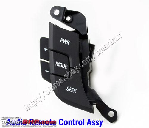

Further things to be explored:
- Adding the temperature sensor for Beat LS variants.
Since mine is LT, it was not required and hence did not check further.
May be someone having LS can take-up it further.
- Adding Bluetooth functionality - a wild guess - chances are rare.
- Adding steering mounted controls for the audio system in LT/LTO versions.
It should be very much possible.
The switch module is available in ebay.
http://www.ebay.ph/itm/2010-2011-201...item416c93e18f
But Very costly
It comes with the switch module and the clock spring assembly like this:
Chevrolet Beat DIY - Unlocking Features in the Speedo console-steering_control_spark.jpg
Chevrolet Beat DIY - Unlocking Features in the Speedo console-steering_control_switch_spark.jpg
Chevrolet Beat DIY - Unlocking Features in the Speedo console-steering_control_clock_spring.jpg

- Adding steering mounted controls for the audio system in LT/LTO versions. It should be very much possible.
But Very costly
This does the job perfectly, but I opened my calculator and started calculating, and came to approx 5k !!
That is shockingly costly !!
