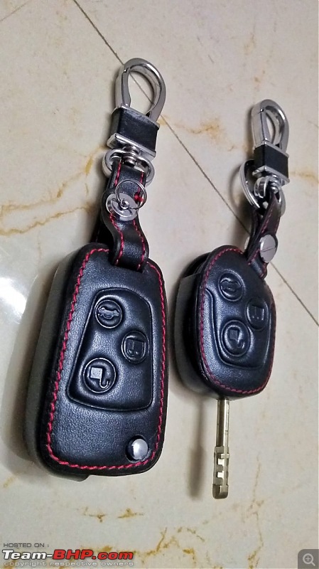

Ford key converted to Flippy. Just sent the photo of the key to the Aliexpress seller, amazes me how they exactly did the cutting with just a photo.
Both keys work, chip also purchased from Aliexpress

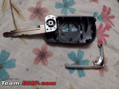

Got the key blade shaped, installed the module and immobilizer, pressed the unlock button and nothing happened!
The manual locks worked and the engine would start but the lock/unlock module would not work. I swapped the modules with the spare key and again no response. After some fiddling realized that the lock/unlock would work perfectly when the module was outside the flip key but not inside though the tactile feel of the button presses felt unobstructed.
There seemed to be some signal attenuation inside the flip key so removed the metallic parts one by one and yet no result.
DIY: Flippy Key-img_20230327_190722132-2.jpg
Then it dawned on me that the thin chrome ring which I presumed was plastic could be the culprit. Removed that bit and now it worked!
The chrome ring has a feeble attraction to a magnet so there indeed was some metal in it though it seemed less metallic than even the tiny screw the key fob came with.
DIY: Flippy Key-img_20230327_192501274-2.jpg
Out of curiosity I cut a section of the ring but could not discern any wire within.
Now that it was cut, ideally it should change the attenuation properties of the ring so put it back on the flippy key and sure enough it didnt seem to interfere with the signal anymore. Job done.
