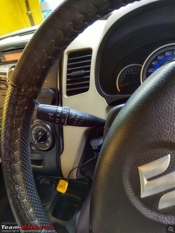

Hello Bhpians.
Just finished adding the S-Cross wiper stalk to my Wagon R. The intermittent front wipers work just as they are supposed to do. However the only drawback of the switch is that I have lost the rear wash and wipe functionality. The rear wiper works normally, it's just that the rear wipe and wash has stopped functioning.
Attaching pic after the installation. Didn't remember to click pics of the process in excitement of doing my first DIY.
Happy to do the DIY . Thanks Audioholic for sharing this mod.
Regards
Debasish

Hello Bhpians.
In continuation of my above post, I would like to know whether I did something incorrectly so as to lose the rear wash and wipe function in my Wagon R or is it that this is not supported by the new switch.
Its not a deal breaker since the rear wiper works normally and the intermittent functionality for the front wipers is really useful.
Its just my curiosity.

Does the wash mode work when wiper is on? In my car I can use the rear washer after turning on the wiper. But the washer only mode doesn't work. This is something to do with the switch itself and the way the internal circuit of the switch is designed. Same reason for the intermittent wiper mode to not work either. The S Cross has a different motor for the rear wiper compared to WagonR, Celerio with a separate circuit to trigger intermittent mode. The washer circuit is linked to this. Since its absent in your car, the wash wipe mode wont work. However the washer works with the continuous wiping mode. Confirm if its the same.
Thanks for the reply.
Yes, I tried out the rear washer after turning on the wiper and it worked. As told by you, the washer only mode doesn't work. But i am happy with the swap. I have gained the intermittent functionality without actually losing any of the existing functions.
The only bugbear is that now after the switch the left and right stalks don't match visually. But then I don't care about the visual mismatch. The functionality gained out weighs the cosmetic appeal.
Thanks once again for sharing this useful mod.

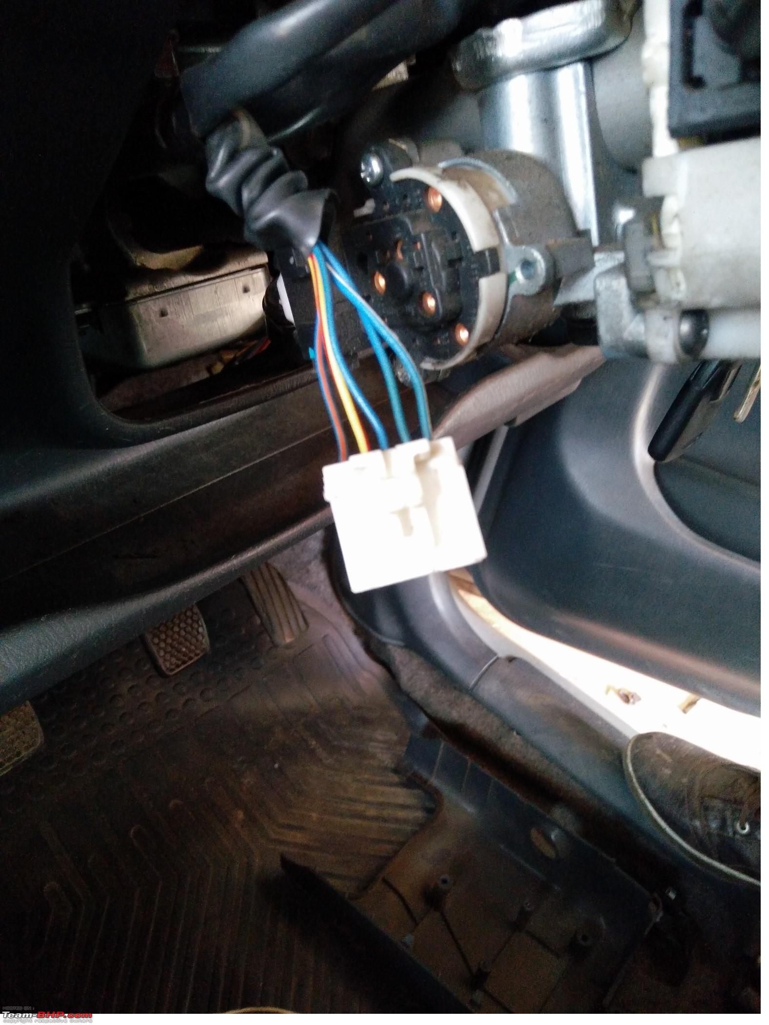

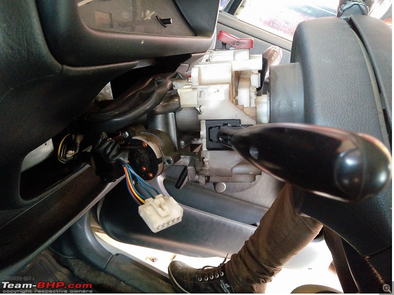

About the 2007 WagonR I am not sure. Maybe if you can open up to check the connector it would be possible to take a hunch. I am confident for the WagonR K10 and later.
Hey Audioholic,
I clicked the pics of my WagonRs' Wiper stalk socket. Is this compatible to add intermittent included stalk?
Thanks
DIY: Adding "variable intermittent wipers" to the Celerio & other Marutis-img_20171110_134801.jpg

Originally Posted by ramki067 View Post
Hey Audioholic,
Thanks
Nope, unfortunately that is not the same connector as in the stalk we have used. It seems to be a more basic version and has lesser pins, along with a completely different layout. Just to reconfirm, have you removed the same connector or is this a different connector? If it is indeed the same, then the part swap wont be possible.
audioholic is offline

Re: DIY: Adding "variable intermittent wipers" to the Celerio & other Marutis
Oh .
Yes, i confirmed that i removed the correct connector.
Well, thanks for your input. Hope to do some other useful mod.
