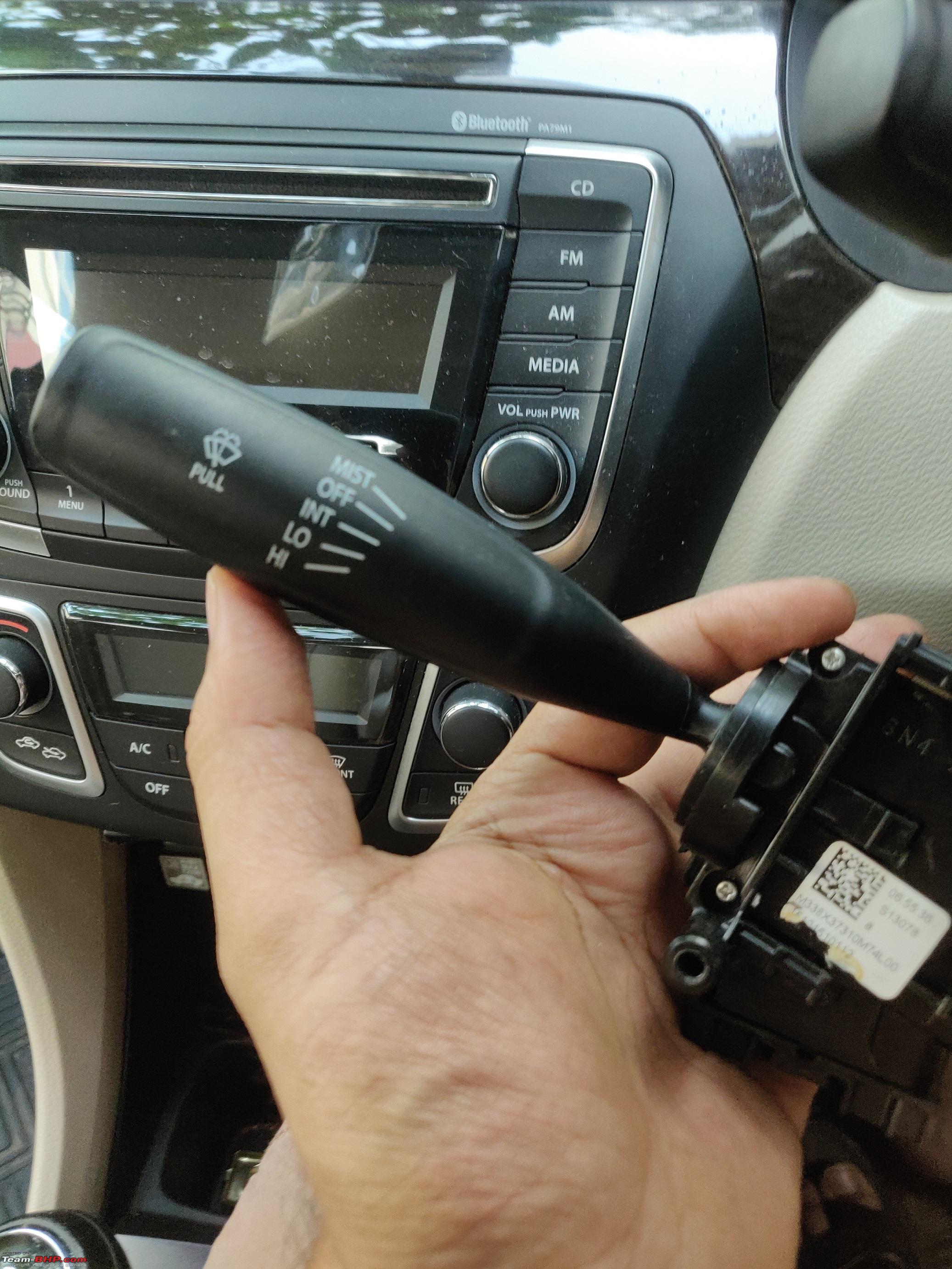

Anyway ordered one wiper stalk from Boodmo and got it today. Couldn't find the screws to remove the steering column shroud in my Gen 1 Ertiga. Planning to take it to my regular FNG.
Will update once I get it done.

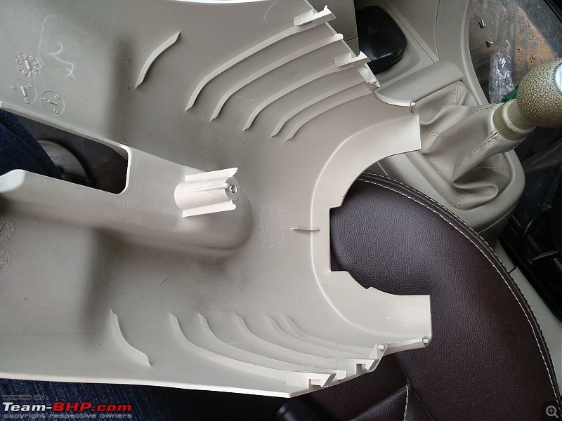

Update
Actually I don't have much to add over the pics and steps mentioned in the first page.
The lower trim is to be removed first after removing the screw which comes underneath in the slot provided for the steering adjustment lever.
This has clips in four places. - Can be seen in one of my pics.
After removing this you can see the screws holding the top trim. Remove that, disconnect the switch, remove it.
Repeat the steps in reverse.
As mentioned earlier, the mode where the rear wiper just washes and wipes once when the end of the stalk is twisted towards you is lost.
You also don't get the rear wash wipe intermittent function.
Both are not much of an issue.

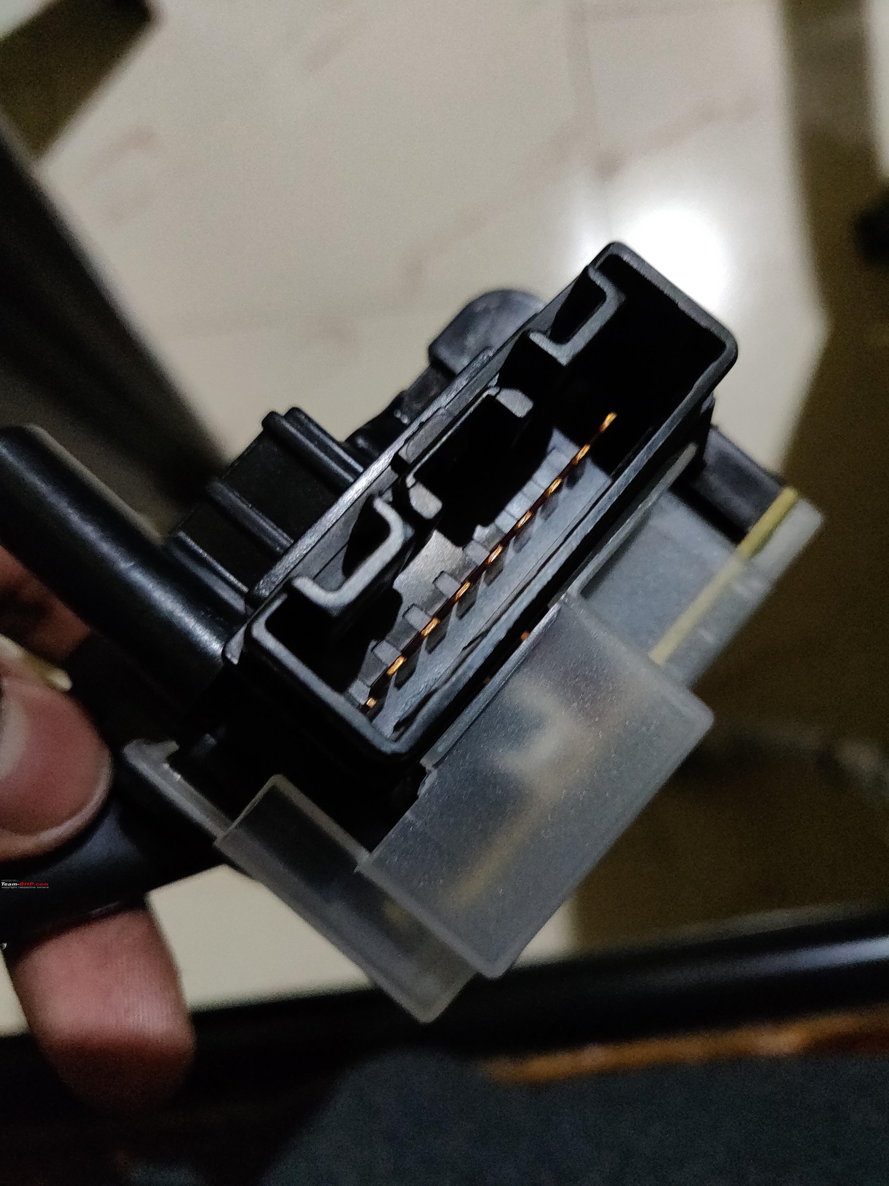

The actual install was a cakewalk. I finished it in 15 mins flat. No hungama. Here is a short pictorial description:
This is one of the most irritating things a car manufacturer could skip in their car, most of us would never check these small things while purchasing car and this would come back and bite us in Monsoon season. Heck even in top variant of Ciaz this was missing.
Thanks for taking your time to write this, i changed it sometime back, DIY was easy and everything works

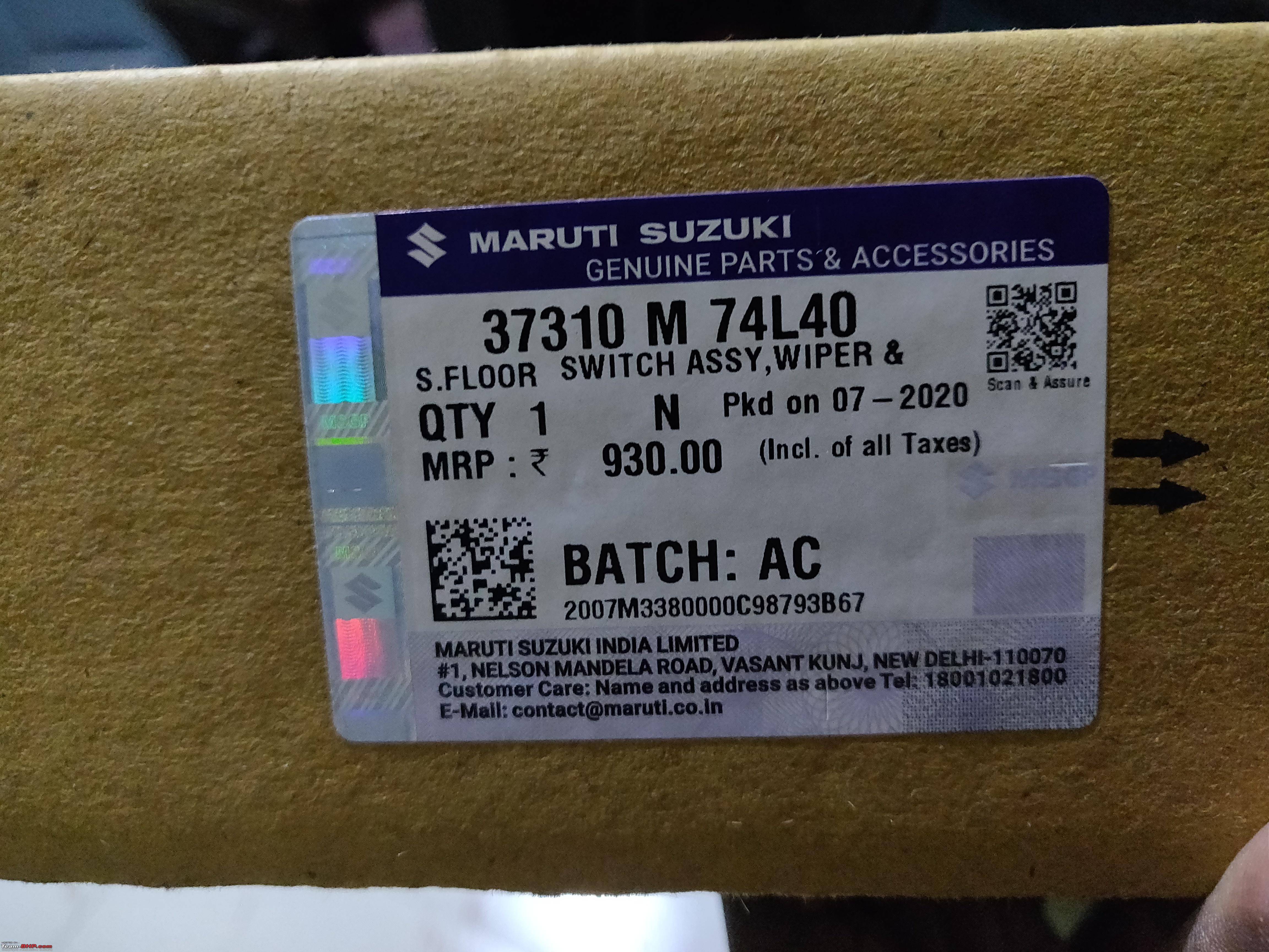

Tried fitting the S-cross stalk on my Baleno (Alpha 2020). Sadly it didn't work out. The connector and fitting are same but upon switching on the wiper fuse was blown. So removed it and compared the connections of both stalks (Continuity with multimeter) found out that they are different.
Will try installing it on the Ciaz later on.
Attachment 2047596
Attachment 2047597

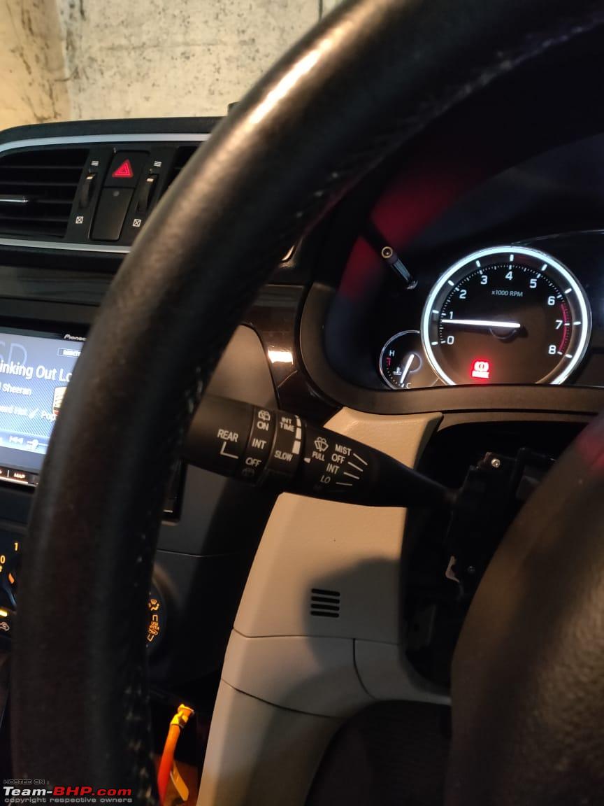

Update :
Successfully installed the same on Ciaz and working flawlessly.
DIY: Adding "variable intermittent wipers" to the Celerio & other Marutis-whatsapp-image-20201205-5.23.31-pm.jpeg
Had doubts about the rear washer/wiper button, like will any fuse blow or something is somebody accidentally used it. It seems nothing happen when it is turned
Its super useful during light drizzle. I had always felt the fixed intermittent speed of Marutis is a bit too fast, this resolves that perfectly.
Too bad it couldn't be fitted in the baleno. The entire circuitry is different in both (except for the connector part)
