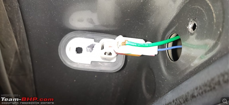

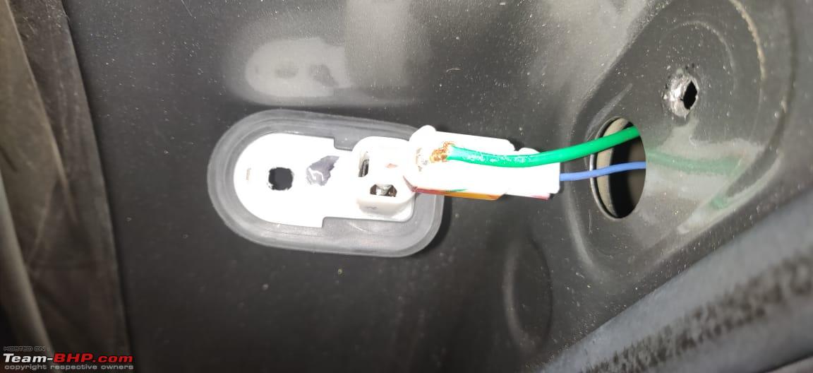

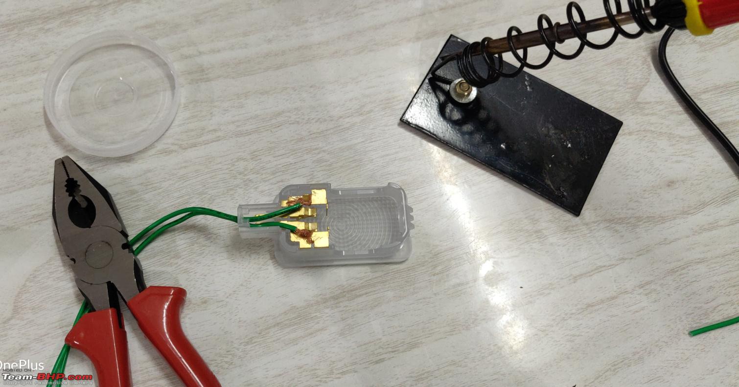

Wiring-
I've used a Havell's 0.75sqmm wire for all the wiring. The wires were soldered onto the points of the lamp. I did not order the wiring harness because since this system is not in Brezza, I would have to cut and use the coupler, basically waste of money.
DIY : Fitting Puddle Lamps on my Maruti Vitara Brezza-img_20191009_114658.jpg
Before soldering.
DIY : Fitting Puddle Lamps on my Maruti Vitara Brezza-img_20191009_115428.jpg
After soldering and sealing with plastic glue.
After soldering the wires, I used liberal amount of plastic glue to seal all open contacts.

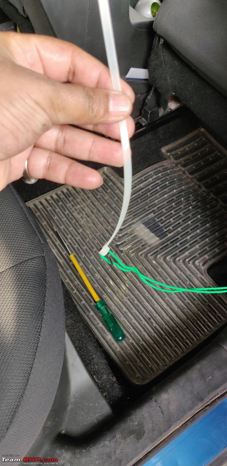

Routing the wires-
The rear gates have connection for the speakers, power windows and the locks. All these are routed through a rubber tubing. I saw a few videos on YouTube as to how I can route it through them. One of them advised to use a zip tie covered with oil or liquid soap to route it through the tubing and then pull out the wire. But before that, the speaker needs to be removed. It's held by 3 screws . Behind the speaker is the end of tube. The zip tie was passed through the tubing after using a liquid soap and wire was tied to it using another small zip tie. I must tell you this was so easy that I couldn't believe it. I was happy that I'll be able to do all the gates in a few sittings but I was majorly WRONG! Anyway, once the wire was passed out to the interior, I put it behind the panel that holds the seat belt.
DIY : Fitting Puddle Lamps on my Maruti Vitara Brezza-img_20191009_115523.jpg
Speaker removal.
DIY : Fitting Puddle Lamps on my Maruti Vitara Brezza-img_20191009_114719.jpg
The wire passed through a hole in sheet metal and routed to grommet tubing.
DIY : Fitting Puddle Lamps on my Maruti Vitara Brezza-img_20191009_114822.jpg
Wire passed through the tubing.
DIY : Fitting Puddle Lamps on my Maruti Vitara Brezza-img_20191009_114956.jpg
The zip tie used.
Since passing the wire through the rear door did not take more than 10 mins, I thought I'll do both the front ones in next sitting. So next day I started with front right side door. The lamp was fixed in same way. When I opened the tubing, I saw that there was no space to even pass a single wire as the front ones have a lot of wires going through it and they're routed through a plastic jack. I was stuck. Then after looking at many aspects, I saw there was a rubber lock on the lower side. I removed it. On the inside, there is a nut holding wires for earth. I removed the nut and was able to pass a copper wire through and through. Then the wire for lamp was taken out after making a small hole into the rubber tube and pulled out through that same hole, and then routed below the door sill to the B pillar area.

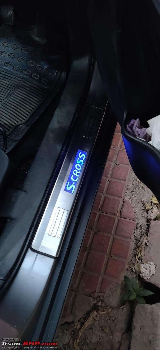

I also have a suggestion. I have installed led door sill plates and instead of taking a connection from the dome lamp, I have taken an always-on positive connection through a fuse tap in the fuse box and the negative through individual door switches.
This way, the door sill light comes on individually as per the door open rather than all being on/off even if one door is open.
It can be done the same way for puddle lamps as well.

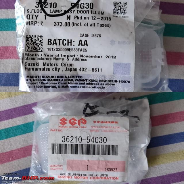

So when I wanted puddle lamps in my Brezza, I started with contacting the source / encyclopedia of Maruti spares Leoshashi. And he reverted with the part number of puddle lamps used in Ignis and Baleno in just a few minutes! I ordered 4 of them on Boodmo and they were sent separately from different locations. Cost was INR 1500/- for 4 including shipping charges.
Have a few questions for you-
1. Can I use the same parts that you did?
If yes, could you share the part numbers / Boodmo links?
Does this method have any cons?
This is the desired effect I was looking for.
1. Can I use the same parts that you did? If yes, could you share the part numbers / Boodmo links?
I guess so. There shouldn't be any problem.

Even the maruti genuine door sill plates works together as one unit and not with individual doors. I just worked it out myself and found it to be pretty good.
I haven't had any problems yet with the door sill lights. You should go ahead and try it.

DIY : Fitting Puddle Lamps on my Maruti Vitara Brezza-door-switch.jpeg
DIY : Fitting Puddle Lamps on my Maruti Vitara Brezza-door-sill.jpeg
