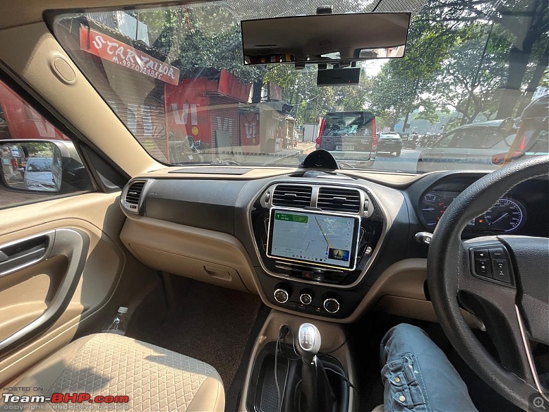

I was thinking of sharing same post, I have been using Samsung A8 tab in my Bolero Neo. (Purchased it from Dubai for 8000 INR)
I was not in favor of changing the stock system because I like the stock look (Personal Preference). So I decided to get a tab with sim slot and use it as infotainment system.
I used 2 magnetic mounts above the stock screen which looks neat when Tab is not attached to the dash, and I have the metal plates pasted on the tablet cover on top left and right side.
DIY: Get Android Auto in any Car/Bike for Free (or under 10k)-whatsapp-image-20240523-2.28.09-pm.jpeg
Magnet Mounts perform fantastic and has good hold, it has not given me any problem till now, on road as well as off the road.
Link: https://amzn.in/d/4F8lACy
I wanted to use the built in speakers, mic and steering mounted controls for my phone so I connect the phone to the stock system via bluetooth so I can answer the calls on the go.
I have a Pagaria bluetooth adapter for my tab which draws power from built-in USB port and is connected to the system via AUX cable, so I keep AUX source selected.
Link: https://amzn.in/d/eWLWLI6
This setup looks neat and clean and gives me a freedom of even sending a tab to back seat if my co-passengers want to take control of the playlist.
DIY: Get Android Auto in any Car/Bike for Free (or under 10k)-whatsapp-image-20240523-2.28.09-pm-1.jpeg
Pros:
1- Gives me full freedom of using a tab instead of limited functionalities.
2- Very handy to use and can be easily passed on to the passengers at back seat.
3- With split screen I can use 2 applications e.g Youtube music, Google Maps.
4- Looks cool, and everyone likes the idea.
5- Stock look is maintained.
6- I can still use my phone with the built in system.
Cons:
1- Can not use the steering mounted controls to skip or forward the tracks.
2- Needs charging so the wire looks messy when it is charging, but I will be buying something like : https://amzn.in/d/9qE0b9L to solve the problem.
3- Being basic tab, the speed is SO-SO and not very good, but it is manageable because I don't expect multitasking on it.
4- No Apple Carplay. I would like to ask if there is a way I can use Apple Carplay on android tab?
5- Extra money spent on Bluetooth adapter and magnet mounts.
6- Need to have a data pack of it's own or hotspot
I know there are a list of cons, however, I am still happy with the setup and I would recommend it to whoever is interested.
