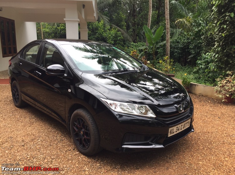

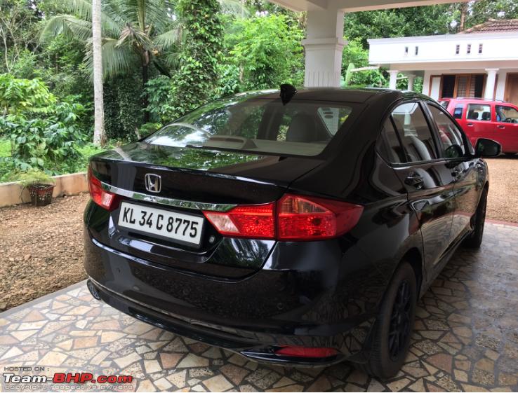

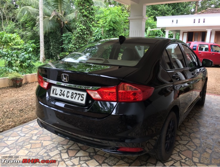

Below is my Honda City debadged and front chrome grille painted in piano black.
Looks like a perfect Gangsta car now pavi
Somehow, I just love An All Black Sedan with a glossy finish. I think, the only thing that is probably sticking out are the headlights.
You may probably want to smoke/tint it up to complete the look.
Vik0728 is offline   (1) Thanks
Old 8th February 2019, 16:43   #235
Join Date: Sep 2018
Location: Cochin
Posts: 1,062
Thanked: 2,063 Times
Re: DIY : Debadging your ride
It has been like this for 2+ years now, completed 4.5 years and 75,000+ kms (mine is i-vtec SV MT). Just saw this thread now, hence uploaded the pics. I may go for smoking taillights, but I am not sure about the headlights.
Attachment 1845989
Attachment 1845988
Looks really good. Can you please share how you did the rear? Also, mine is the red colour. Any suggestions on what to do for the grille?
Some good thread to remove the decals and a sweating session with Amway silicon glaze polish to remove the glue residue. There would be a better option to remove the glue which other members might have tried.
Regarding the grille, I think it would be better not to touch it. I am not able to imagine how it looks if gloss black painted. May be you should try some trial and error cases with photoshop.
