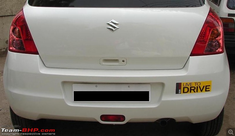

Here is my car's DIY "re" badged rear!
DIY : Debadging your ride-08052010244.jpg
DIY : Debadging your ride-08052010245.jpg
DIY : Debadging your ride-08052010246.jpg

Originally Posted by prince_pervez View Post
Talk about De-badging, Hows Re-badging.
Look!
Wouldn't it have looked cooler if you'd have done the S-W-I-F-T part just above the Suzuki logo
Attachment 345044
Attachment 345045
The "sports" badge looks really nice. Can you please share from you sourced it and how to fix it.
