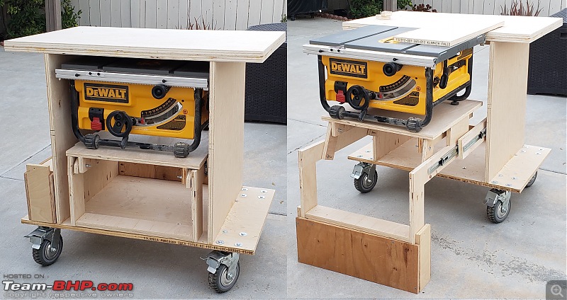

Hey DIYers, I recently built a cart for my table saw. The saw slides out and rises to the height of the workbench. In this config, the workbench serves as an out feed table. I have added a bench vice to the back of the cart and few other minor mods after taking these pics.
It has been super easy to setup and start ripping large pieces of plywood. Thanks to this cart, I built a utility cabinet in the laundry room in one weekend flat.

Must say, that's a smartly designed item! Very practical layout. How about covering the ply with laminate or some similar material on key surfaces? Will protect the panels a bit against silly splashes/age wear perhaps?
Absolutely! All surfaces have a polyurethane clear coat. After I took this picture, I have added another coat on the top surface/work area.

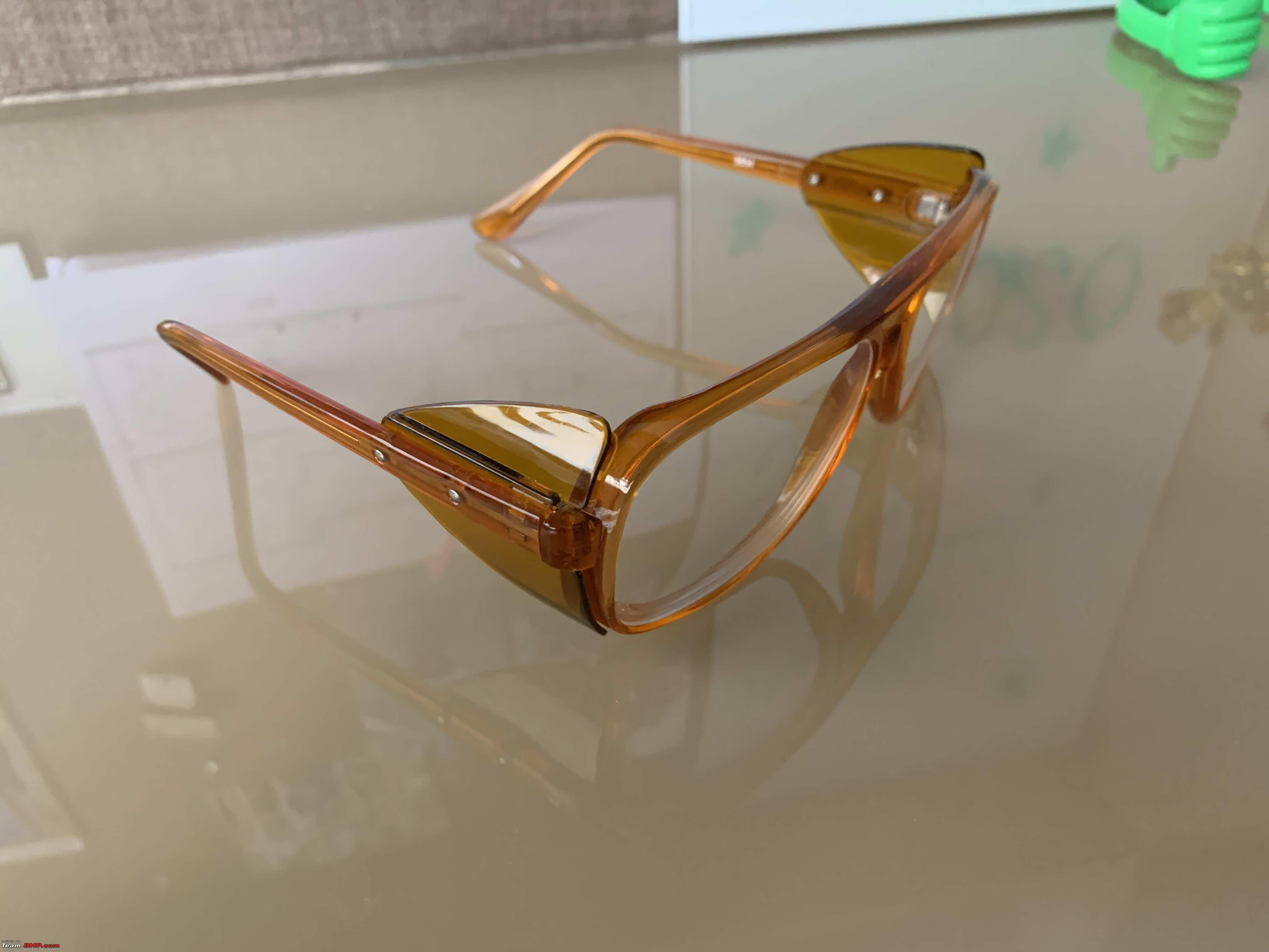

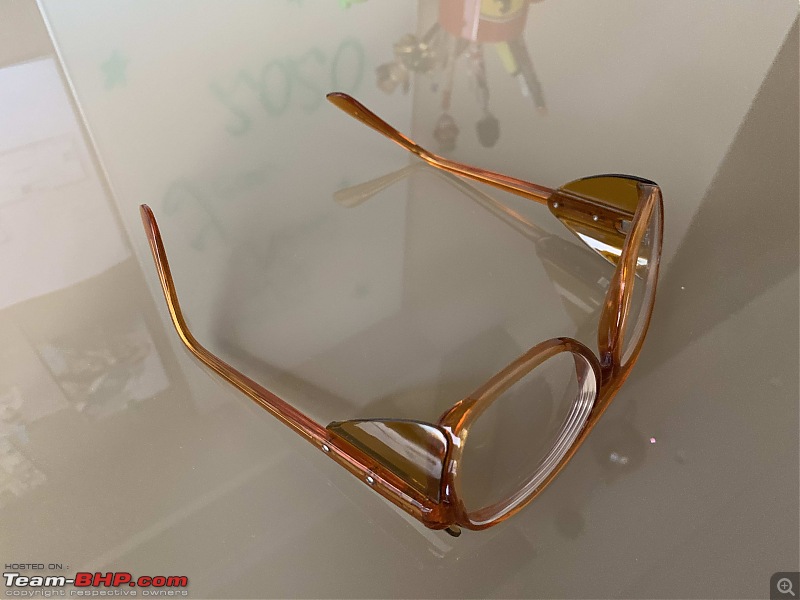

For those using prescription glasses and have an issue wearing a second layer of safety glasses on top.
Found an online seller selling prescription safety glasses.
Bought a pair and I'm very happy. Polycarbonate lenses on them and super fast delivery.
https://www.himalayaoptical.com
PS: I have no commercial deal with them.
