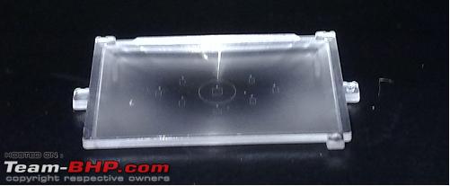

Well was trying to clean the viewfinder because I saw some insignificant dust particle on it, opened the DSLR, I mean just the lens not even all or any of the screws, just below the "penta" is this part, (guess its the focusing plate or some such thing)
used a brush to wipe of the dust Woah ! its clean, turn the cam on and the red focusing dots are all over the place. What just happened ?? Kaboom.
I'm at the Canon Service Center on Brigade Road with a bill of Rs.1361/- :)
Lesson learnt invest Rs 20 on a bulb blower and DSLR isnt a your car for "DIY Project" unless your really hands on with it.

Yes, that's the focusing screen of your cam. I had taken apart mine a couple of times and cleaned it. Never had any issues after putting it back. May be you didn't reassemble it perfectly. There are guys who removed their Sony focusing screen from their Alphas and replaced the same part from old Minolta SLRs which is believed to be better(?)
