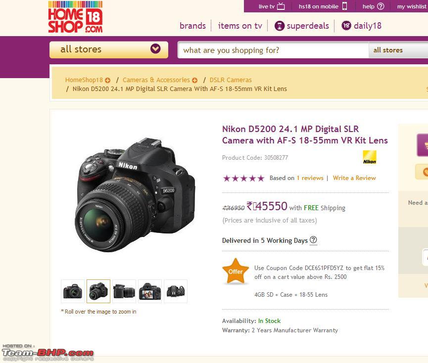

Glad you posted these great photos. I am soon purchasing D5200, so the photo quality is encouraging. Can you please list the lenses used for these photos?
Ajay,
It's a good camera. I'm very happy with the purchase.
I've used the kit lens - 18-55mm Nikkor lens & 70-300VR Nikkor lens(Tiffin UV filter) for the above pics.
If you are willing to buy ONLINE, please check www.homeshop18.com they have flat discount of 15% as of today. Price for today is 38717 INR. That's a very good price for the camera. This offer is valid only for today, wish I had got this deal ;-)
If not, try www.pepperfry.com (they have 1000Rs off on 41485 INR).
