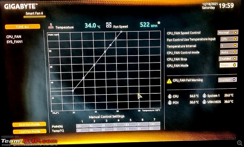

And re. the fan, I do not want to turn the fan off etc. - I have no technical expertise in doing such things and managing such things. I just want a fan that will run quieter by itself without my having to tweak anything.
If redistributing the budget allows you to invest in a 3rd Party CPU cooler, then that would allow quieter FAN speed or even full off mode. Entry level Coolers are like Rs. 1k (incl FAN)
It's simple with Modern BIOS, you would only need to set the temp:fan speed graph.
Here is an example with H510 motherboard BIOS with Intel Core i5 11400.
Building a cheap, slow & less powerful Home NAS (network attached storage)-001.jpg
3rd party CPU Cooler Heat sinks are much better than Intel stock cooler and the FANs are way more efficient so with little bit of tinkering with the temp : (FAN) speed graph in BIOS, you can achieve a really silent system.

Usually when I upgrade my workstations, I move my older one as a DIY media server for the home theatre/Plex server for my social circle/NAS appliance. Right now, I have an older 8th i3 with 16gigs of RAM and a 30TB redundant array of drives.
I try to be eco-friendly so it's sleeping most of the time. When I do want access, I have a Raspberry Pi Zero W that runs a custom, super tiny web facing app that I can use to remotely wake my server.
Been using the roughly same setup for the past 7 years and I couldn't be happier. Instead of building from scratch, my recommendation is to find hardware that's a gen or so older.
Straight up, a NAS isn't going to saturate your CPU, and even with something like Plex that transcodes in real time, you're not really using all that much computing power. Find older hardware and give it new life.
