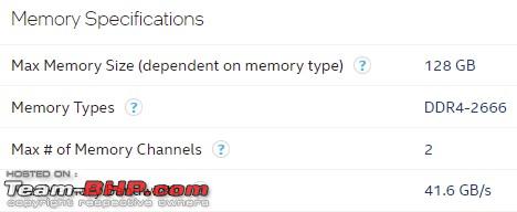

Old 29th May 2022, 20:15   #65
Join Date: Mar 2017
Posts: 568
Thanked: 2,088 Times
Re: Building a cheap, slow & less powerful Home NAS (network attached storage)
Hello,
Originally Posted by tilt View Post
Purely out of curiosity is DDR4 required?
Yes, DDR4 is mandatory with the selected processor. DDR3 is no longer supported by any new processor or related motherboards.
Refer here -> https://ark.intel.com/content/www/us...-4-10-ghz.html
In case you do want to utilize your unused DDR3, start looking for a 2nd hand PC. Purchasing it from market doesn't make much sense due to the high prices so look for anything within friends and family. If anyone has anything unused gathering dust.
Thanks.
NaXal is offline   (2) Thanks

3. Does anybody have experience with hardware transcoding? The GTX 1050 has NVENC chip and as per this page can do at least 2 4k-1080p and 7 1080p-720p streams.
I am using a nVidia 730 for this job. Jellyfin is configured to use GPU for x264 and CPU for x265 jobs. But rarely you would need that. Especially when you are within your home network, Jellyfin client will direct stream and use your devices native playback capabilities (codec support) to play the file without any transcoding load in the server. For me, it's the HDD which becomes bottleneck when streaming those 80gb+ true 4K media files !! Apart from that, Jellyfin just fly within with home network. No matter the number of simultaneous streams.
Building a cheap, slow & less powerful Home NAS (network attached storage)-01.jpg
Transcoding needs come when or rather, if I need to stream via internet from my home server using a very slow client connection. If that outside client connection is very slow, like unable to play 1080p youtube, then only one may need to reduce the quality and force Jellyfin to transcode.
