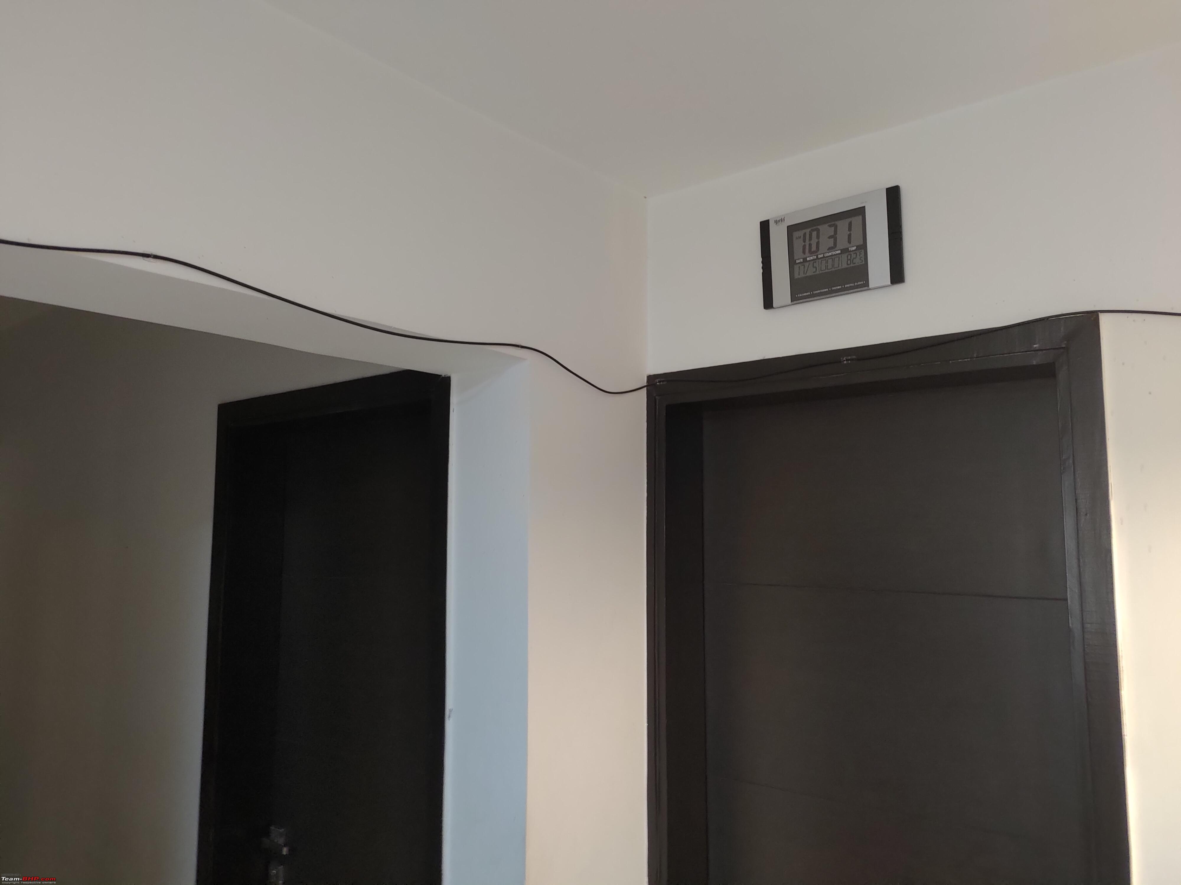

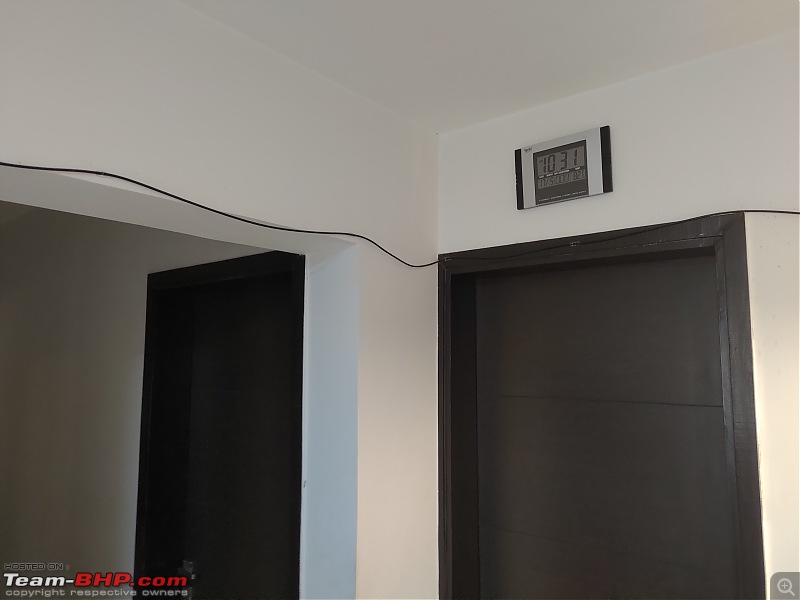

Originally Posted by manim (Post 5062354)
My deadspot-room is a long way and I have to wait for the lockdown to end so that I can call my electrician to punch holes in the walls and run the wire through plastic-pipes clamped to the wall around the outside of my house.
When schools reopened online last year, my home (a 3BHK) had 4 people doing online work. Since I was in the same boat as you I ordered two things off Amazon and installed them myself as a stop-gap arrangement (which is still going strong). These two:
https://www.amazon.in/gp/product/B0134QJH4G/
https://www.amazon.in/gp/product/B0084M66QS/
The installation looks like this. Ugly, but functional.

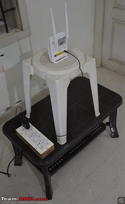

Originally Posted by NetfreakBombay (Post 5063002)
I do that with Airtel fiber. Its exactly same in this aspect.
After I receive my new router I'll experiment with various ways. I'm going to have fun!
Currently here is the Jugaad/Hack which works for me. The repeater(old-modem) sits outside the window of the room which is a deadspot. I get only about 15 mbps on my 100 mbps connection, but it serves my purpose for now.

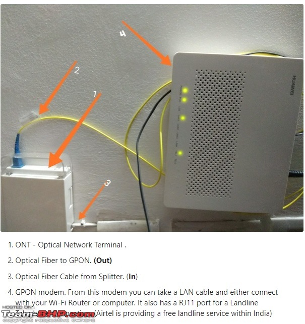

Originally Posted by Thad E Ginathom (Post 5063115)
What is the diameter of the airtel in-the-house cabling?
Do they terminate and plug direct to the modem, or via a box with a fibre flylead?
Cable is flat (4 mm x 2.5 mm). This cable cannot be connected directly to modem. Cables is connected to ONT, a different optical cable connects ONT to modem.
I've heard that they use a Nokia box which is good quality. And that the decades of modem are over and I will have to learn to call it an ONT --- Optical Network Terminal!
Just the terminology has changed. It is still a "modem".
ADSL : Splitter + Modem
Fiber : ONT + Modem

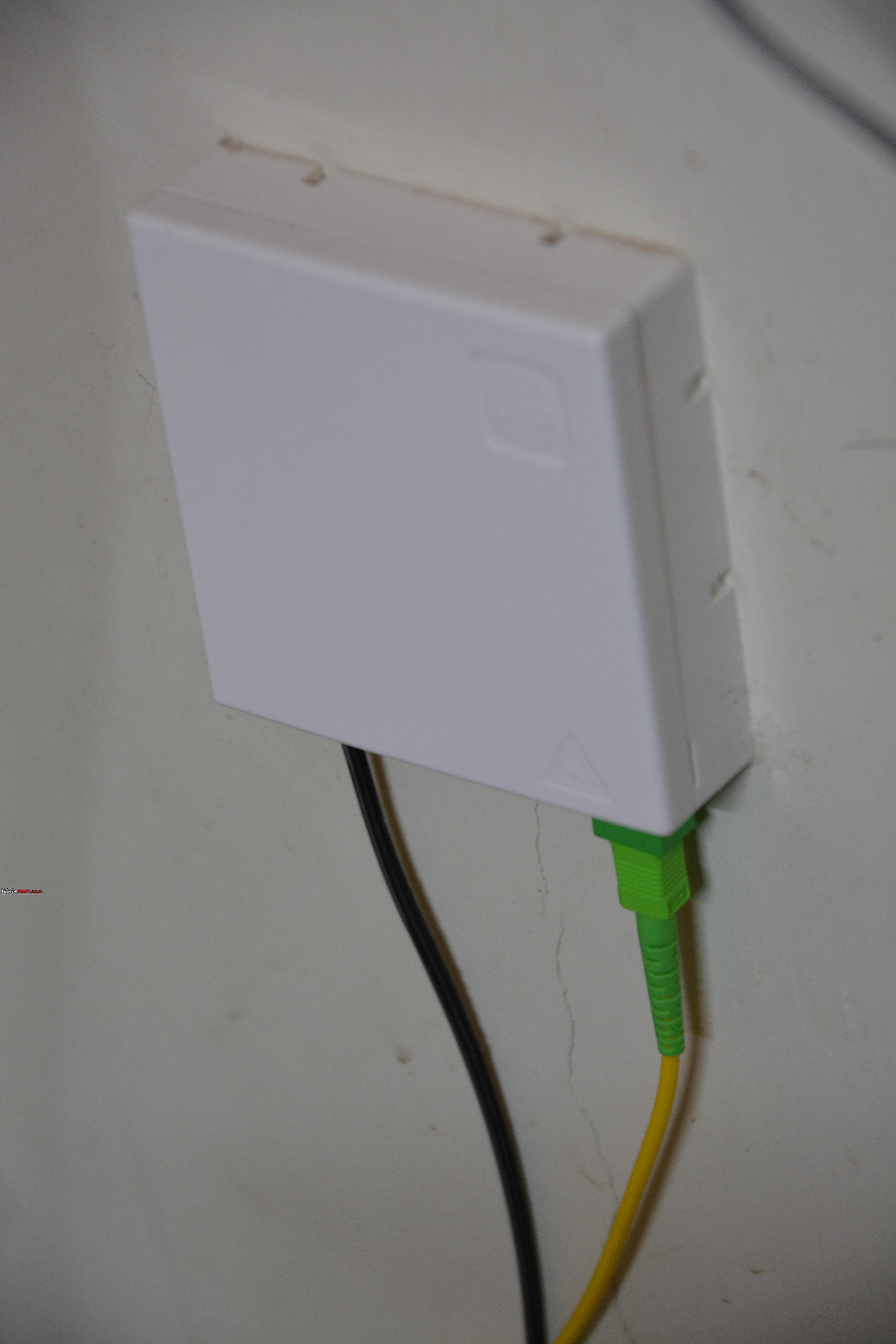

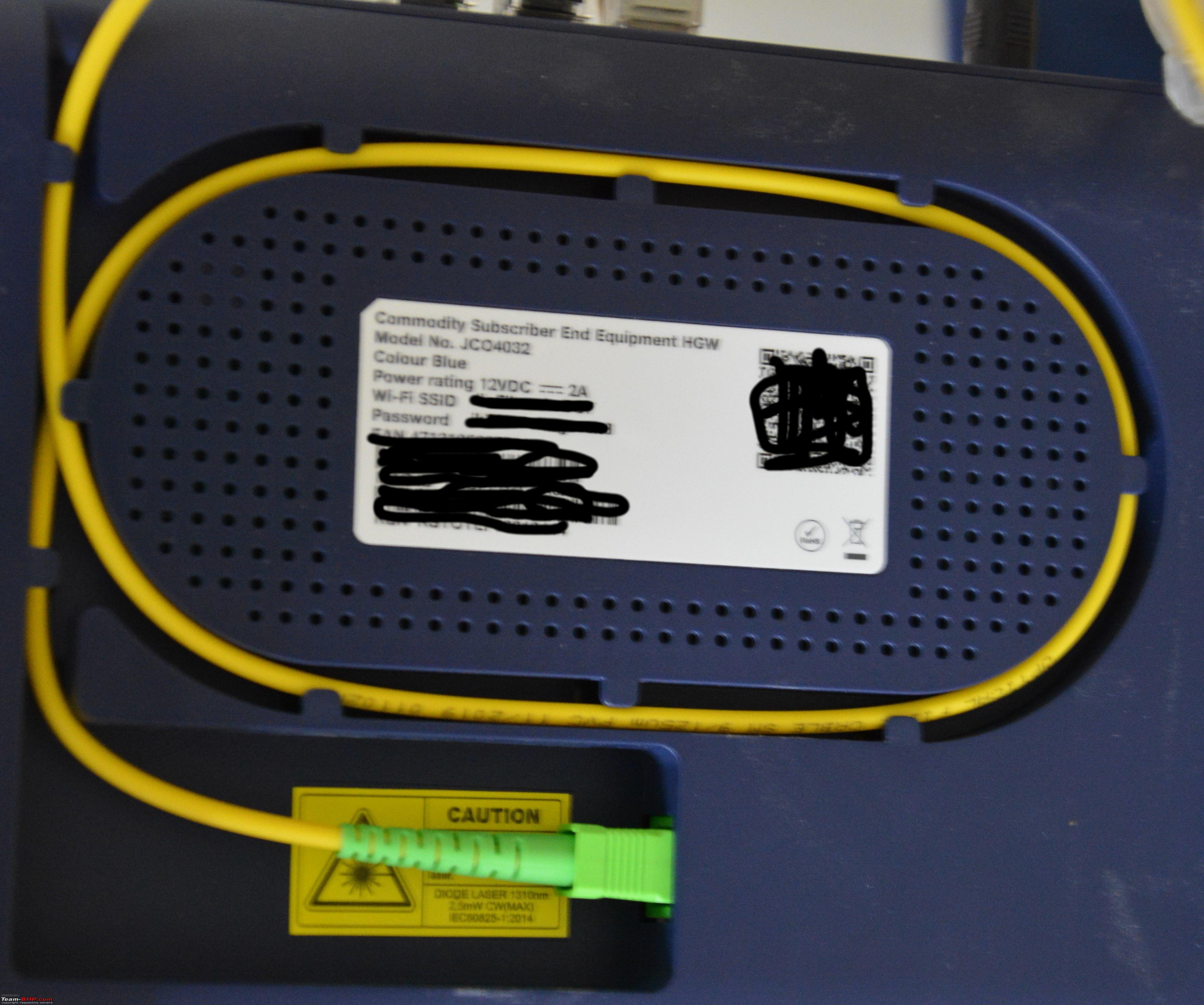

Here are photos of my Jiofibre connection (to add to NetfreakBombay's post):
1. Black-ultra-thin optic-fiber cable comes from outside as INPUT to 'box'
2. Green-plug with yellow cable OUTPUT from 'box' (goes to router)
3. yellow cable connects to router underneath.
The router has 4 LAN and dual-band WiFi outputs.
Jiofiber is a pre-paid service where I can choose my plan when recharging every 30 days.I am planning to try the 300 mbps next cycle, for the fun of it, it is Rs.1,769 (inc.tax) for 30 days (includes Netflix-basic as consolation, The 100 mbps plan costs Rs.825)
For me a 25 mbps connection is more than enough, I really am spoilt!
