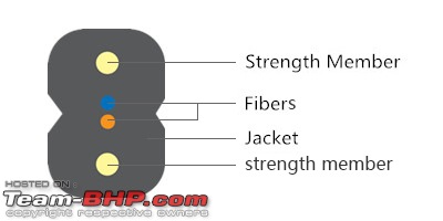

Originally Posted by Thad E Ginathom (Post 5063199)
I wonder why flat? Does it contain more than one fibre, side by side?
This is due to regulations. Unlike yellow cable, this cable has to be flame-retardant and has to meet building regulations in terms of rigidity, bend-tolerance etc.
It does have multiple fibers.

Originally Posted by NetfreakBombay (Post 5063700)
This is due to regulations. ...
Yes it modulates / demodulates ethernet frames into optical signal. ...
Wow, thanks for that. Such technology!
