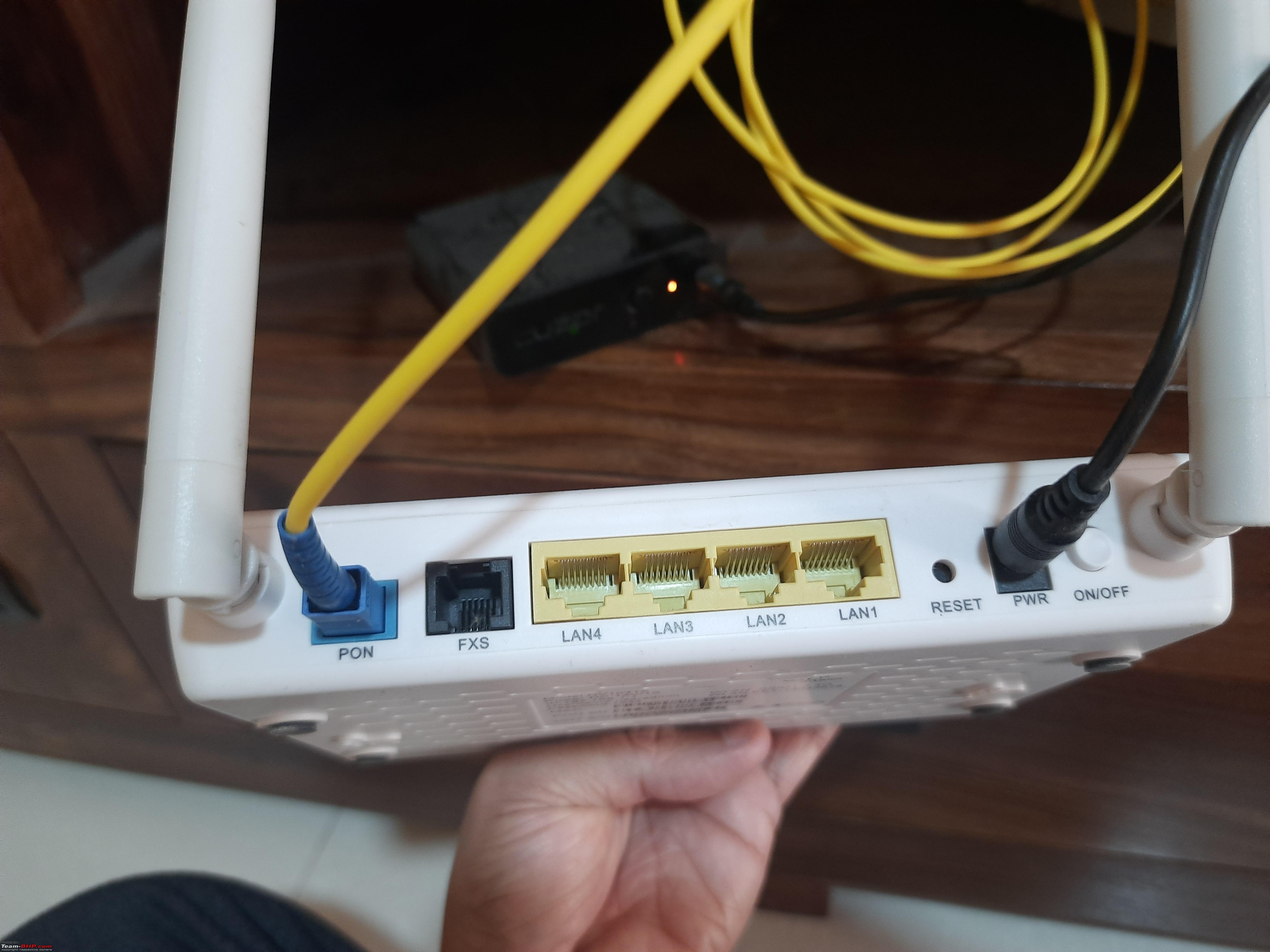

I have a local fiber-based net connection. I am looking to buy a new router. The current one is the one given by the provider.
Can someone please suggest which will be a good Wifi router to purchase?
I see a PON port to which the connection is made. I don't see such a port for a few TP-Link modems I searched.

Leave this in place.
Purchase any new router and connect it via LAN cable to this router.
Fibre Cable --> Existing Router --> LAN Cable --> WAN Port in New Router --> WiFi Devices

Will the performance of the existing router be a bottleneck in this setup? Or due to Lan cable, it may not matter?

Yes, due to LAN cable it would not matter but please ensure you buy a new router with gigabit ports.

Actually the performance does impact depending upon wether the lan cable is Cat5 or Cat5e/cat6.
I have done exactly same, i.e. connect the Fibre router provided by TATA to self purchased TP Link router (in another room to extend the range). But the wiring is concealed wiring inside the walls already done by builder and its difficult to change without opening walls. Unfortunately its Cat5 cable and I only get around 100 Mbps max speed (doesn't matter its 5.0 ghz or 2.4 ghz) from the Access point created on the TP Link router. But then, its ok for me.
One drawback of this approach is it will create 4 wireless access points (WiFi networks) in your home - 2 on the Fibre router and 2 on the Extender (TP Link). Not sure if disabling all wireless networks in Fibre router will disable the extender access point as well.
It does not matter (technically, each router will add ~1 ms delay). On the other hand, big advantage is support.
When there is an issue, technician will not be able to blame your router. You can show that net is working (or not) with existing router that is provided by them.

What is the main reason you want to upgrade? Are you unhappy with the PON side of it, or the Wifi capabilities?
Does your current router have 802.11AX/Wifi6? If you want a general upgrade- TPlink India sells couple PON - Wifi routers that may match your requirements - xx230v and xc220v
If you are only unhappy with Wifi capability, get a standalone AX Wifi router and connect it to the ethernet port of the existing PON router. If you want better Wifi coverage, you can hook up a Wifi mesh router, and hook it to the ethernet/LAN port of your existing PON modem. The advantage of this method is that if you move to a different service provider who uses a different PON modem or needs a Cable/DSL modem, you can use the same Wifi router.

I was having frequent disconnections that were not happening with my neighbors. I was about to get a new router but the provider has replaced the existing router for free now. Earlier he was not ready for this. So for the time being I will continue with this. I use a TP Link Extender along with this.
