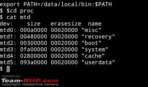

Another useful info for anyone looking forward to root the Desire
PVT4 has two types, with earasesize 20000 and 40000. As stated in my earlier post, Clockworkmod recovery will have problems in PVT4 Desires with erasesize 40000. Now how do you check erasesize? Just see the screenshot below.
It is in /proc/mtd file
Android Thread: Phones / Apps / Mods-mtd4.jpg
Obviously, mine is a PVT4 Desire with erasesize 20000. Hurray! I can root using unrevoked3 and install the default Clockworkmod recovery and the flash CM7.
If you have PVT4 with erasesize 40000, that means the Desire has got a newer NAND chip. Taking backups and flashing custom ROMs may fail with Clockworkmod recovery older version.
