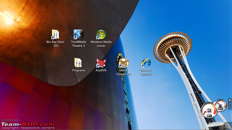

The desktop: Windows appearance and fonts tweaked for a comfortable
viewing from 10' away.

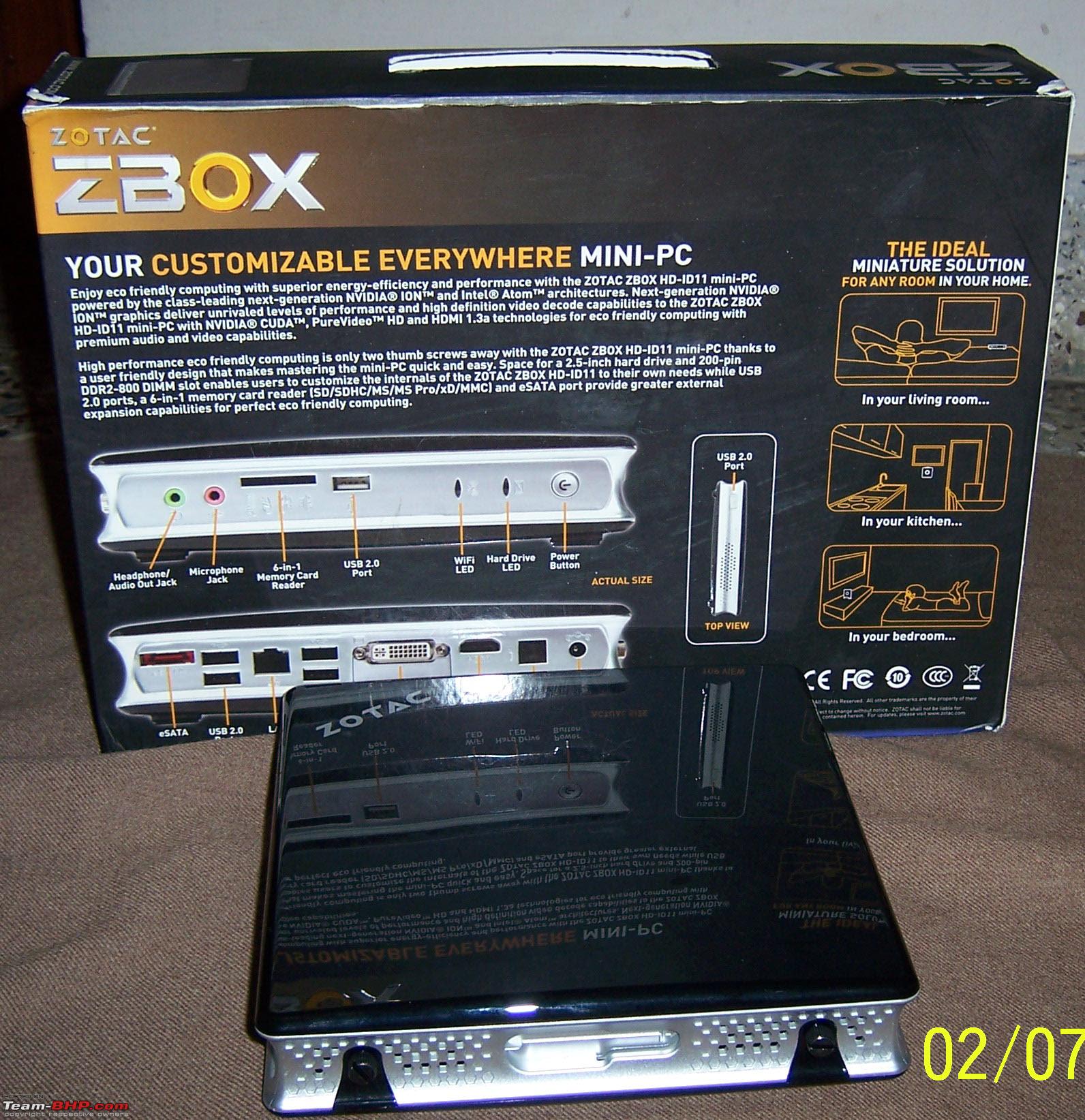

2. The box and the Zbox:

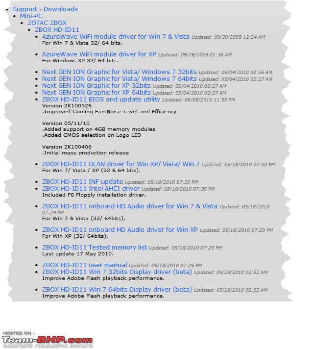

I had downloaded the Intel AHCI driver (included F6 floppy installation drivers) from the Zotac website alongwith all other Win 7 32bit drivers.
