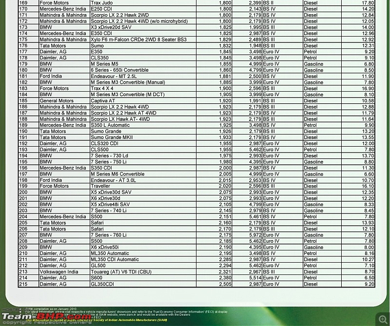

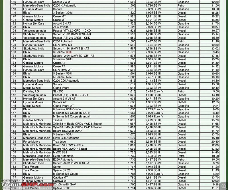

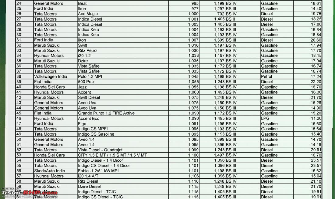

Here is the Updated Fuel Economy Data from SIAM - January 2010 which includes BSIV data.
For 4 wheel vehicles
SIAM / ARAI Fuel Efficiency Figures (Now with Jan 2011 Data - pg6)-imagessiam_fourwh11.jpg
SIAM / ARAI Fuel Efficiency Figures (Now with Jan 2011 Data - pg6)-imagessiam_fourwh12.jpg
SIAM / ARAI Fuel Efficiency Figures (Now with Jan 2011 Data - pg6)-imagessiam_fourwh2.jpg
SIAM / ARAI Fuel Efficiency Figures (Now with Jan 2011 Data - pg6)-imagessiam_fourwh3.jpg
SIAM / ARAI Fuel Efficiency Figures (Now with Jan 2011 Data - pg6)-imagessiam_fourwh4.jpg
For 2 wheel vehicles
SIAM / ARAI Fuel Efficiency Figures (Now with Jan 2011 Data - pg6)-imagessiam_twowh.jpg
Source: SIAM Website

That is a fantastic poster (SIAM FE figures). Thanks for posting. Actual FE may vary from this list, but it is indicative. They should also include the test conditions and procedure (there is nothing easily visible on the SIAM website about this)
It has all kinds of interesting info including the kerb weight, which are not usually advertized by various manufacturers.
- Indigo CS is 4kgs heavier than Manza Safire
- Figo variants are heavier than the Ikon

Also says at a place that Mahindra Xylo 4WD
Is that a typo or has Mahindra already tested and declared the 4WD info in advance??

Tata Nano runs on Gasoline whereas Polo runs on Petrol!? I'm confused.
Also, i10 1.1 F.E = 19.69 whereas i10 1.2 F.E = 19.81!!?? Looks like Shahrukh Khan did the fuel efficiency test to prove his theory

Petrol Verna Mileage.
The figure look really 'incredible' for the Petrol Verna. My cousin has a verna Petrol and even on highways when driven with a light foot he gets only 13-14 kmpl. We also have a fiesta tdci for which we get average of around 16-17 for city + highway. For the fiesta just plain highway might come close to 20 but that would mean really really restrained driving which is focussed on just mileage. I have never got that kind of mileage when i have driven.
Most of the Hyundai vehicles' FE figures shown here are far above the actual values we obtain on road. Eg: i10 1.1 MT and AT. So don't worry about these gimmicks!

Top 3 spots go to Tata:
1. Nano - 23.62
2. Indigo CS - 23.03
3. Vista Qudrajet - 22.29

In the above list, s. no. 62 it says Fiat Punto 1.4 active, Fe 13.80 but Fiat never introduced 1.4 active. It has only 1.2 active in petrol.
