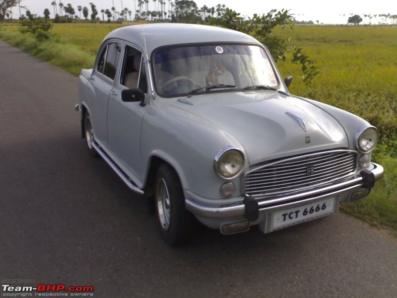

Congrats Mahesh, The car looks very beautiful. Though i prefer the old grill compared to the new one, the gypsy rims are fantastic fit and look. Amby is my all time favorite and even i have a crush to own one and do it up with whatever i need. I am even looking for a good old one to get and do a Isuzu in it.

Interesting ownership report of the Amby. You need to give her a darker shade which looks better on an Amby. Personally i dont like the frills, so i would have loved if it had the original cosmetic bits and no frills.

That front grille is a grave injustice to this classic beauty. Please put the original grille back.
TCT? You got this reg. number transferred from some older vehicle?

What do you have behind that grill? In Coimbatore you should get better thicker steel mesh work done. It'll look much more sleeker.

No wonder you face over-heating problems, please get rid of that hideous grille.

@Drive3R : But the heating problems are there from my old grill time itself.Even i have removed the grill and tested by driving around 200 kms and found the heating still there.
@download2live : TCT is Tuticorin Registered.The car has been altered,The front right and the dick has been changed before 12 years,becoz of our driver slept and met with an accident.
@Rudra : There is an electric fan behind that grill.I have altered that grill because of this fan.Since when i fit the fan with the older grill,The grill is standing almost equal to the bumper in front.The chrome polish was not perfect for the lines in the grill.I thought of correcting it while at the time of painting.
