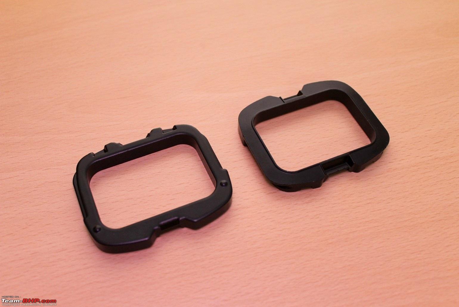

You cannot use the stock mount for mounting the anti-dazzle IRVM. You need to glue the metal mount in the windshield - either over the stock mount (in which case you cannot use the rain-light sensor unless you take out the stock mount and clear the black patch by scraping/sanding it) or below it (you'll have to remove the stock mount or leave it as it is which may be an eyesore depending on how you see it).
This is the mount:
VW Polo GT TDI ownership log EDIT: 9 years and 178,000 km later...-mount.jpg

Thanks Gannu Bhai,
One more query is that you have shown the top and bottom sides in the image. Please let me know which one to fix towards the windscreen. Another point is that you have mentioned using glue to fix this mount. What type of glue needs to be purchased from the market?

I had purchased 2 mounts - one for mounting the mirror, the other for the RLS (which hasn't been used so far).
The right side of the image is the base of the mount that attaches to the windshield. You need to ensure that you use a proper glue for this. I had used Bondtite Fast & Clear for this. It has worked well so far.

Originally Posted by sunilsoft View Post
Please let me know for how long we should let the bondtite dry?
Bondtite dries up quickly in about an hour or so. You should use some masking tapes over the mount after it is glued to the windshield to hold it in place.
Is there an alternative glue for the same?
There may be but I am not aware of it. The OEM VW glue is a lot more expensive along with the primer.
