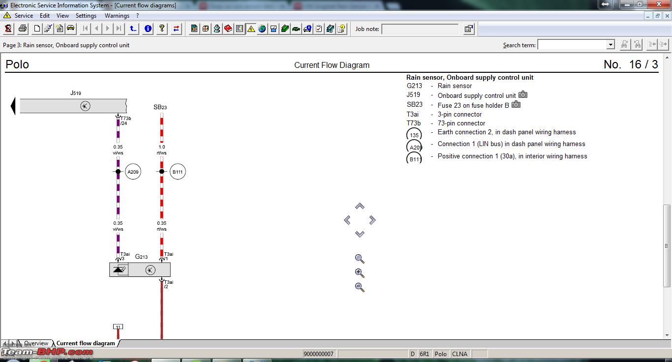

And I just figured out how the rain sensor works. And its very easy and inexpensive.
The current flow diagram:
VW Polo GT TDI ownership log EDIT: 9 years and 178,000 km later...-rain-sensor.png
Aliexpress has the kit for $28 (link) including the sensor, harness and the mount; I can ask my seller to offer a better price for it. The mount will have to be urethane-glued to the windshield and in case of a windshield replacement, only the mount goes with it; the sensor can be retained. But what I am really not sure if the effectiveness of the rain sensor - not sure if it works properly and adjusts the speed of the wipers according to the rain falling on the windshield. Will research a bit further and take a call.

I have a rain sensor on one of my cars, although it was factory fitted. Works really well!
