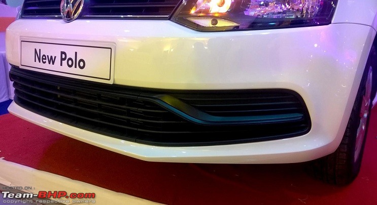

Hi Gannu,
Would you be able to help me identify location of clips to remove lower grill from the front bumper in Vento 2015 facelift.
http://www.team-bhp.com/forum/indian...ml#post3860794
Regards.

Originally Posted by antardaksh View Post
Hi Gannu,
Regards.
Sorry antardaksh, I've no clue about that. Best to ask the service center about it.

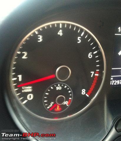

Your's is a TDI right?
Why does the redline start at 6800 RPM?
Please change the title of the thread if not updated.
landcruiser123 is offline   (1) Thanks
Old 30th December 2015, 09:32   #701
Crazy_Bean's Avatar
Join Date: May 2014
Posts: 415
Thanked: 267 Times
re: VW Polo GT TDI ownership log. EDIT: Gujarat >> Chennai!
His car is very much a TDi. People like Gannu don't mess up things like this
If you follow his threads, he installed TSi cluster on his TDi. Hope this answers.

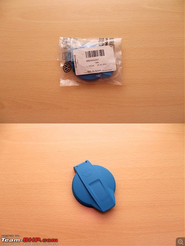

  • Audi’s windshield washer fluid reservoir cap:
    VW Polo GT TDI ownership log EDIT: 9 years and 178,000 km later...-1.-washer-cap.jpg
    VW Polo GT TDI ownership log EDIT: 9 years and 178,000 km later...-2.-washer-cap.jpg
    The stock cap:
    VW Polo GT TDI ownership log EDIT: 9 years and 178,000 km later...-3.-stock-cap.jpg
    This cap is used in a lot of Audi cars. And it doesn’t feel flimsy like the stock one either.
    Source: Friend through a Audi/VW spare parts stockiest based in Spain
    Part number: 4M0 955 267
    Price: 7 Euros
