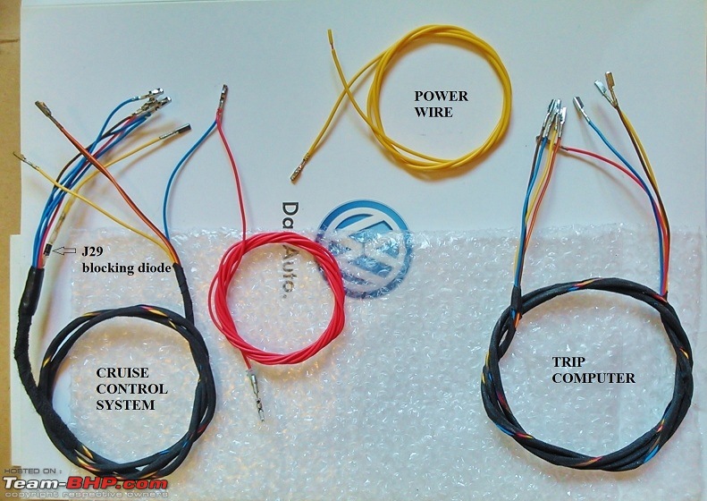

I plan to get cruise control installed in the car shortly and found a kickass deal for the stalks and the harness from Spain on the UK Polos forum. I knew the guy since we have interacted before. Made the payment over PayPal quickly, he shipped it the same day and the consignment is in transit as we speak. The good thing is, he had painfully made the harness all by himself by sourcing the required cables and terminals, soldering the blocking diode, crimping them and Tesa taping them. Thanks a lot man! Some snaps of the stuff inbound:
VW Polo GT TDI ownership log EDIT: 9 years and 178,000 km later...-stalks.jpg
VW Polo GT TDI ownership log EDIT: 9 years and 178,000 km later...-stalk-left.jpg
VW Polo GT TDI ownership log EDIT: 9 years and 178,000 km later...-sw-module.jpg
VW Polo GT TDI ownership log EDIT: 9 years and 178,000 km later...-sw-module2.jpg
VW Polo GT TDI ownership log EDIT: 9 years and 178,000 km later...-harness.jpg

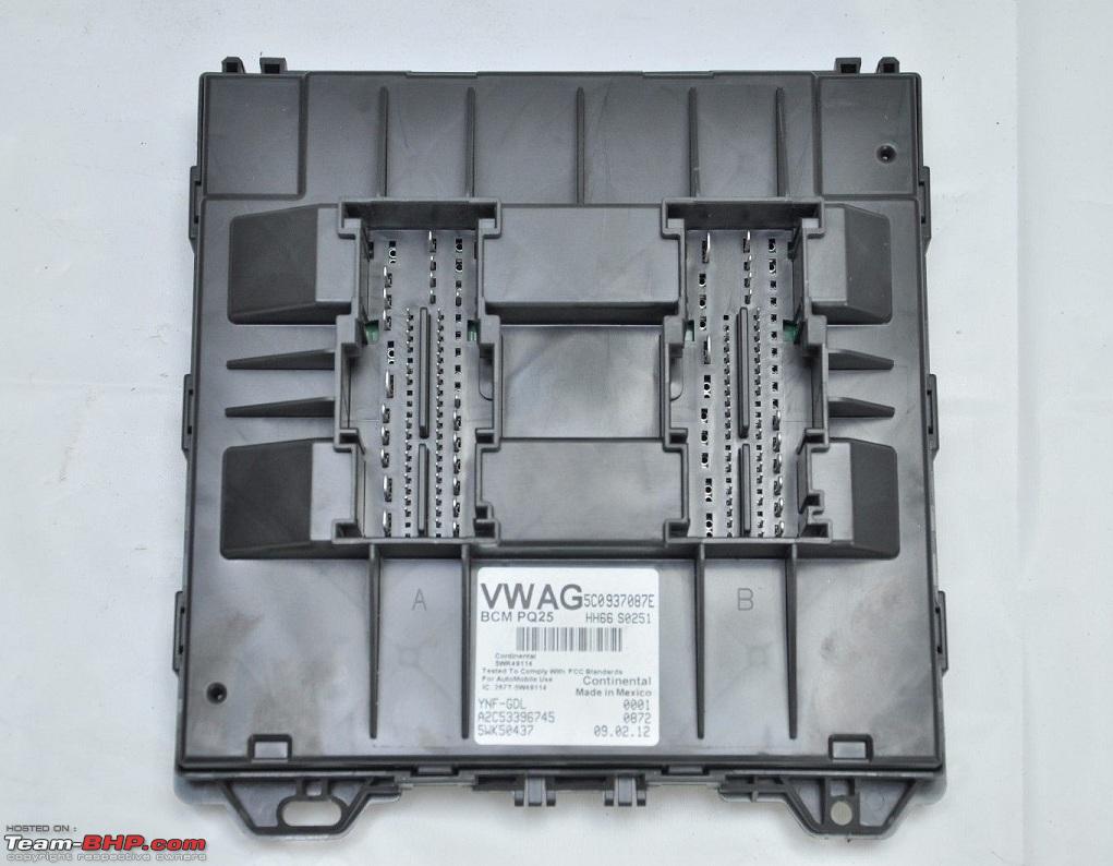

I have done the homework in the meantime and know what needs to be done to get cruise control installed and working. The main challenge would be routing the lone cable to the ECU’s connector through the firewall and that requires an anti-theft bracket of the ECU to be removed. FWIK, if it is removed, it will have to be renewed - will see if the service center here could be of help. But before all that, I need to change the stock BCM and there are quite a few deals online ranging from 7k to 14k shipped from the Europe whereas the dealership is quoting 29k! Yet to take a call on it.
Swapping the BCM is again easy - note down the long code from the stock BCM bit-by-bit (take screengrabs for each byte), disconnect the battery’s negative terminal, connect the new BCM, reconnect the negative terminal, transfer the previous code to this one and check each byte, adapt the keys and remove any errors. But the catch is, not all the highline BCMs with the code 087/088/090 work. The last letter on the BCM part number (e.g. 6R0 937 087 R) signifies the carrier frequency for the keyfob radio. In India, Eu and Russia - it is 434 MHz. In the US it is 315 MHz.
VW Polo GT TDI ownership log EDIT: 9 years and 178,000 km later...-bcm-last-letter.png
BCMs with 315 MHz radio carrier frequency ends with the letters A, C, E, G, J, L, N. These are usually manufactured by Continental at Mexico for the US and Canadian markets. Examples:
VW Polo GT TDI ownership log EDIT: 9 years and 178,000 km later...-087-c.jpg
VW Polo GT TDI ownership log EDIT: 9 years and 178,000 km later...-087-e.jpg
VW Polo GT TDI ownership log EDIT: 9 years and 178,000 km later...-087-j.jpg
BCMs with 434 MHz radio carrier frequency ends with the letters B, D, F, H, K, M, P, R, T. These are usually manufactured by Continental at Germany, Ireland and India for the Indian, European, South African and Russian markets. Examples:
VW Polo GT TDI ownership log EDIT: 9 years and 178,000 km later...-087-r.jpg
VW Polo GT TDI ownership log EDIT: 9 years and 178,000 km later...-087-k.jpg
The radio frequency is also indicated inside the key:
VW Polo GT TDI ownership log EDIT: 9 years and 178,000 km later...-key.png
So those who are planning to upgrade their BCMs, keep this in mind.
That would be all. Let’s see how the new tires hold up. Looking forward for our trip (while getting equally nervous about it!).

VW Polo GT TDI ownership log EDIT: 9 years and 178,000 km later...-img_20150809_123621.jpg
Originally Posted by ventoman View Post
I've also procured a Cruise control Stalk from ebay Germany. My part number is 6R0953521B, as I wanted one without DIS (they are now integrated to Steering wheel). I'm awaiting the wiring harness for this kit from Aliexpress and once arrived, planning to get them fitted (expected in this coming week) at FNG or Bosch workshop nearby. I'd be grateful if you can provide some pointers around this.
Saw that you’ve already contacted Fernando. In any case, these are the connections and the pin numbers where these cables should be inserted/replaced:
VW Polo GT TDI ownership log EDIT: 9 years and 178,000 km later...-612.jpg
VW Polo GT TDI ownership log EDIT: 9 years and 178,000 km later...-810.jpg
VW Polo GT TDI ownership log EDIT: 9 years and 178,000 km later...-710.jpg
I haven’t attempted this modification yet so cannot comment on it any further. Do check if the harness from Aliexpress has the blocking diode. Else you will have to solder one as per the current flow diagram. The diode prevents the malfunction of the CCS SET button. The pin number for the ECU varies from engine to engine - I am not sure what it is for the TSI engine; best wait for his input. Good luck!
Thanks again Gannu.
Looking forward to your DIY on this. I'm also trying several sources regarding the wiring for TSI. **fingers crossed**
