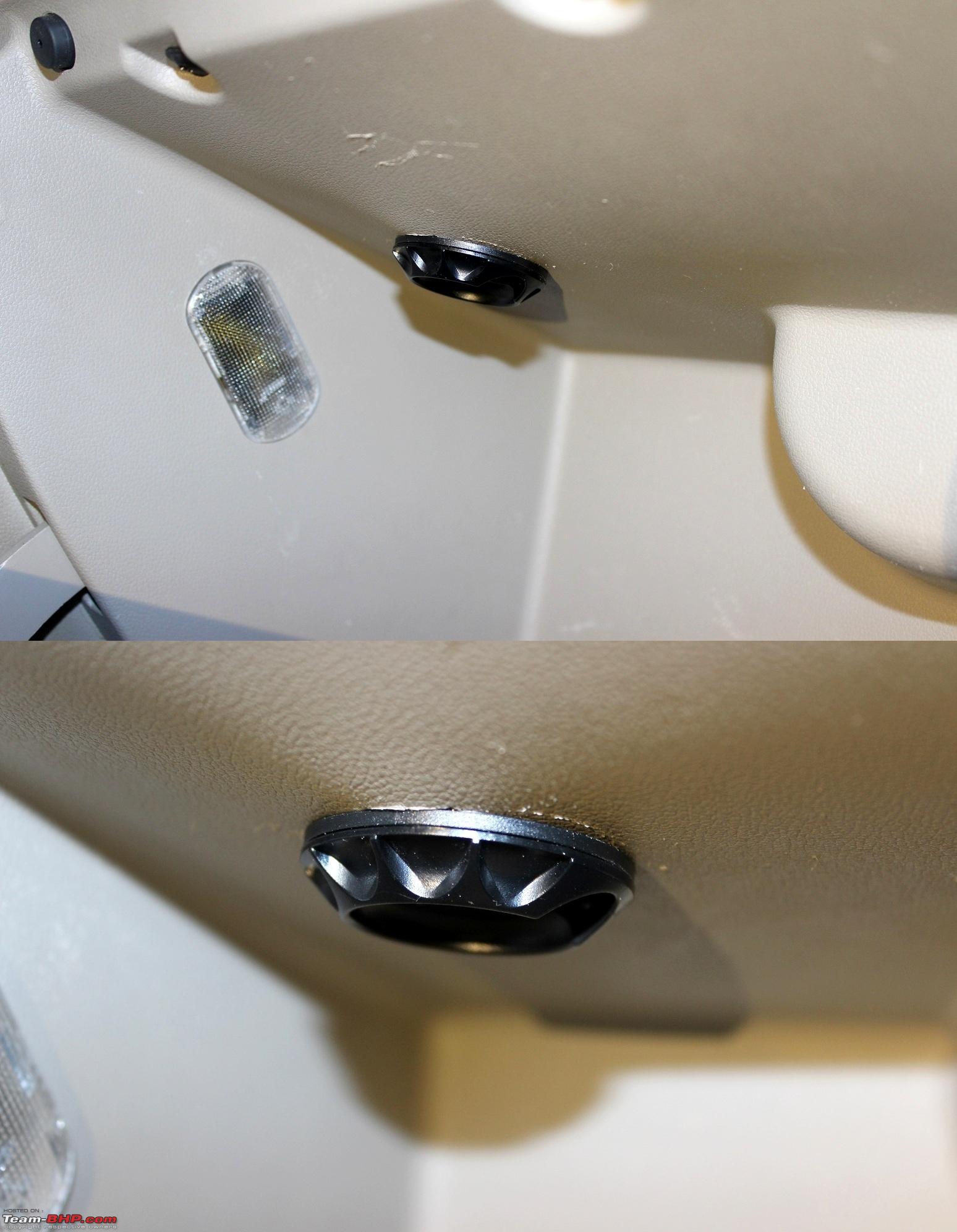

2. Glovebox cold air supply valve:
Added this one since it was cheap and doesn’t involve much efforts:
VW Polo GT TDI ownership log EDIT: 9 years and 178,000 km later...-gc1.jpg
VW Polo GT TDI ownership log EDIT: 9 years and 178,000 km later...-gc2.jpg
To be brutally honest, this is going to be just another novelty feature. The valve was cheap at 2 GBP (approx. 200 Rs) so ordered it. Drilled a hole on the co-driver side vent duct, cut a hole on the glovebox and connected a plastic hose after sealing the mating edges. Pretty sure, I am never storing a water bottle or Coke can inside the glovebox - not with those car’s documents inside! Shall add this DIY on the existing glovebox light DIY thread later.
Part number: 1Z0 816 355 9B9
Source: www.skodaparts.com, UK
Price: For parts 1 & 2 combined, 31.13 GBP.

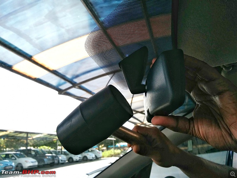

4. Auto-dimming interior mirror:
VW Polo GT TDI ownership log EDIT: 9 years and 178,000 km later...-ir1.jpg
VW Polo GT TDI ownership log EDIT: 9 years and 178,000 km later...-ir2.jpg
Knocked the stock mirror off the slot using a mallet:
VW Polo GT TDI ownership log EDIT: 9 years and 178,000 km later...-ir3.jpeg
FOV (field of view) has improved. A comparison pic (not the same location):
VW Polo GT TDI ownership log EDIT: 9 years and 178,000 km later...-ir4.jpg
Works beautifully in the night by dimming the mirror when the sensor senses the high beam from the trailing vehicles. There is a sensor at the rear of the mirror as well. I had plans to install the VW OEM auto-dimming mirror with the rain and light sensor (installed in the Jetta and Passat; the Polo that retails overseas has this mirror as an optional upgrade) but every time the windshield has to be replaced, this sensor should be replaced as it is stuck to the windshield using an epoxy glue and the sensor costs quite a bit! Dropped the plan when I had to change the windshield when it cracked 2 months back. The seller also shipped a plastic cover for hiding the cable (shown in the foreground of the first image) but I didn’t use it since the cable was neatly routed to the ceiling headliner.
Price: 70 USD
Source: Aliexpress, China (shipped via HK Post)

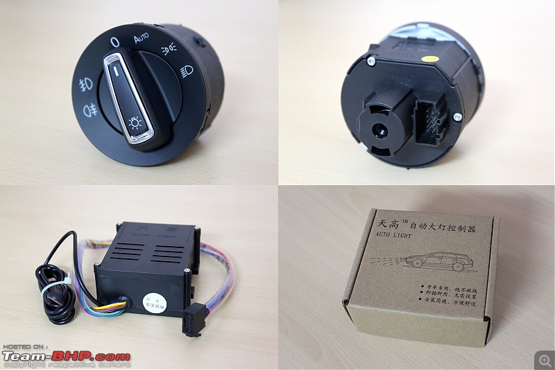

7. Auto-headlight sensor module and the Golf Mk7’s headlight switch:
VW Polo GT TDI ownership log EDIT: 9 years and 178,000 km later...-al.jpg
The build quality of the switch is good - no part feels flimsy or built loose. The sensor (an LDR - light dependent resistor, basically) is located above the dashboard at the bottom of the driver side A-pillar.
Coming home lights - with the switch set to Auto, remove the key from the slot and the headlights, tail lights and number plate lights are turned on for a preset time:
Leaving home lights - unlock the car and if the surroundings are dark as sensed by the light sensor, the lights turn on:
Gotta love this tiny little module that converts a regular switch to the Auto module along with the coming-home and leaving-home options. The more expensive way to do this is to upgrade the BCM. This has nothing to do with VCDS and the sensitivity can be adjusted using the switch itself. This system is independent of the BCM and no setting can be changed using VCDS.
Part number: 5ND 941 431 E XSH (for the headlight switch)
Price: 70 USD (shipped via HK Post)
