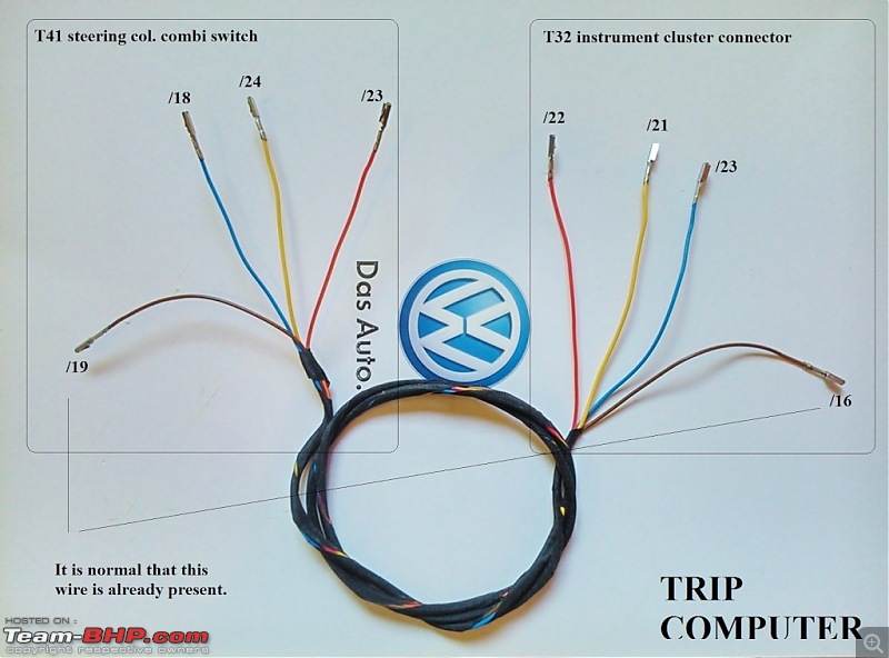

Is this the kit you have ordered? You need one which has the right stalk without the TRIP and OK/RESET buttons since you have these on your steering now. Not a big deal though since both the set of buttons would work but if you use the ones on the stalk, the steering ones would not work until you turn off the car and turn it on.
Originally Posted by frankmehta View Post

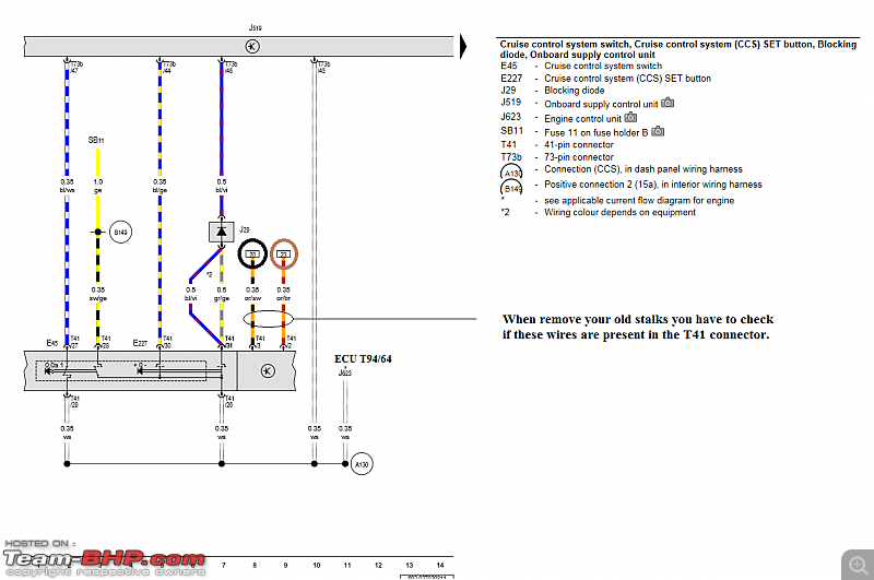

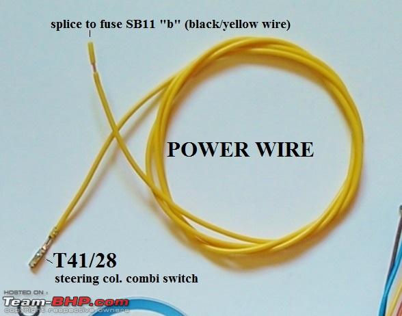

It might be easier in mine, as I just need to pull 4 wires and install them in the BCM (i have the TSI so I should be having the 087 model) and other 4 wires to the fuse box.
There's only 1 cable that goes to the fuse box for the power. Are you sure you have the ECU cable in place? And the ones that go to the instrument cluster?
Anyways this is how the wiring goes and the current flow diagrams:
VW Polo GT TDI ownership log EDIT: 9 years and 178,000 km later...-612.jpg
VW Polo GT TDI ownership log EDIT: 9 years and 178,000 km later...-810.jpg
VW Polo GT TDI ownership log EDIT: 9 years and 178,000 km later...-710.jpg
VW Polo GT TDI ownership log EDIT: 9 years and 178,000 km later...-1.png
VW Polo GT TDI ownership log EDIT: 9 years and 178,000 km later...-2.png
Hope this helps. Good luck with the installation and keep us posted!
