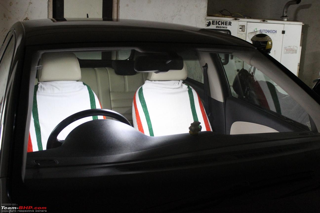

2. Philips X-treme Vision W5W LEDs:
Previously, I was using these el-cheapo W5W LEDs sourced off Aliexpress on the cabin light. While they were good for the price they retailed for, they were emitting a white light with a slight bluish tinge and the brightness was a little less. Sourced a pair of these Philips X-treme Vision LED 360 6000K off Powerbulbs UK (link) with a 20% discount coupon applied and man, these are insanely bright! And emits a neat white light without any shade of blue. I did not regret paying 25 GBP for 2 pairs of these babies. Received them in less than 10 days and the packaging was good with sufficient bubble wraps. They are made in China (if that matters) but the free W5W Osram bulbs that Powerbulbs threw in, are made in Germany! The irony!
VW Polo GT TDI ownership log EDIT: 9 years and 178,000 km later...-img_0593.jpg
VW Polo GT TDI ownership log EDIT: 9 years and 178,000 km later...-img_0724.jpg
(Please excuse the towels on the seats - cleaned the seats recently.)
Swapped the W5W halogens on the parking lights to these LEDs and they pair well with the white light emitted by the Xenon HIDs:

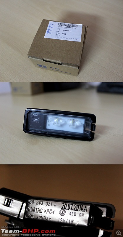

3. OEM LED number plate lights:
Previously, I was using a W5W LED inside each number plate light. This was again the cheap LEDs which replaced the W5W halogen bulb inside the units. Replaced the whole unit with the OEM LED light and the output is brighter than before, thanks to the twin LED setups in each unit.
VW Polo GT TDI ownership log EDIT: 9 years and 178,000 km later...-img_0685.jpg
Source - Aliexpress
Clicked these snaps in the manual mode, exposure time of 0.5 s and zero editing (other than resizing):
L, R - old setup with W5W LEDs:
VW Polo GT TDI ownership log EDIT: 9 years and 178,000 km later...-img_0700.jpg
L - OEM LED light, R - W5W LED:
VW Polo GT TDI ownership log EDIT: 9 years and 178,000 km later...-img_0710.jpg
L, R - OEM LED lights:
VW Polo GT TDI ownership log EDIT: 9 years and 178,000 km later...-img_0712.jpg
VW Polo GT TDI ownership log EDIT: 9 years and 178,000 km later...-img_0715.jpg

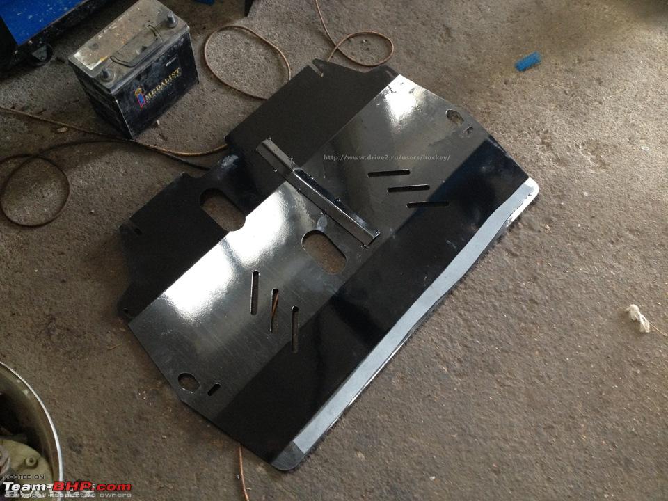

Originally Posted by aparam View Post
There is no engine guard in my car. ASC said only previous models comes with full cover and my model consists cover only for vital parts instead full cover. Is there any possibility to get full cover that will fit perfectly for my model.
Even the GT does not come with a skid plate. There is some cloth cushion kind of cover protecting the sump in my car. Not sure if the Polo sold here had one at all. There is an OEM plastic skid plate (part number - 6R0825902A) available with the dealerships - do enquire with yours if they can source one for you and install it. The other alternative is to source a 1 sq. m aluminium checkered plate from the market (like the ones you find on the bus flooring), get the brackets fabricated and install it at an FNG - would end up being cheaper. A mockup of this plate can be done using cardboard and then do the final design on the alu. plate.
Some examples:
