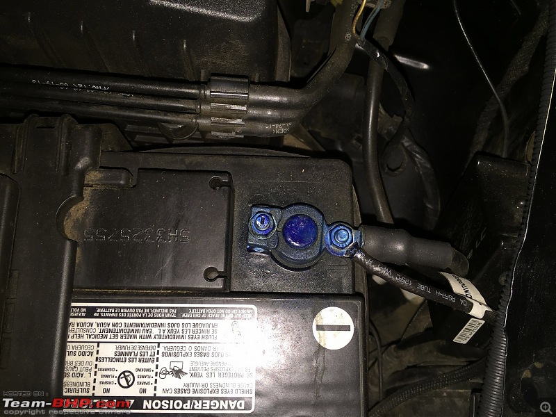

Replaced brake pads:
VW Polo GT TDI ownership log EDIT: 9 years and 178,000 km later...-brakepad_fl.jpg
VW Polo GT TDI ownership log EDIT: 9 years and 178,000 km later...-brakepad_fr.jpg
Ground terminal with the corrosion inhibitor spray applied (didn't ask for this):
VW Polo GT TDI ownership log EDIT: 9 years and 178,000 km later...-battery-terminal-spray.jpg
