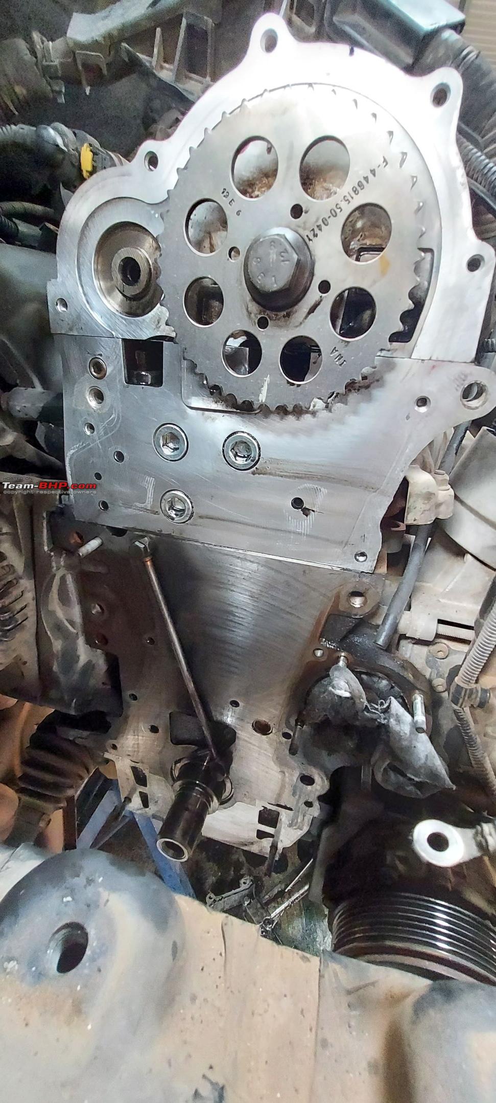

Timing chain replacement:
Maruti doesn’t refer to a schedule when the chain has to be replaced. However, ideal timing is between 100,000 – 120,000 km or even earlier. I had first replaced the timing chain around ~115,000. During the same time, along with chain and associated parts, I had also replaced the water pump assembly as preventive maintenance. This time too both these parts (chain and water pump) were replaced. Additionally, I also got the oil pump replaced as the car had already run on the stock pump for 235,000 km and failure of this component due to age can lead to damaging results for the engine.

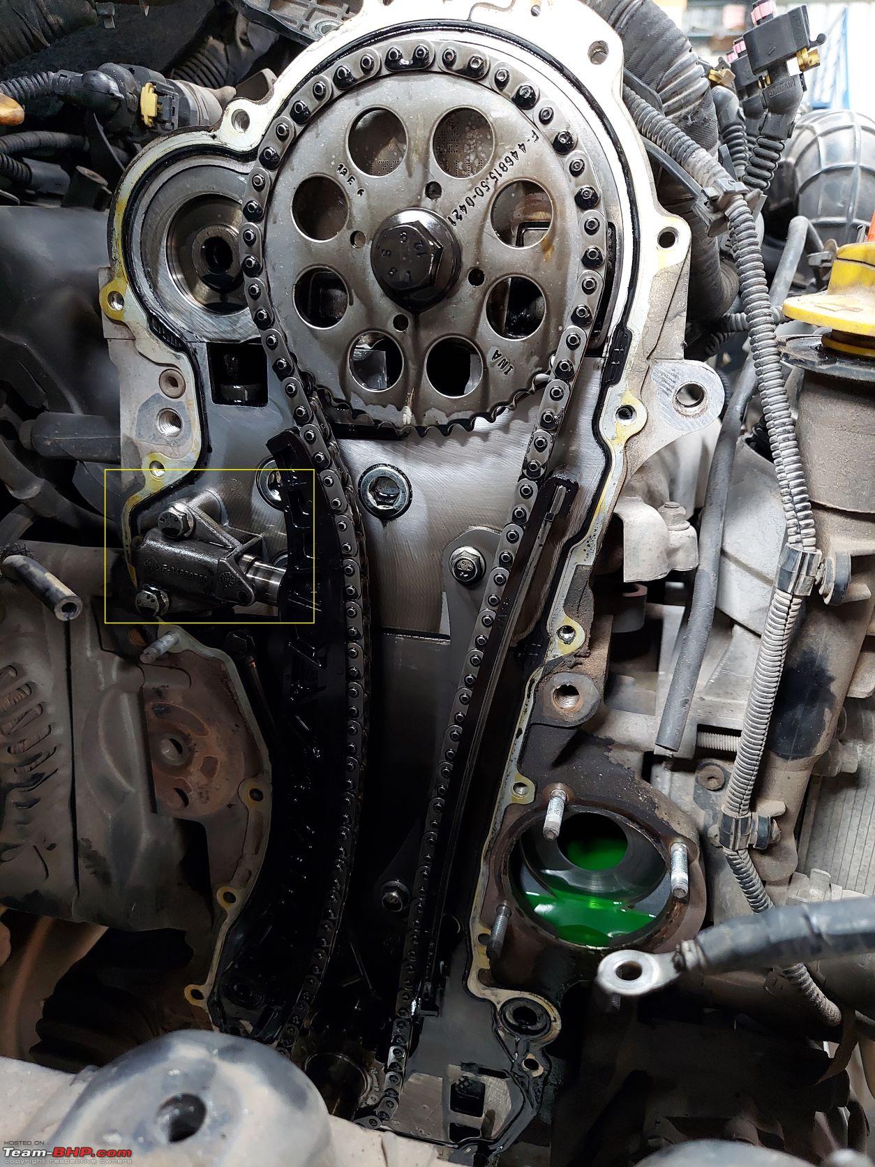

Parts removal in progress to access the timing chain
Tallboy welcomes longer companion | Maruti Ertiga VDi | 241,500 km-03-car-hoist.jpg
Tallboy welcomes longer companion | Maruti Ertiga VDi | 241,500 km-03-chain-case-oil-pan-removal.jpg
These are important images just to show the position of the tensioner after driving for 120,000 km and then compare that with the position of the new tensioner along with new chain.
Tallboy welcomes longer companion | Maruti Ertiga VDi | 241,500 km-04-timing-chain-existing.jpg
Tallboy welcomes longer companion | Maruti Ertiga VDi | 241,500 km-05-timing-chain-tensioner-existing.jpg
The timing chain area was cleaned before installing the new chain
Tallboy welcomes longer companion | Maruti Ertiga VDi | 241,500 km-07-timing-chain-area-cleaned.jpg
Tallboy welcomes longer companion | Maruti Ertiga VDi | 241,500 km-06-timing-chain-removed.jpg

Replaced timing chain, guide and adjuster. You can notice the position of the adjuster after replacement:
Tallboy welcomes longer companion | Maruti Ertiga VDi | 241,500 km-09-timing-chain-replaced.jpg
Tallboy welcomes longer companion | Maruti Ertiga VDi | 241,500 km-10-timing-chain-tensioner-new.jpg

... This post is all about details of a major service that my Ertiga VDi underwent during the...

Noticed that you have changed timing chain at timing belt intervals. Any reason why?
With belts you have the risk of sudden failure, so preemptive replacment at 80k to 100k is best. But with chains, they runs well beyond 200k kms and you will known when to change on inspection, as no fear of sudden failure.
Typically, the replacement interval for Timing chain for cars equipped with Fiat's Multijet Diesel engine is anywhere between 90-120k.
Maruti never specifies this for most of their Diesel products in the owner's manual and always go by the odometer reading along with a specific noise. FIAT models had an interval of 60k earlier that was later changed to 90k km too.
However, there are enough examples of the same cars running without issues even beyond 140-150k km on the stock timing chains too. But with something as crucial as timing chain, there is no risk that you want to take and damage the internals of the engine when one day suddenly the chain snaps!
You can browse through multiple ownership threads on this very forum, especially cars with Fiat Multijet Diesel and you will know that most have changed it around 90-120k mark. Quoting the below reference from Arun's Linea ownership:
Originally Posted by arun_josie View Post
4. Timing Chain replaced @ 59436 Kms and 1,11,913 Kms
