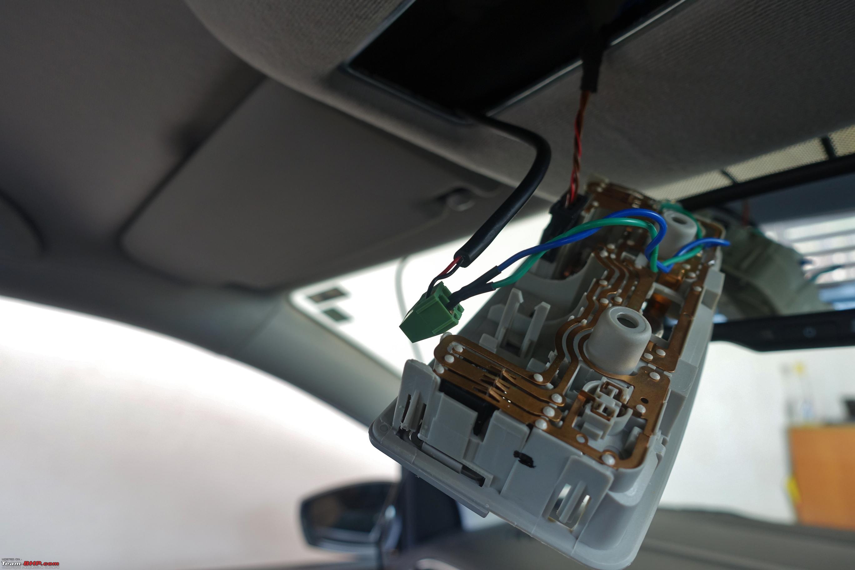

Here are the high level steps involved in the DIY.
1. Removed the OEM mirror. Gannu did this with a mallet. As I did not have a mallet, I managed with some twists and tugs.
2. Removed the cabin light assembly
3. Soldered two wires from the cabin light assembly from the 12V supply that remains ON when the car is unlocked. This signal goes off when the car is locked.
4. Mounted the auto dimming IRVM to the mirror base and tightened the screw.
5. Routed the IRVM supply wire into the roof lining and brought it to the cabin light assembly
6. Connected the IRVM supply to the wires that were soldered to the cabin light assembly
7. Fixed the cabin light assemby
Here are some photos of the IRVM DIY.

Soldered the other side of the wires to a terminal block. The IRVM wires can be connected to this terminal block using the screws. Used heat shrinking tube to seal the solder joint.
Carbon Steel Grey VW Polo GT TSI comes home! EDIT: 10000 km up + OEM bi-xenon headlamps upgrade!-terminal-block.jpg
Connected the IRVM supply to the terminal block
Carbon Steel Grey VW Polo GT TSI comes home! EDIT: 10000 km up + OEM bi-xenon headlamps upgrade!-connect-irvm.jpg

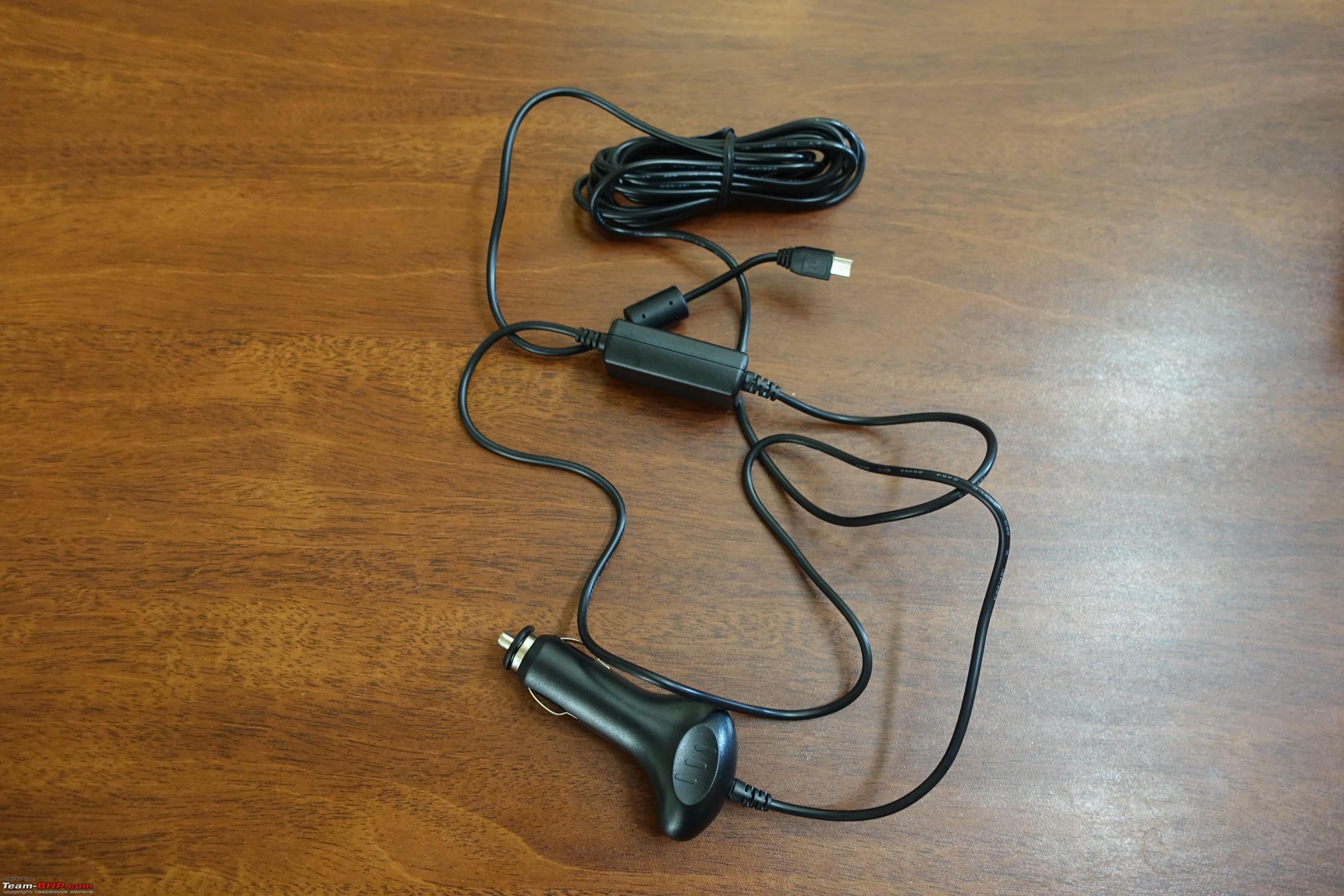

Next step was to make power connection. The camera comes with a power adaptor that plugs into the 12V cigarette lighter socket.
Carbon Steel Grey VW Polo GT TSI comes home! EDIT: 10000 km up + OEM bi-xenon headlamps upgrade!-power-cable.jpg
The small box in the middle of the cable assembly is the 12V-5V DC-DC converter.
Carbon Steel Grey VW Polo GT TSI comes home! EDIT: 10000 km up + OEM bi-xenon headlamps upgrade!-dc-dc-converter.jpg

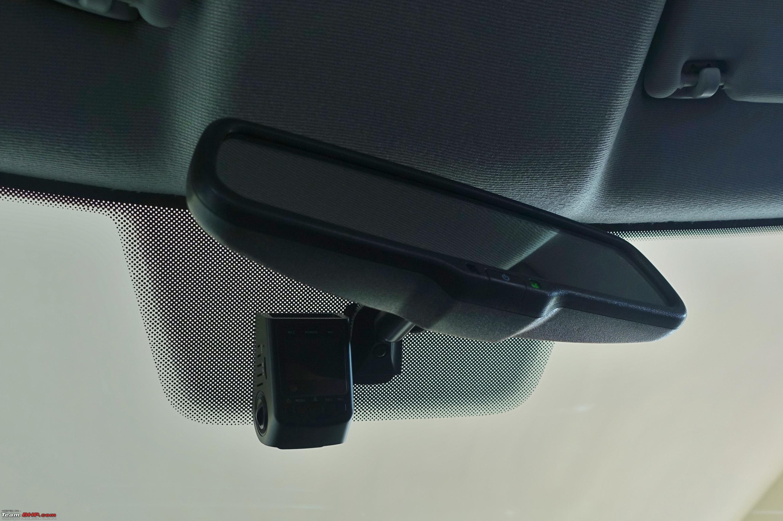

Now, the camera gets its power when the car is unlocked.
Carbon Steel Grey VW Polo GT TSI comes home! EDIT: 10000 km up + OEM bi-xenon headlamps upgrade!-powered.jpg
Next I pushed the power supply inside the roof liner and fixed the cabin light back.
Carbon Steel Grey VW Polo GT TSI comes home! EDIT: 10000 km up + OEM bi-xenon headlamps upgrade!-push-wire.jpg
The camera with both power supply and GPS cables plugged in.
Carbon Steel Grey VW Polo GT TSI comes home! EDIT: 10000 km up + OEM bi-xenon headlamps upgrade!-power-gps-cables-connected.jpg
