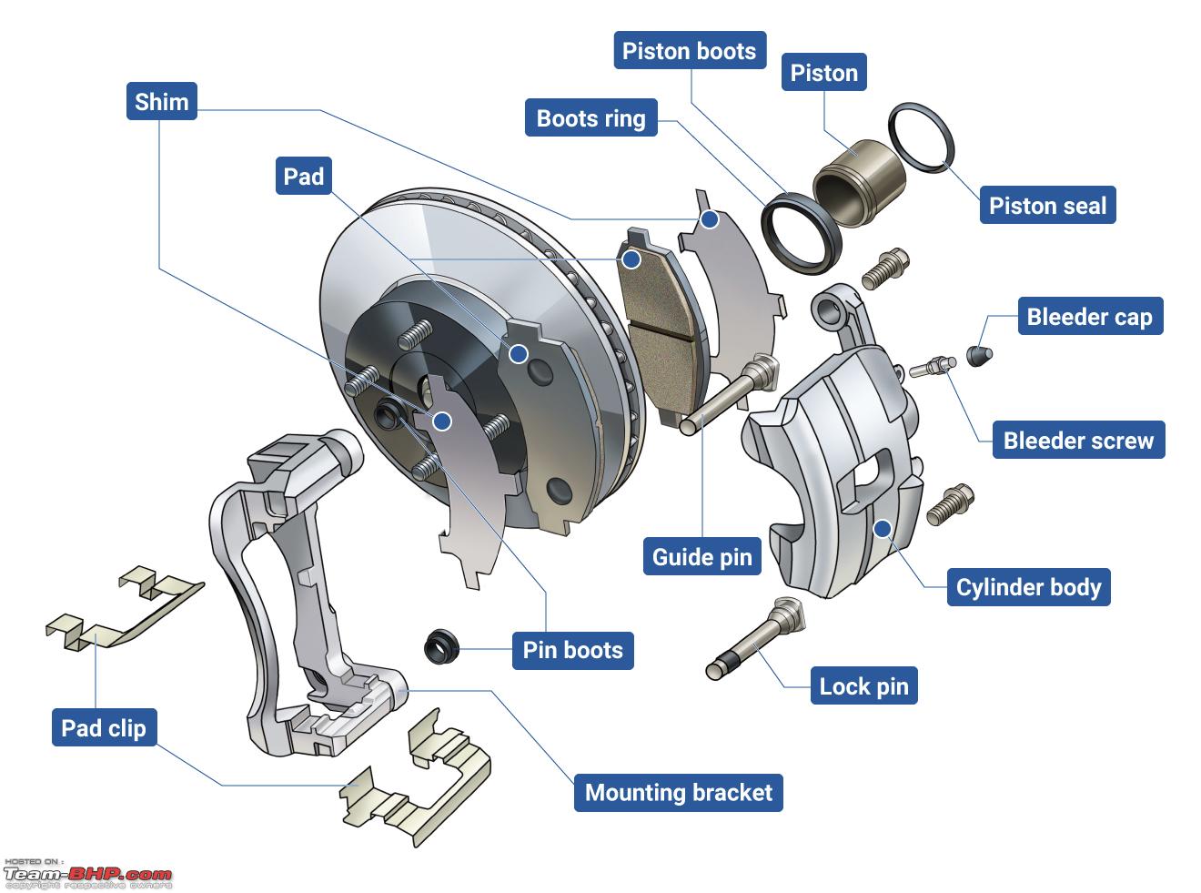

My intention of using this grease is for the caliper guide rods/slide pins and the rubber boot covering the pins. I have lot of that permatex stuff for the other metal to metal contact.
Pardon my lack of knowledge sir but after googling for about 30 minutes I still could not figure out where can this rubber grease be used in brake components? I do get the pin boot as that small part is essentially rubber, but aren’t sliding pins supposed to have caliper grease? Sliding pins, shims, and piston - all require caliper grease, something like this.
The love of my life - A 2000 Maruti 800 DX 5-Speed. EDIT: Gets export model features on Pg 27-f33b3eee4dbc46d2b7047f38e300e784.jpeg
I might have missed something but where exactly does this Toyota rubber grease come in picture in our cars?
The Caliper grease, whose link you have shared, is used on the guide pin, lock pin and the insides of the Pin Boots. The Toyota rubber grease also is applied to the same areas.
Just ensure that the Guide Pin, Lock Pin, Pin boots, Guide pin holes are cleaned of old residual grease before applying the fresh grease. Do not apply grease in the Guide pin holes. Do not use petrol/diesel to clean the Pin boots. They will most likely swell and become useless. Use brake cleaner or a lot of tissues/rags to to clean the boots. Do not overapply the grease on the guide pins - Just a thin layer of all around. However, you can fill the boot with some grease
Got it sir! But my confusion is, in the posts above it has been mentioned by R2D2 that caliper grease is for metal to metal contact and rubber grease is NOT for metal to metal contact. So isn’t it wrong to apply this on guide pin and lock pin?
See, in Toyota there is a distinct Caliper grease and Rubber grease.
This is Caliper grease -
https://boodmo.com/catalog/part-0888...8aArFCEALw_wcB
This is Rubber grease -
https://boodmo.com/catalog/part-join...4aArvbEALw_wcB
What determines where you use what grease is the type of metal-metal contact. If there is a static metal-metal contact, like between the caliper piston and the backing plate of the brake pad or the contact between the caliper ears and the outer brake pad, then use the Caliper grease. If there is Dynamic Metal-Metal contact, like in case of Caliper Slide pins where the pins move in and out of the Guide hole in the caliper, then use the Rubber grease.
For static Metal-Metal contact you can also you Copper grease, Ceramic grease. But for Guide pins/Slide pins/rubber boots or wherever there is one metal part moving/rubbing over other metal part you need to use specific silicone-based products. The Toyota rubber grease is the best out there in the market for this. The Maruti grease sachet is Silicone based. It is cheap and it works very well.
Ok let me jump in here though Shashi has explained it well including the links to different products to be used for specific purposes
The reason you have rubber grease (although technically the caliper pin is metal and engages with the caliper bracket providing metal to metal contact) is because of the rubber boot and a washer at the end of the pin. If you use the wrong grease the boot and the 'washer' will deteriorate ie boot cracks and allows in dust which makes the grease into a grinding paste. Then the washer at the end of the pin swells up and does not allow your caliper to disengage from the rotor when your foot is off the brake pedal causing sticky brakes with attendant problems. My Dad's car suffered from this issue because our so called mechanics don't appreciate the finer points of maintaining a car.
Caliper grease is to reduce friction between the backing plate of the pad and the shim + the piston + body. It's important to remember not all car brake systems require this type of lubing.
So 2 take aways:
  • Follow instructions in the workshop manual. Lucikily MSIL sells them.
  • Always use lubes and fluids that are purpose made for a specific application
