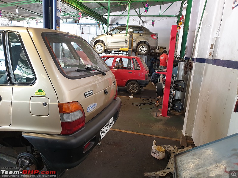

Update: I was deliberately keeping GG hibernated during rains, specially after XL6 came, since no matter how healthy she is, she is still a 20 year old car. It seems I was wrong.
When the weather finally became properly sunny, I took her out on a 100 km trip. Everything felt jammed: The brakes, steering- everything. There were mild squeaks coming from front suspension as well. While things improved after a few kilometers, the increasing temperature of front left wheel was a concern. Braking was largely normal except a very mild pull towards right. In no time, the Front left wheel crossed the threshold of 60 Degrees and TPMS was very prompt in warning me. Pressure also started increasing. When this happened, I was still 30 km away from my home. I deflated the tyre a bit since it's pressure had crossed 40 PSI. I started driving slowly since I didn't want to lose control if the tyre blew. It reached a maximum of 79 degrees. I shudder to think what would have happened if TPMS wasn't there. Since I couldn't feel anything wrong while driving.
Barely a kilometer from my home, a very pungent smell, like that of rubber burning started coming. This was accompanied by lots of brake dust on alloy, and that looked like burnt rubber to a fellow biker who was near me. He warned me. I checked the TPMS and temperature was 64 degrees. I reached home and by then the burning smell increased a lot. I immediately poured water on the rim and disc, while being fully aware that it can crack the metal. But my priority that time was to arrest any potential fire hazard.

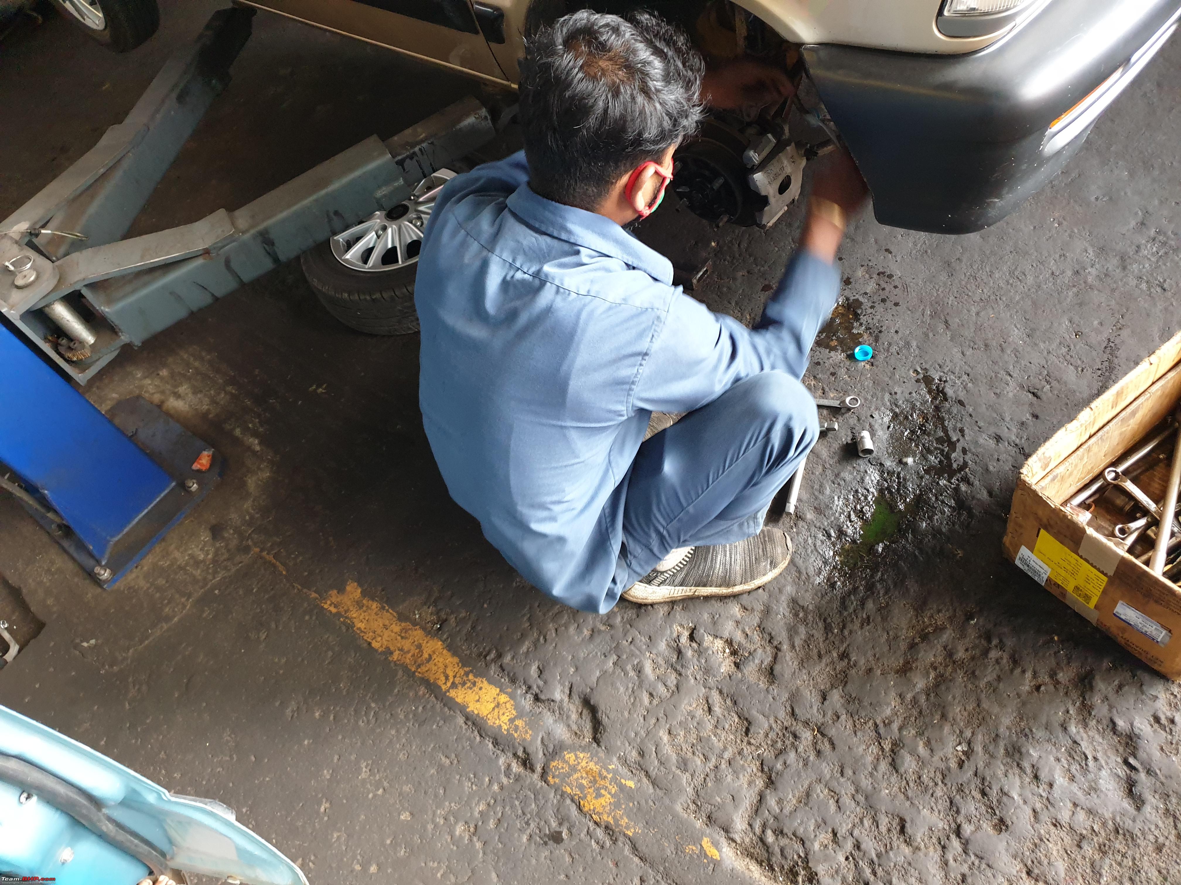

Later during inspection, I saw that the left brake pad had almost burnt out. There was barely any material left. Took GG to MASS today, and asked my mechanic Arjun to check everything in detail.

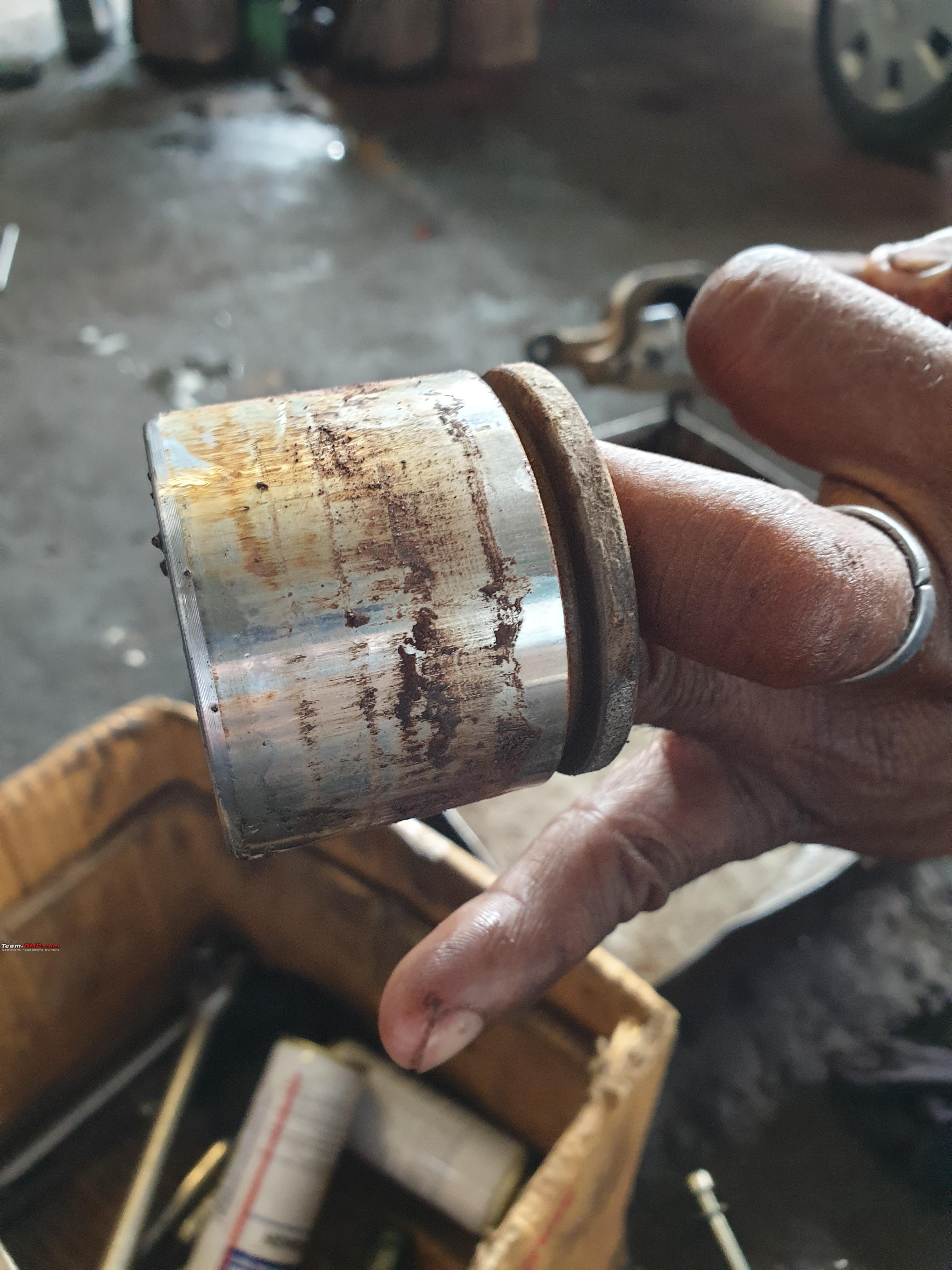

-Left side caliper piston was seized due to rust. Also it seems brake fluid had moisture at some point of time. The brake fluid was completely flushed.
-Due to excess heat, left flexible hose was damaged. Replaced all 4.
-Replaced both rear brake cylinders
-Replaced the brake pads
-Disc was fine, again. Just for record, this is still the original disc!
-We checked all nearby rubber components and all were fine.
-We changed Caliper piston and all associated oil seals.
-Toyota Grease was fine, despite such torture. Still I asked them to replace all old grease and put fresh grease.

Reached the workshop early:
The love of my life - A 2000 Maruti 800 DX 5-Speed. EDIT: Gets export model features on Pg 27-20201005_090445.jpg
The love of my life - A 2000 Maruti 800 DX 5-Speed. EDIT: Gets export model features on Pg 27-20201005_094155.jpg
Condition of Left Caliper:
The love of my life - A 2000 Maruti 800 DX 5-Speed. EDIT: Gets export model features on Pg 27-20201005_095604.jpg

Condition of RH Caliper's piston:
The love of my life - A 2000 Maruti 800 DX 5-Speed. EDIT: Gets export model features on Pg 27-20201005_100051.jpg

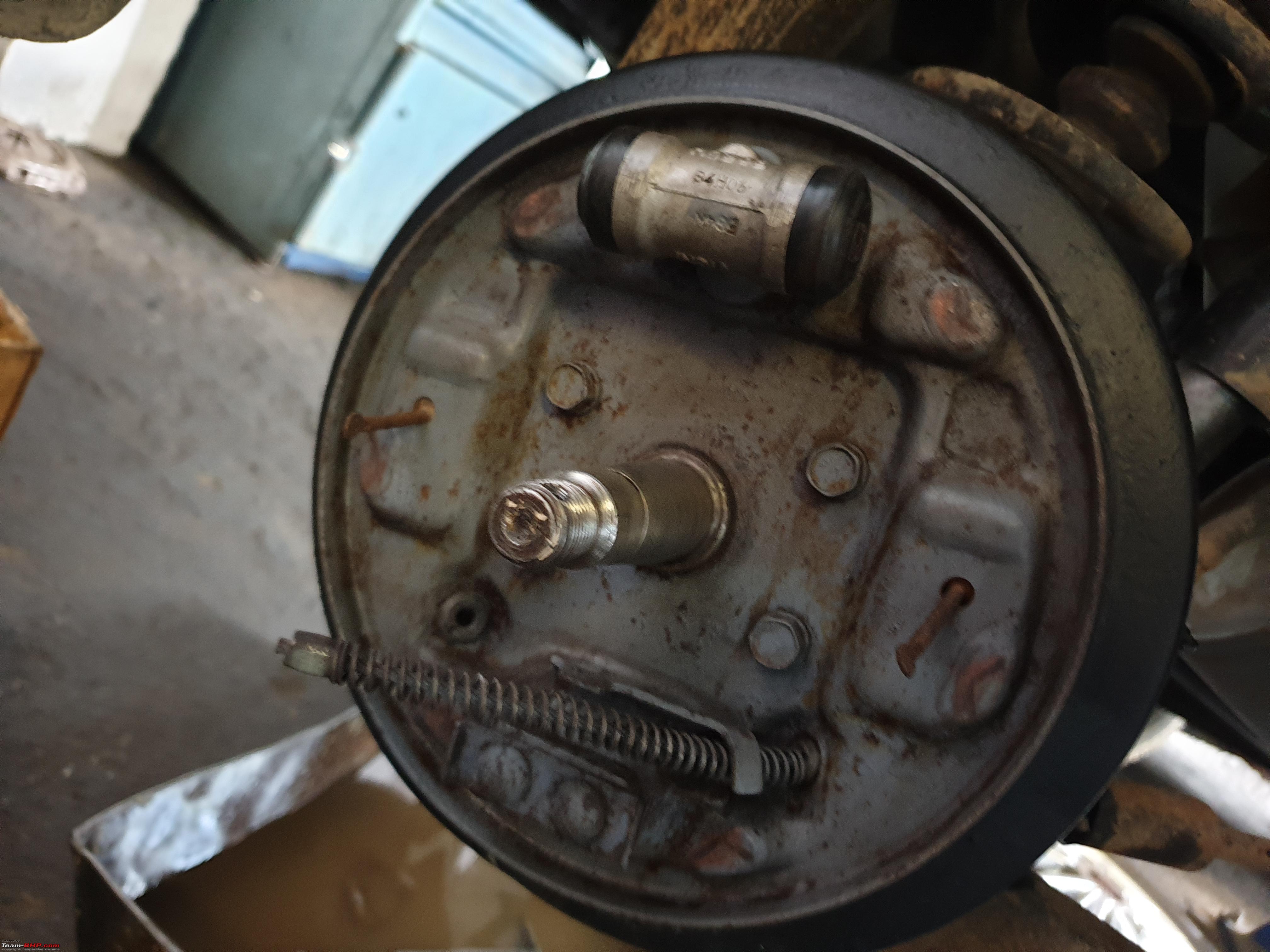

Rear brake was in decent shape, Rustoleum high temp paint was holding up well. Just needed some dusting:
The love of my life - A 2000 Maruti 800 DX 5-Speed. EDIT: Gets export model features on Pg 27-20201005_113430.jpg

Look how instantly water evaporated-The brakes were surely boiling:
Lesson Learnt: GG needs to be taken out regularly!
And the brake system MUST be flushed every 2-3 years without fail.
R2D2 is offline   (9) Thanks
Old 5th October 2020, 21:00   #824
Leoshashi's Avatar
Join Date: Jul 2014
Posts: 5,728
Thanked: 43,555 Times
Re: The love of my life - A 2000 Maruti 800 DX 5-Speed. EDIT: Gets export model features on Pg 27
Post 2013, it was always done on schedule-2 Years without fail. But before that, mechanics used to just top the fluid up. The fluid was brownish when it was flushed for the first time in 2013. Imagine. This fluid was barely a year old.
Also GG lived on supplies from Petrol pump largely, before I shifted to the existing MASS who always used Maruti Genuine Fluid 2013 onwards.
Shashi
Leoshashi is offline   (8) Thanks

Update:
Hi Shashi,
Little sad to see GG getting a jammed brake given how impeccably maintained the car is. If the brake fluid is flushed as per schedule, any idea what more can be done to prevent this, other than frequent usage?
Also curious why all 4 flexible hose got replaced. I am trying to understand if brake line is also wearing part (with age) since its a safety critical part. I do not find any mention in user manuals. Also, is there any noticeable improvement in braking after changing them? Newer ones should flex lesser than old ones under braking.
Thanks,
Antony
