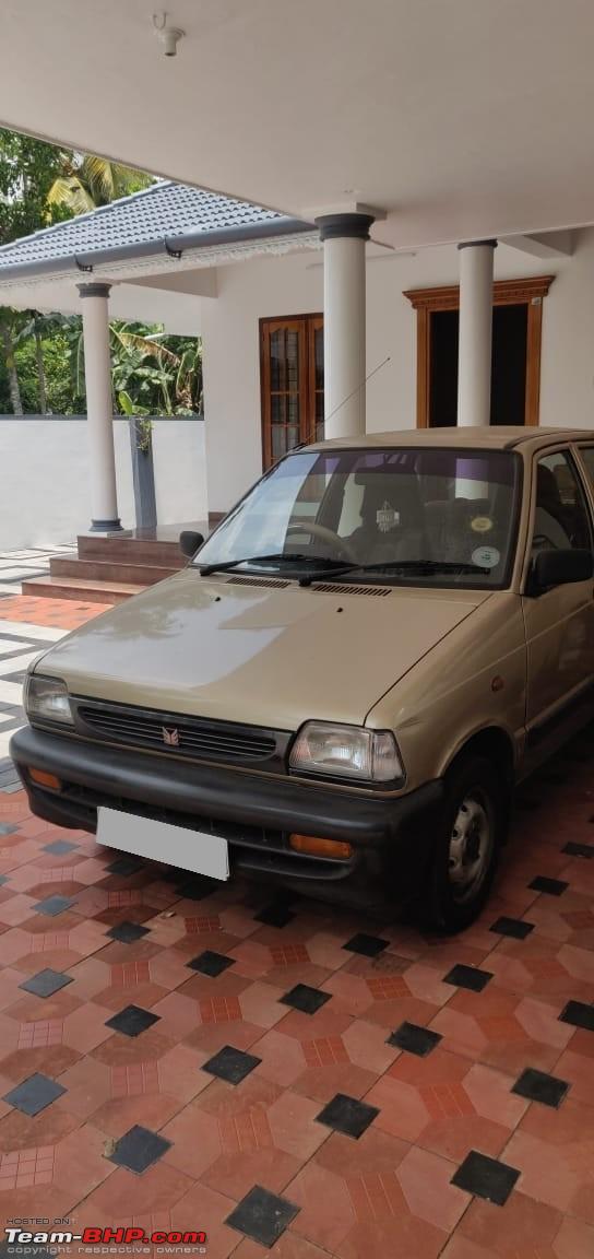

We too have a Maruti 800 DX 5 Speed that we took in November 2000 and it was actually the car in which my dad and myself learnt to drive. She still retains almost 80% of factory paint, original rubber mats and even faded monograms on the hatch. Till date, she had clocked about 3,22,000kms on odo and still she is my dad's daily driver though we have many other cars in garage.
Here's a picture of my beauty
The love of my life - A 2000 Maruti 800 DX 5-Speed. EDIT: Gets export model features on Pg 27-20200412151326.jpg
She looks awesome. Please treat us with more and detailed pics of her interiors, engine bay and exteriors from different angles.
