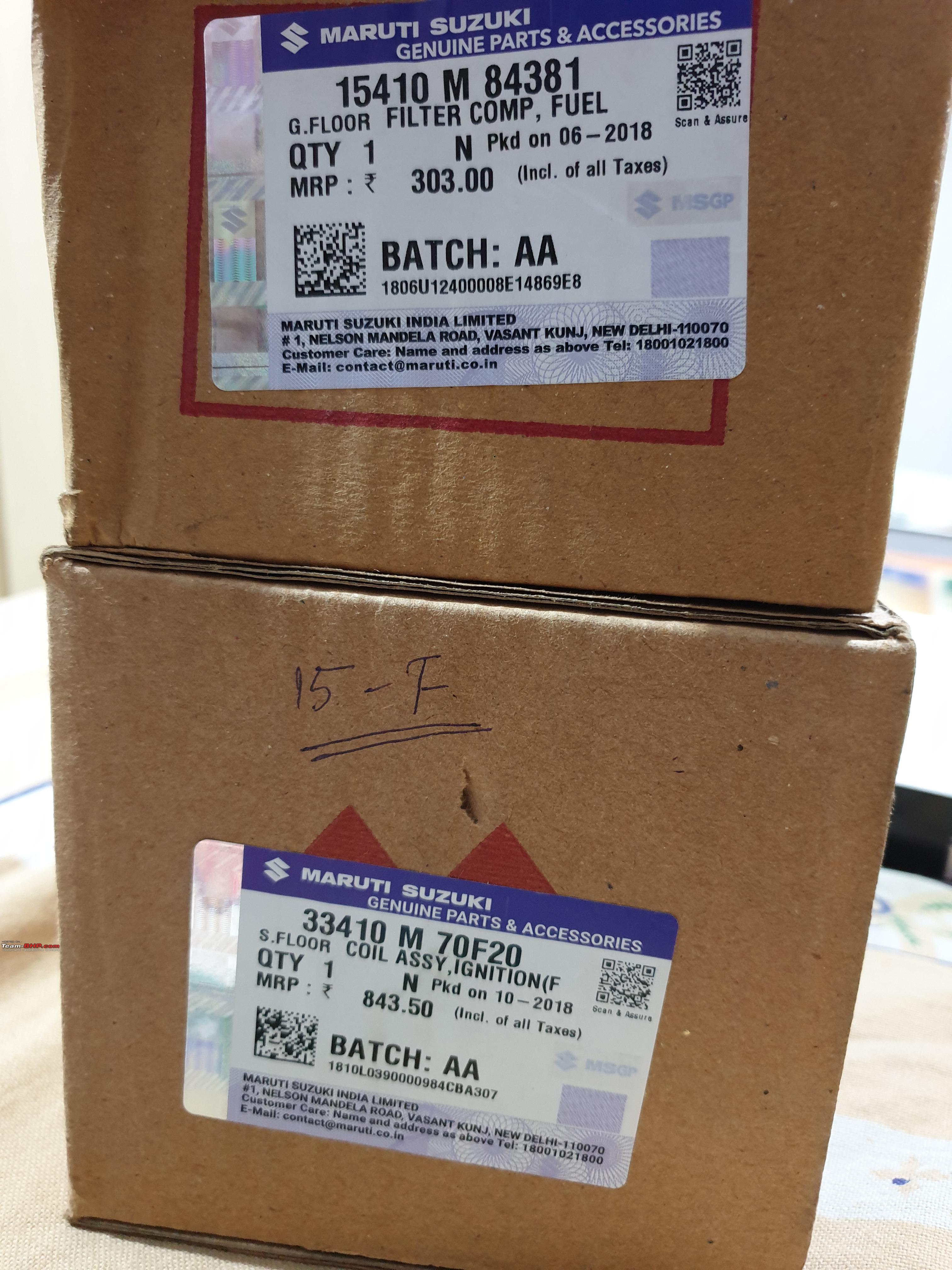

Minor Update: Few days back, I observed delayed cranking. To be precise, the crank sounded strong but the car was taking a bit too long to start. The battery is approximately 4 years old, but wasn't weak at all. The other culprits can be ignition coil, distributor or the igniter. At one instant, the car was not starting. I then found current was not reaching the distributor. This narrowed it down to either the igniter or the coil itself.
The Igniter costs a whopping 17.7k rupees, and I was hoping it hadn't failed. Thankfully it was just the coil that had become weak. Replaced it myself, and the issue was solved.
Also replaced the Fuel filter, since after the fuel tank fiasco, I've decided that I'll change the fuel filter after every 10k kms, manufacturer schedule be damned!
The filter and the coil:

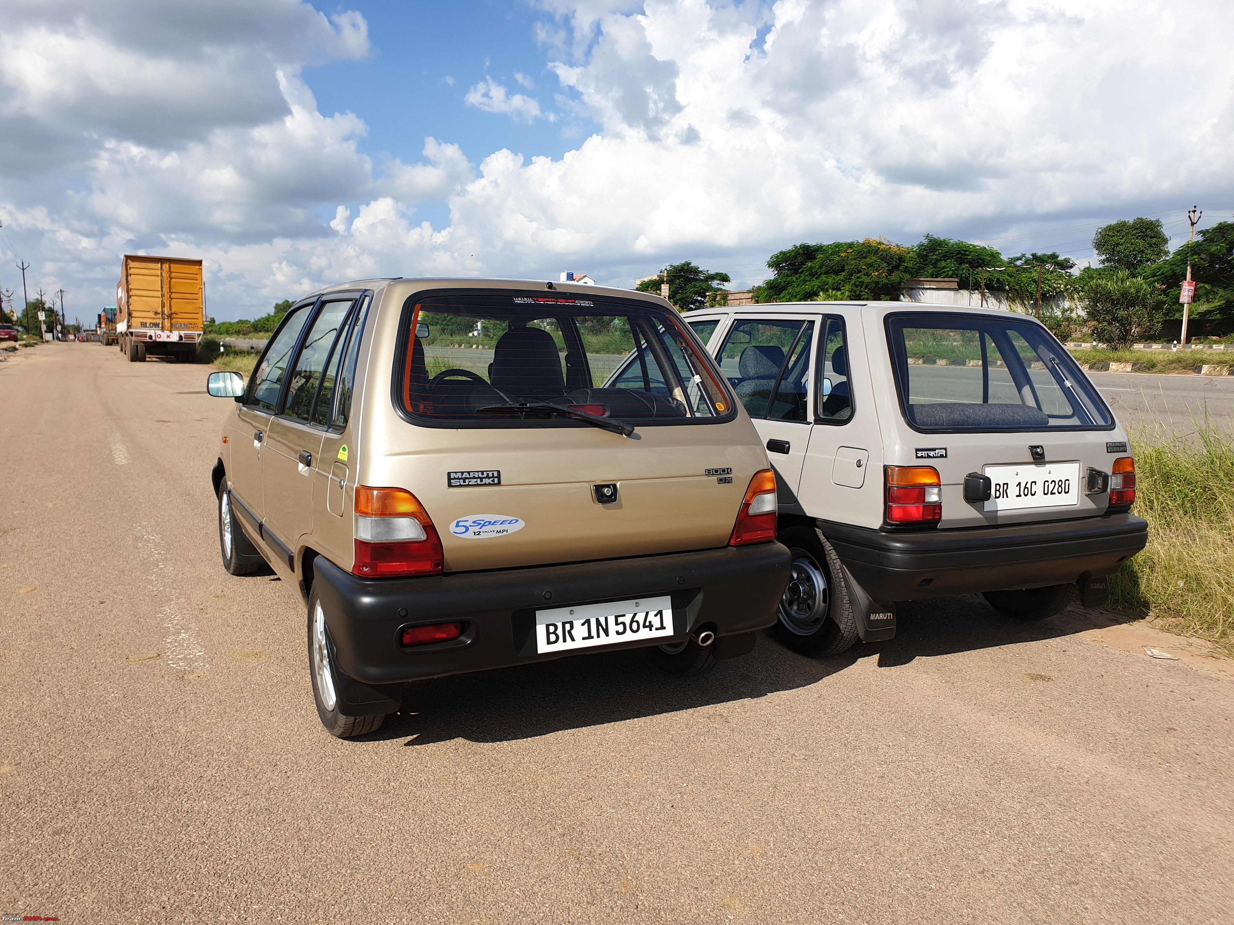

Just saw the rear bumper of BR1N 5641. The same export version suzuki bumper is available at a shop (5 pc) in Patna Bihar, so any enthusiast wish to have one for modification may get in touch with the shop owner.
The rates will be as per MGP quotes. I have already booked 2

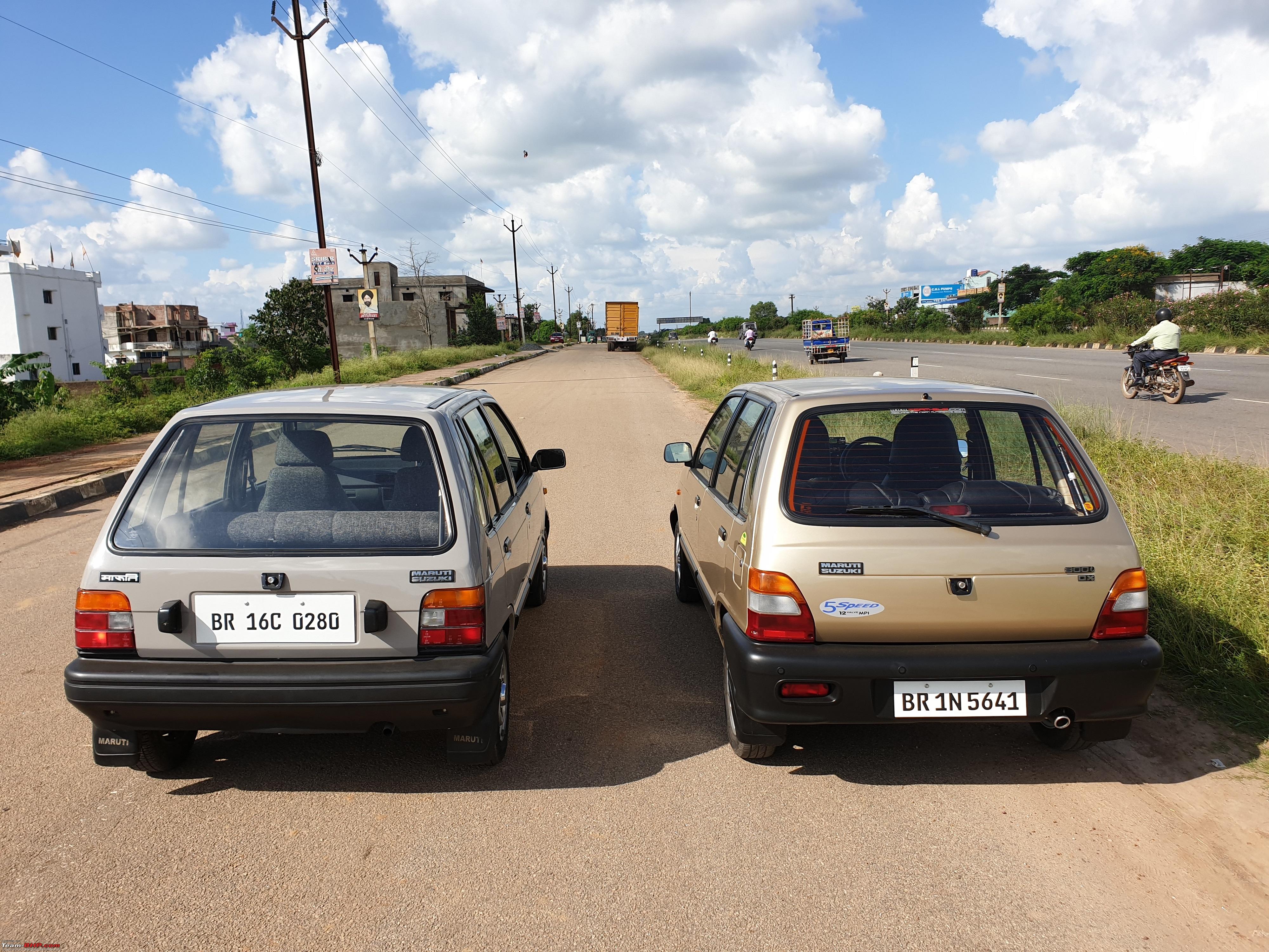

Had a quick meet with BHPian Sumitsinha0280, and asked him to bring his newly restored M800 along for a Photoshoot. Hope you like the pics :
