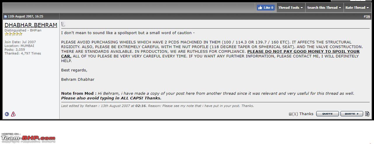

Reasons for looking for alloys:
More than the looks, I wanted alloys since:
1. Steel rims add up to the weight. The alloys are much lighter.
2. Mount any steel rim on a balancing machine and some degree of eccentricity is always noticeable. Even on new ones. This induced some degree of wobble at some speed(mostly low).
3. Better cooling of brakes.
4. Looks!
But yes, I had certain strict requirements in mind, which took me so long to find them.
1. No Multi PCD alloys. I hate the aftermarket looks, with 4 empty holes. Also, common sense says that they should be structurally weaker near the hubs. While I am yet to see any failure, I came across this post by Late Behram Dhabar Sir, which was firmly engraved in my mind, and I had no reason not to believe him:

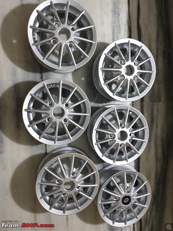

How I got these alloys: Maruti did sell MGA alloy wheels for Maruti 800, before 2008. They were made by Hindalco aka Aura Wheels and were of awesome quality. After Aura wheels shut down, there was no decent option for M800. Recently, I came to know that there was 1 alloy wheel in stock in Coimbatore, and 5 in Pune. These were the only stocks left in India, 6 of them. All of them are made between 2005 to 2008, so it was pretty dead stock with those dealers!
While DBHPian Graaja and Mr. Maheshwaran of Coimbatore MGP store helped me with that single alloy, DBHPian R2D2 was troubled for the 5 pieces in Pune. It was nearly a month long operation, with me planning every single thing which can be a problem.
It was important that those BHPians should have the least troubles, so I took these steps:
1. The alloy was packed and dropped to DBHPian Graaja's house and was picked by Gati courier from the doorstep. I am glad he wasn't troubled much. Special thanks to Coimbatore MGP's owner Mr. Maheshwaran for all the pain he took. More details: Thread (Rajkrishna Aditya Auto: How an unknown brother went out of the way to help me out!)
2. The alloys at Pune were lying at a Dealer showroom. But the chap warned me that those alloys were defective and they wont fit any Maruti. I knew what the issue was, the PCDs were of M800(114.3) while they were trying to install in Alto(100). Thanks to this goof up, they never sold those alloys and had marked as Defective. I had an old wheel hub with me, which I sent to DBHPian R2D2 so that he could check before finalising. This turned out to be a masterstroke, as they had mixed similar looking alloys of Alto and M800. DBHPian R2D2 brought the alloys to his place. I had ordered packing materials from Amazon to his place, and he packed everything. Again, GATI courier came to rescue and picked up all 5 wheels from his place.
Mechanic getting the old hub prepped up, for sending to R2D2 Sir.
The love of my life - A 2000 Maruti 800 DX 5-Speed. EDIT: Gets export model features on Pg 27-20181229_171848.jpg
Needless to say, some of them had minor scratches which wasn't serious. All the dealers were happy to offer me a 10% discount since I was picking up their decade old stock.
After they reached me, I found out that they were immensely dirty. Gave them a nice wash and today took them to my MASS for getting Painter's opinion. He said all scratches were on clear coat, and that we shouldn't touch the base coat. He wet sanded all the scratches, and gave them a fresh coat of clear coat which was specifically used for wheels.
Result:
The love of my life - A 2000 Maruti 800 DX 5-Speed. EDIT: Gets export model features on Pg 27-20190202_190551.jpg
The love of my life - A 2000 Maruti 800 DX 5-Speed. EDIT: Gets export model features on Pg 27-20190202_190603.jpg
The love of my life - A 2000 Maruti 800 DX 5-Speed. EDIT: Gets export model features on Pg 27-20190202_190616.jpg
The love of my life - A 2000 Maruti 800 DX 5-Speed. EDIT: Gets export model features on Pg 27-20190202_190639.jpg
The newest one: September 2008 make
The love of my life - A 2000 Maruti 800 DX 5-Speed. EDIT: Gets export model features on Pg 27-20190202_190654.jpg
The Oldest one: August 2005 make. These beauties waited for more than a decade before meeting GG
The love of my life - A 2000 Maruti 800 DX 5-Speed. EDIT: Gets export model features on Pg 27-20190202_190721.jpg
