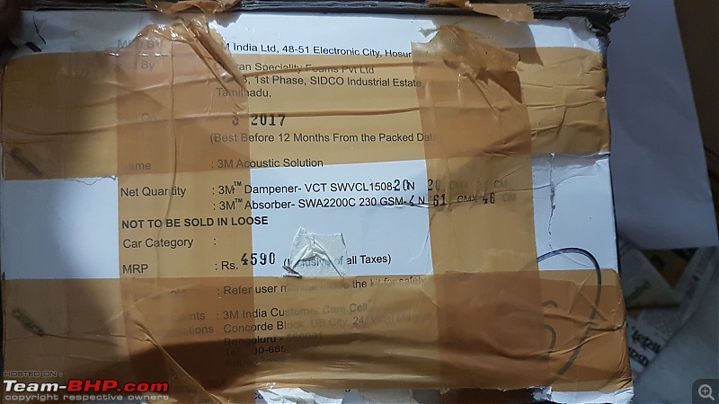

3M has recently launched acoustics kit, which promises to control road noise to some extent. It mainly focuses on damping the sheet metal, which in turn results in lesser travel of mechanical wave aka sound.
The kit mainly has two stuff: 20 pieces dampener to be stuck inside the door sheet metal, and 4 pieces thick absorbing material which goes behind the doorpad. In another thread, I saw them being stuffed inside the door, which I feel is the wrong process and can increase chances of rusting.
I also used Tufkote's Melt sheet equivalent for damping in between. Limited its use as it was heavier than the featherlight 3M ones.
Vitara Brezza's doorpads, which gave me this idea. Haven't seen this in any other Maruti
The love of my life - A 2000 Maruti 800 DX 5-Speed. EDIT: Gets export model features on Pg 27-20180704_154040.jpg
3M acoustics kit: hardly weighs anything
The love of my life - A 2000 Maruti 800 DX 5-Speed. EDIT: Gets export model features on Pg 27-img20180611wa0154.jpeg
The content: dampener, with 3M double sided tape
The love of my life - A 2000 Maruti 800 DX 5-Speed. EDIT: Gets export model features on Pg 27-img20180611wa0152.jpeg
Absorber, to be stuck with 3M masking tape.
