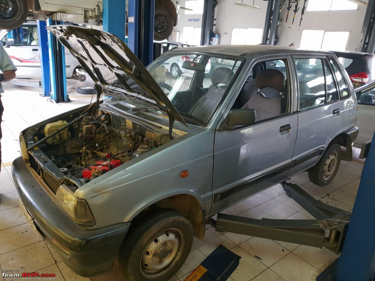

Given the condition of the suction strainer, that's a million dollar question you have asked.
Surprisingly and luckily, the engine is still okay. Just needs a headgasket change, some serious cleaning and all oil seals are being replaced. MASS has given an estimate of around 12k, which should take care of everything. This is on the higher side, but he had no other choice.
These old Maruti engines are not so sensitive to abuse and neglect, and don't give up so easily.
Some more pics of the vehicle in question:

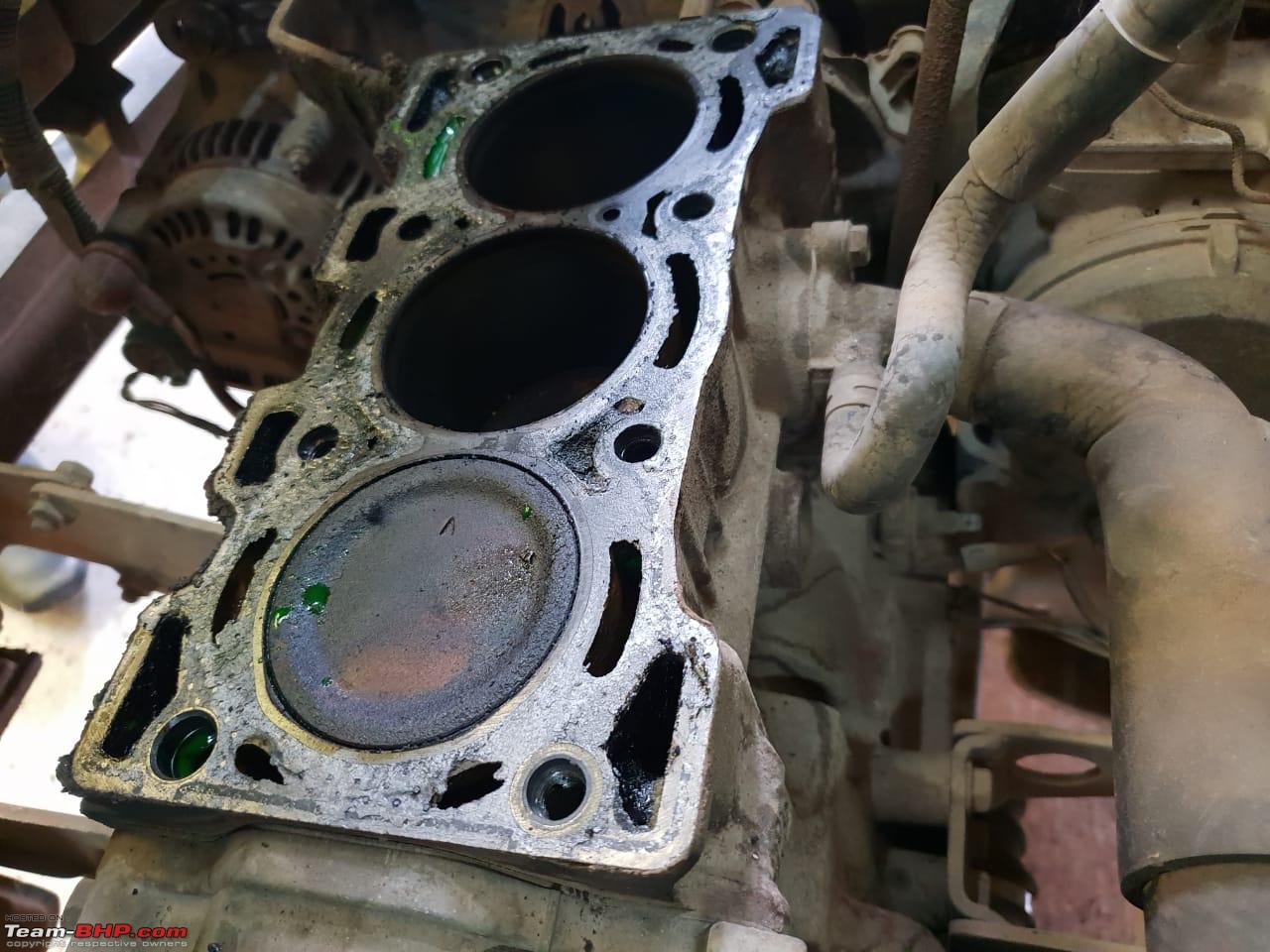

A good friend of mine owns a 03 Zen Lx (first owner & 150k km on the odometer). Recently he took his car to a MASS for overhauling the engine, as there was a coolant leak, some oil seal was also leaking, the engine had lots of sludge formation, and of course the odometer reading was nearing the 150k km mark. Strangely, all the Zen needed was a new head gasket, few oil seals and the car was back to normal. Even the compression test result came out positive.
Here are some photos of work in progress:
The love of my life - A 2000 Maruti 800 DX 5-Speed. EDIT: Gets export model features on Pg 27-zen-1.jpg
The love of my life - A 2000 Maruti 800 DX 5-Speed. EDIT: Gets export model features on Pg 27-zen-2.jpg
The love of my life - A 2000 Maruti 800 DX 5-Speed. EDIT: Gets export model features on Pg 27-zen-3.jpg
The love of my life - A 2000 Maruti 800 DX 5-Speed. EDIT: Gets export model features on Pg 27-zen-5.jpg

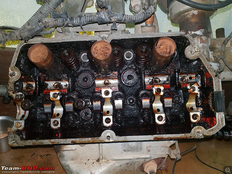

Even my (now sold) 01 Zen Vxi had huge sludge formation, still it never caused me any trouble. Performance & Mileage were still good. Only problem was a bit of white smoke at startup & slight oil consumption (though it never needed any top-up). I have no idea about the longevity of the modern Maruti engines, still I am willing to bet they won't be as abuse friendly as these old Maruti engines.
Here are some photos of the sludge, almost as bad as Bhpian Madmanscam's M800:

The MASS is being very difficult. Ask them to do anything, and they are giving a standard reply, "We do this only with overhaul, will cost you 40k"
Imagine the professionalism of the mechanic, he is doing an engine head gasket replacement but wasn't ready to clean the head unless we opted for the entire rebuild. Upon convincing them for sump cleaning, they quoted 3000 rupees as labour. The goddamn brand new sump and strainer costs less than 400 rupees.
After a lot of requesting and pulling some strings, they have finally agreed to clean all sludge for Rs. 4,000.
The issue was that the car wasn't drive-able. It would have been a risk to drive 20kms in that state. The head is an aluminium one and costs eye watering 22k rupees for this variant of M800. I don't know the reason behind its absurd pricing. A new Swift's head costs 1/3rd the amount of 5S 800's head.
Anyways, they are working on the car, and hope the issue gets resolved soon.

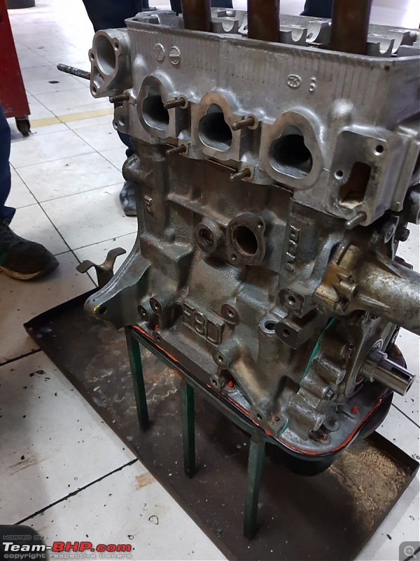

Update on BHPian Madmanscam's 5S 800-
MASS has cleaned the head. But, I have a doubt: It looks like they have used paint at some points. It looks unnaturally shiny at some places. I'm not getting a good feeling. There is inconsistency at some places. Experts: Please comment

Clogged up coolant galleries
The love of my life - A 2000 Maruti 800 DX 5-Speed. EDIT: Gets export model features on Pg 27-img20181207wa0099.jpg
The love of my life - A 2000 Maruti 800 DX 5-Speed. EDIT: Gets export model features on Pg 27-img20181207wa0088.jpg
The love of my life - A 2000 Maruti 800 DX 5-Speed. EDIT: Gets export model features on Pg 27-img20181207wa0098.jpg
The love of my life - A 2000 Maruti 800 DX 5-Speed. EDIT: Gets export model features on Pg 27-img20181207wa0087.jpg
The love of my life - A 2000 Maruti 800 DX 5-Speed. EDIT: Gets export model features on Pg 27-img20181207wa0097.jpg
Brand new Sump-Do note that the sump is different for F8D Engine.

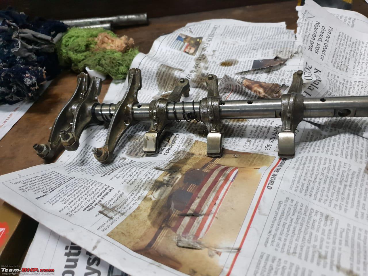

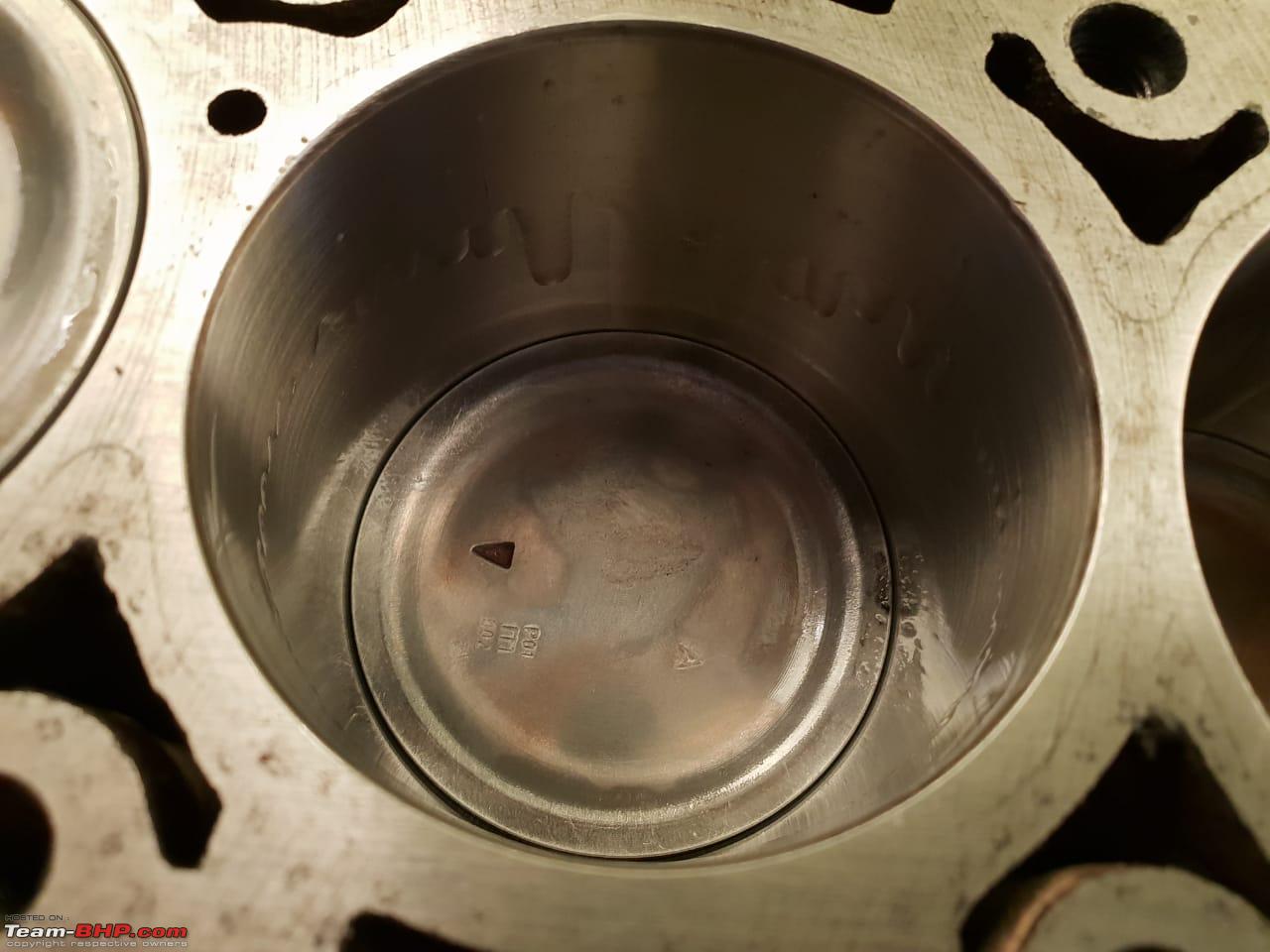

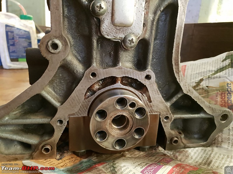

Update on BHPian Madmanscam's 5S 800- He had asked the MASS to get the block cleaned as well. Some coolant galleries were chocked with deposits, and it didn't make sense to clean the head and leave block as it is.
They have also changed the piston rings and the oil pump.

How long can one realistically expect a partially overhauled engine (like this one) to last? In 2013, there were some problems with our Omni's engine (mainly engine oil coming in contact with spark plugs). We ended up fitting a new half engine (F8B half engine only costs 12k), as we were told that an overhauled engine doesn't last very long.
Depends on quality of work done and the condition of old engine. Regarding the debate Overhaul vs Half engine, this is what I have to say: Overhauled engines can be better than factory engines IF the work done is good, and, Half engines can also fail and become a nightmare IF the workmanship is bad. That's a king sized IF in both the cases. However, the risk involved in half engine is certainly less.
Here the block was in a good shape, and all it got was some polishing on the cylinder walls and new rings. So I am expecting it to be as good as new. Workmanship of MASS looks good, albeit expensive.
The engine has been assembled and will be mounted tomorrow. Some pics of the WIP:
