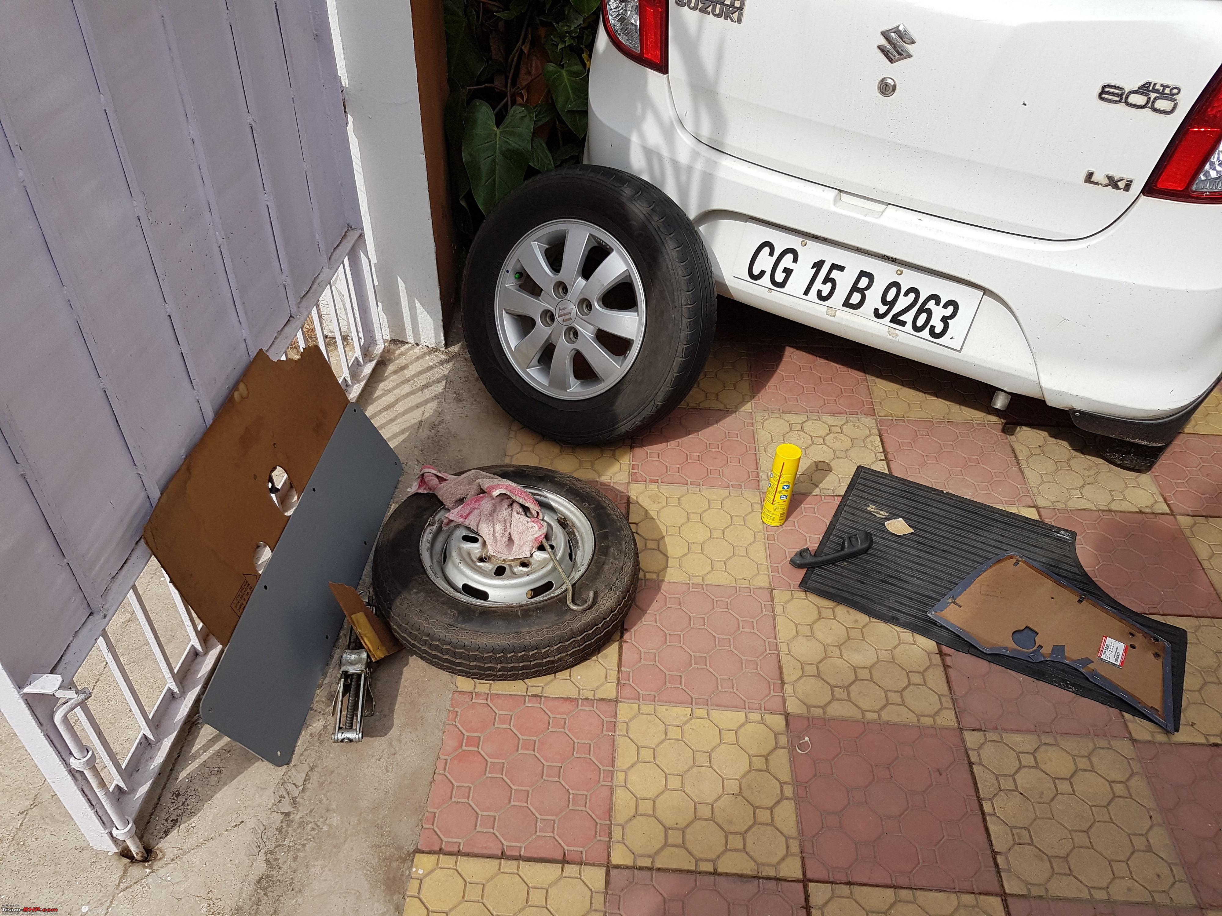

Update time: There were some minor issues with my car, which were rectified yesterday.
Issue No 1: I felt that the vibrations on clutch pedal while leaving was a bit more. I mean it was so less that 90% mechanics and workshops dismissed it as normal thing in an 800. I know my car inside out, was therefore not convinced. My SA Mr. Dhiraj said it can be because of weak torsional springs of the clutch plate, but removing a gearbox for such a minor imperfection wasn't necessary.
2. Issue No 2: Weak Rear engine mount: During the crossmember change, we had noticed an almost shot engine mounting. But since getting access to rear one was cumbersome and time consuming, I decided to wait for some time.
So got the clutch plate, pressure plate and the rear engine mount changed yesterday. Clutch was some 80k old, but still had decent life. Changed it only because of weak springs.
Also, the day started with stripping BHPian Sumitsinha0280's 1992 M800. This car was sold in 2002, and retrieved back in 2011 after it was found abandoned, almost waiting to be scrapped. Then it was restored in a local FNG, and the work appeared fine initially, but actually it was badly tinkered and all rust spots were hidden by putty rather than solving the issue. So this time we have decided to go for the complete overhaul. All chassis panels will be replaced, rather than tinkered and then will be rust proofed in the best way possible using Zinc Primer and Epoxy. Also the engine and gearbox will be changed. Engine has done more than 4 lac kms and now it cannot be overhauled as the block's condition is very bad(was rebored once).
Time for pics:

Total Cost incurred: Rs. 3900. Labour was Rs. 1200 for the entire job.

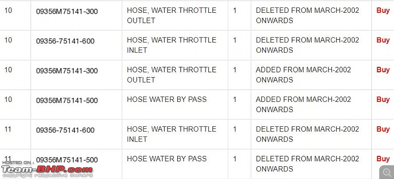

Update: I decided to clean the IAC valves and throttle body myself. The throttle body was spotlessly clean, but the IAC was badly clogged. Also it's gasket was damaged, which meant I had to head to my MASS again. The initial batches of the 5 Speed 800 and Zen got coolant line through the throttle body, which probably acted as a charge pre heater in colder countries. I am not too sure about its need, hence would like expert members to comment.
This coolant line in throttle body was deleted from March 2002 onwards by Maruti. My SA recommended deleting that line too, as it significantly heats up the intake air, and secondly, is one of the known reasons of IAC bearing failure if the gasket fails for any reason. We connected the intake and output side of the coolant pipes using a metal tube(probably a part of Gypsy's Fuel line) and clips.
I guess this was the reason why power rating of post 2002 5 Speed 800s was 47BHP, as opposed to 45BHP of my 2000 model. I have seen the entire parts cataog and only this was the difference in engine. Also I have read how deleting throttle body coolant line in cars results in some power gain. I am not sure how much my car gained, but I am optimistic. Also because of the thorough IAC valve cleaning, my 800 is now idling like a dream.
An image taken from Google, showing how the coolant lines pass IAC valve and Throttle body
The love of my life - A 2000 Maruti 800 DX 5-Speed. EDIT: Gets export model features on Pg 27-air_passages.jpg
Parts modified in March 2002
The love of my life - A 2000 Maruti 800 DX 5-Speed. EDIT: Gets export model features on Pg 27-capture.jpg
Squeaky Clean Throttle body, that tiny hole is from where air goes into the engine through IAC valve even when the throttle plate is closed.
The love of my life - A 2000 Maruti 800 DX 5-Speed. EDIT: Gets export model features on Pg 27-20180220_174651.jpg
The two coolant lines, these were joined together, by passing the throttle body
The love of my life - A 2000 Maruti 800 DX 5-Speed. EDIT: Gets export model features on Pg 27-20180221_115403.jpg
