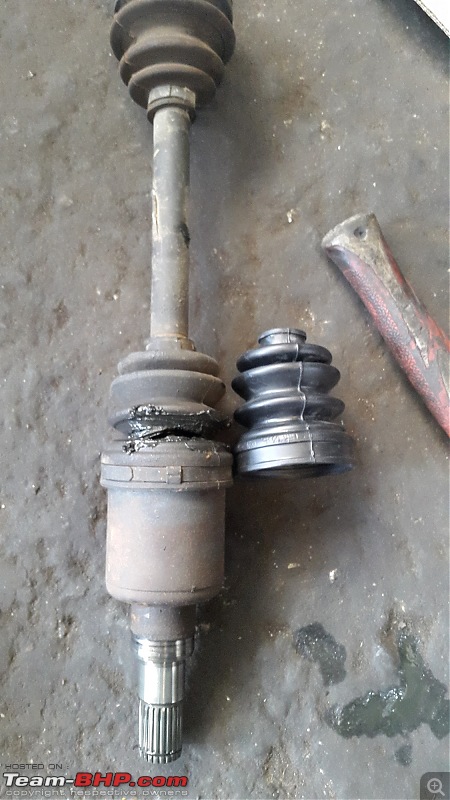

Yesterday I noticed some minor black grease splash on the lower part of the engine bay. Since I regularly monitor my car, I immediately noticed that the driveshaft axle boot has a fresh cut. Without any procrastination, I got it fixed today.
Pictures:
Wheels removed
The love of my life - A 2000 Maruti 800 DX 5-Speed. EDIT: Gets export model features on Pg 27-20170523_100939.jpg
The love of my life - A 2000 Maruti 800 DX 5-Speed. EDIT: Gets export model features on Pg 27-20170523_101448.jpg
Driveshaft removed
The love of my life - A 2000 Maruti 800 DX 5-Speed. EDIT: Gets export model features on Pg 27-20170523_111319.jpg
17 year old axle boot vs new
The love of my life - A 2000 Maruti 800 DX 5-Speed. EDIT: Gets export model features on Pg 27-20170523_111945.jpg
Part Number
The love of my life - A 2000 Maruti 800 DX 5-Speed. EDIT: Gets export model features on Pg 27-20170523_112004.jpg
CV joint was inspected and declared healthy. Luckily no sand particles managed to get into the grease when it was torn
The love of my life - A 2000 Maruti 800 DX 5-Speed. EDIT: Gets export model features on Pg 27-20170523_112352.jpg
Gearoil, it looks black because of MoS2 additive.
The love of my life - A 2000 Maruti 800 DX 5-Speed. EDIT: Gets export model features on Pg 27-20170523_115140.jpg
Fresh shiny new boot
The love of my life - A 2000 Maruti 800 DX 5-Speed. EDIT: Gets export model features on Pg 27-20170523_124236.jpg
Work done was in an hour, total cost including labour=Rs. 413/-
